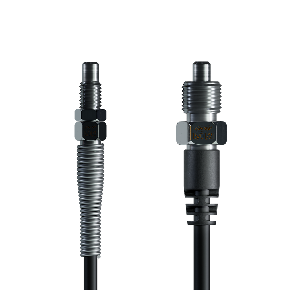

The Aim PT100 thermoresistor (thermister) temperature sensor is suitable for reading water and oil temperatures.

The thermoresistor must be put in the cooling system/oil sump; it is recommended to install the sensor away from heat and electromagnetic interference sources such as RPM or lap receiver cables. The sensor is fully compatible with Aim loggers and dash displays.
Temperature Sensor Connections
The temperature sensor ends with a 4-pin male 719 Binder connector that features a 2kΩ 1% resistor between pins 1 and 4. To extend the length between your dash display/logger and the analogue sensor, please use the 719 - 719 patch lead, which is available in various lengths.
EVO4 / EVO4S logger / Channel Expansion are fitted with 712 connections and requires a 712 - 719 patch lead to connect these sensors.
Please Note: For most installations, you will need one of these leads.
  • Temperature Working Range: 0-150°C
  • Cable Sensor Length: 25cm

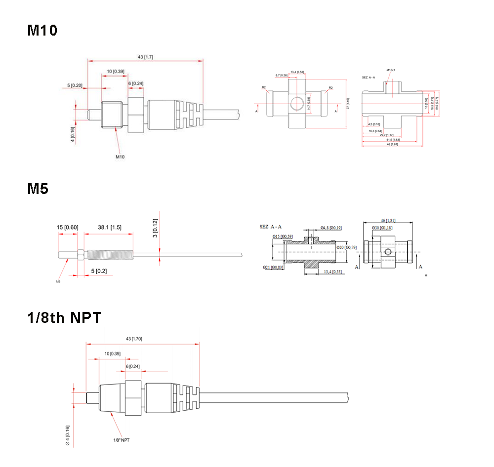

  • 1/8th NPT/M5/M10 Thermoresistor
  • Connection: 4-pin male 719 Binder
  • 2kΩ 1% resistor between pins 1 and 4
SKU: S-T-M10
1/8th NPT Temp Sensor Tech Sheet
M5 Temp Sensor Tech Sheet
M10 Temp Sensor Tech Sheet
