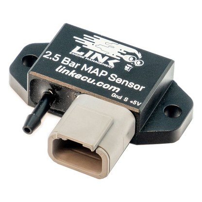

The Link 2.5 bar MAP sensor measures absolute pressures up to 2.5 bar, making it suitable for turbocharged or supercharged applications running up to 1.5 bar (22 PSI) of boost. The sensor’s wiring pinout is clearly marked directly on the unit for easy installation.
Why Choose the Link 2.5 Bar MAP Sensor

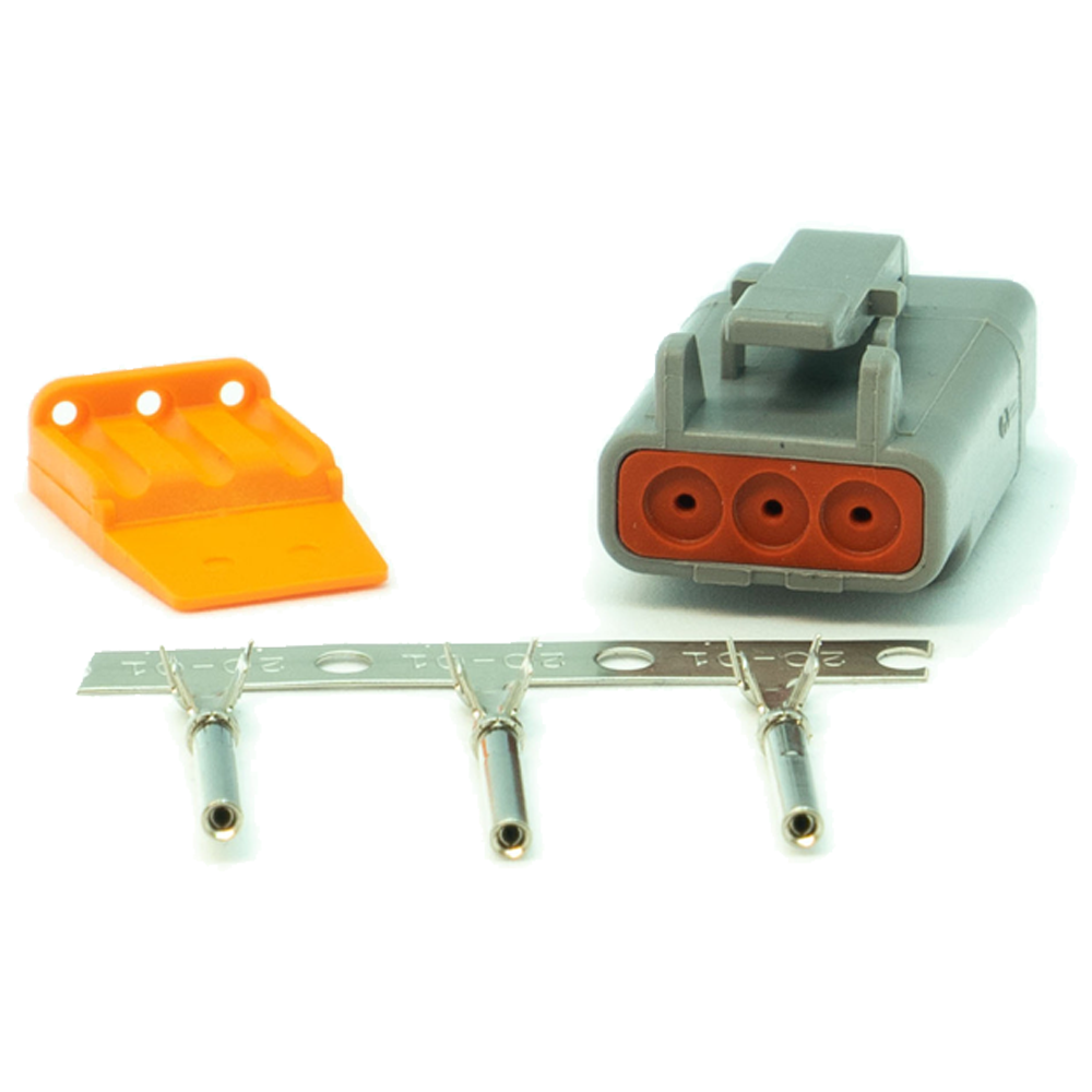

The Link 2.5 bar MAP sensor comes supplied with a 3-pin Deutsch DTM connector kit and features a compact aluminium enclosure. The sensor can be mounted via 2 bolt holes and should be positioned higher than the intake manifold port to which the hose connects.
Mechanical connection is made via a 4mm (3/16″) hose nipple. When using Link G4, G4+, or G4X ECUs, select ‘Link 2.5 Bar’ as the MAP sensor type in PC Link for proper calibration.
