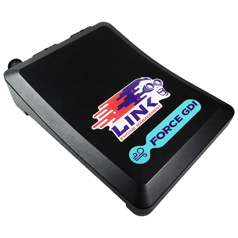

    The Force GDI is our first ECU built specially to control Gasoline Direct Injection engines.
    As well as full GDI control, the Force GDI offers on-board digital wideband, E-throttle control, high voltage injector and high-pressure fuel pump management, plus all the other features you have come to expect from one of Link’s world-leading ECUs.
    The Force GDI can control up to 4 cylinders with direct injection.

    Inputs
    8/10* x Digital inputs
    4 x Temperature inputs
    11 x Analog inputs
    2 x Trigger inputs
    2 x Knock inputs
    1 x LSU 4.9 Wideband lambda sensor input
    *2 inputs required when using 2nd CAN Bus
    Outputs
    4 x High voltage injector drivers (60V 10/5A Peak/Hold Current)
    1 x GDI pump/Spill valve driver (11.8/6A Peak/Hold)
    4 x Ignition drivers
    10 x Auxiliary outputs^
    +5V Sensor power supply
    +8V Sensor power supply
    ^unused ignition drives can be used as additional Aux outputs
    Communications
    2* x CAN bus
    1 x Serial (RS232) connection
    1 x USB tuning connection
    Physical
    Dimensions: 185mm(L) x 130mm(W) x 40mm(H) (without looms)
    Mass: 680grams
    Advanced features found only on the Force GDI:
    4 high voltage Boost/Peak/Hold GDI injector drives, user-definable voltage, current and durations.
    1 Spill valve/GDI pump driver, peak & hold or saturated mode. User-definable current.
