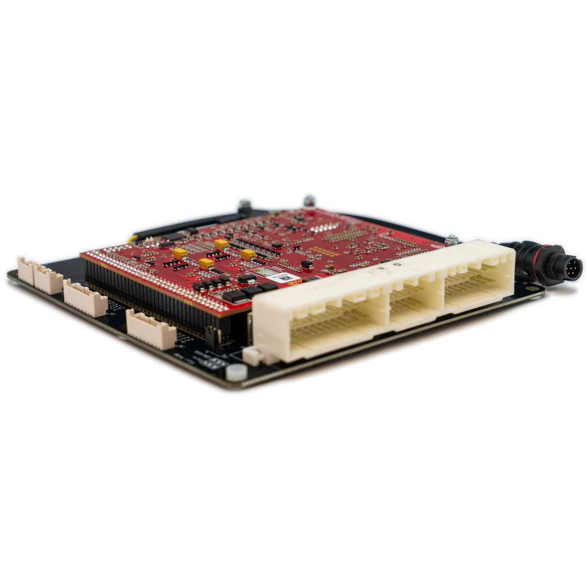

    G4X PlugIn ECUs offer the latest in engine management technology, designed to easily maximize the potential from your car.
    Designed for the Pre-Facelift MX5 NB (MY1998-2000, 3 Plug ECU, non-VVT 1.8L Engine)
    • Please check your connector matches the header in the listed photo before purchasing.
    • This ECU works for manual transmissions only.
    • Includes onboard 7 bar MAP sensor
    • Most factory features are supported
    • Check the features tab for I/O expansion options
    Note: This Plug-in features a new 4 pin powered CAN connector and cannot use the old CANPCB cable for CAN connection. Use the CANJST4 (Link PN 101-0198) cable for connecting CAN devices. This new 4 pin port and cable provide not only the CAN connection, but also a protected 12V power supply and ground for powering the CAN devices. The power supply is protected by a self-resetting fuse rated at 3A continuous.
    PlugIn Key Features:
    Precision closed loop cam control (four cam, independent control)
    Sequential fuel delivery
    OEM idle hardware supported
    Motorsport features - anti lag, launch, flat shift
    Continuous barometric correction (on board)
    CAN port
    QuickTune - automated fuel tuning
    USB tuning cable included
    Real time selectable dual fuel, ignition and boost maps
    512 mega bytes data logging memory
    Staged injection
