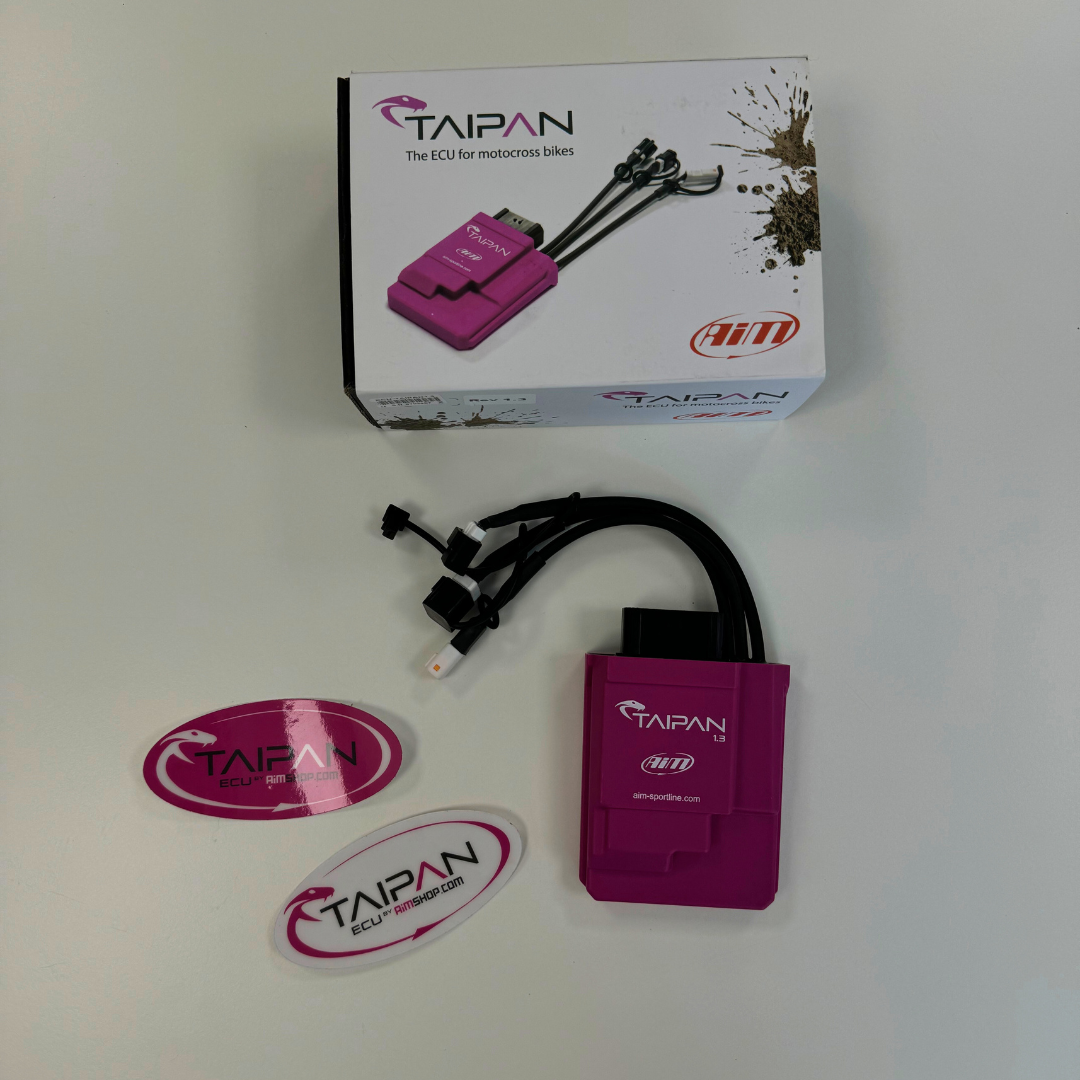

    This Taipan ECU comes back to us as a trade-in, fully equipped and ready to take on its second life. The ECU is in full working order and has been meticulously checked by our technicians.
    Aim Taipan ECU Plug & Play Engine Control Unit
    Taipan is the brand-new aftermarket plug & play ECU created by Aim, exclusively designed for off-road bikes. Thanks to its high technology 32-bit core, it represents an important step forward to improve the performance of your bike, without sacrificing reliability and smoothness.
    This specific Taipan ECU is unprogrammed. It can be configured for any brand or model bike you require. You will need the UC Bridge Tuner to enable this process.
    Once the unprogrammed Taipan ECU has been configured with a dedicated brand or model it can not be changed. You will be able to modify the maps written into the ECU but the brand or model which has been configured can not be changed.
    It provides the ultimate control in feeling, ignition, ignition phase, start maps, launch control, traction control with altitude and engine temperature corrections.

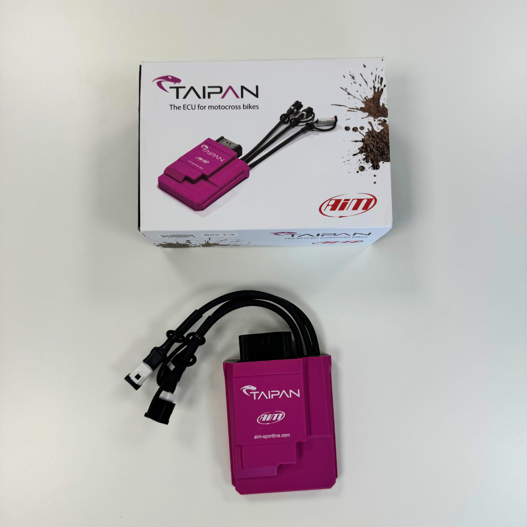

    • Two 0-5V analogue inputs sampled @ 1,000 Hz each, could be alternatively used as a switch to ground
    • One low side driver (1 A)
    • Two CAN Bus, one for calibration purposes, one for expansions - (AiM handlebar switch, dataloggers, dash etc
    • Three JST JWPF waterproof auxiliary connector
    • Power consumption 150 mA
    • Connectors: n. 1 JST 04T-JWPF-VSLE-S Connector
    • n. 1 JST 08R-JWPF-VSLE-D Connector
    • n. 1 JST 04R-JWPF-VSLE-S Connector
    • n. 1 33 pin male Connector
    • Body: PA6 + 30% glass fiber
    • Waterproof: IP67
    • Weight: 260g
