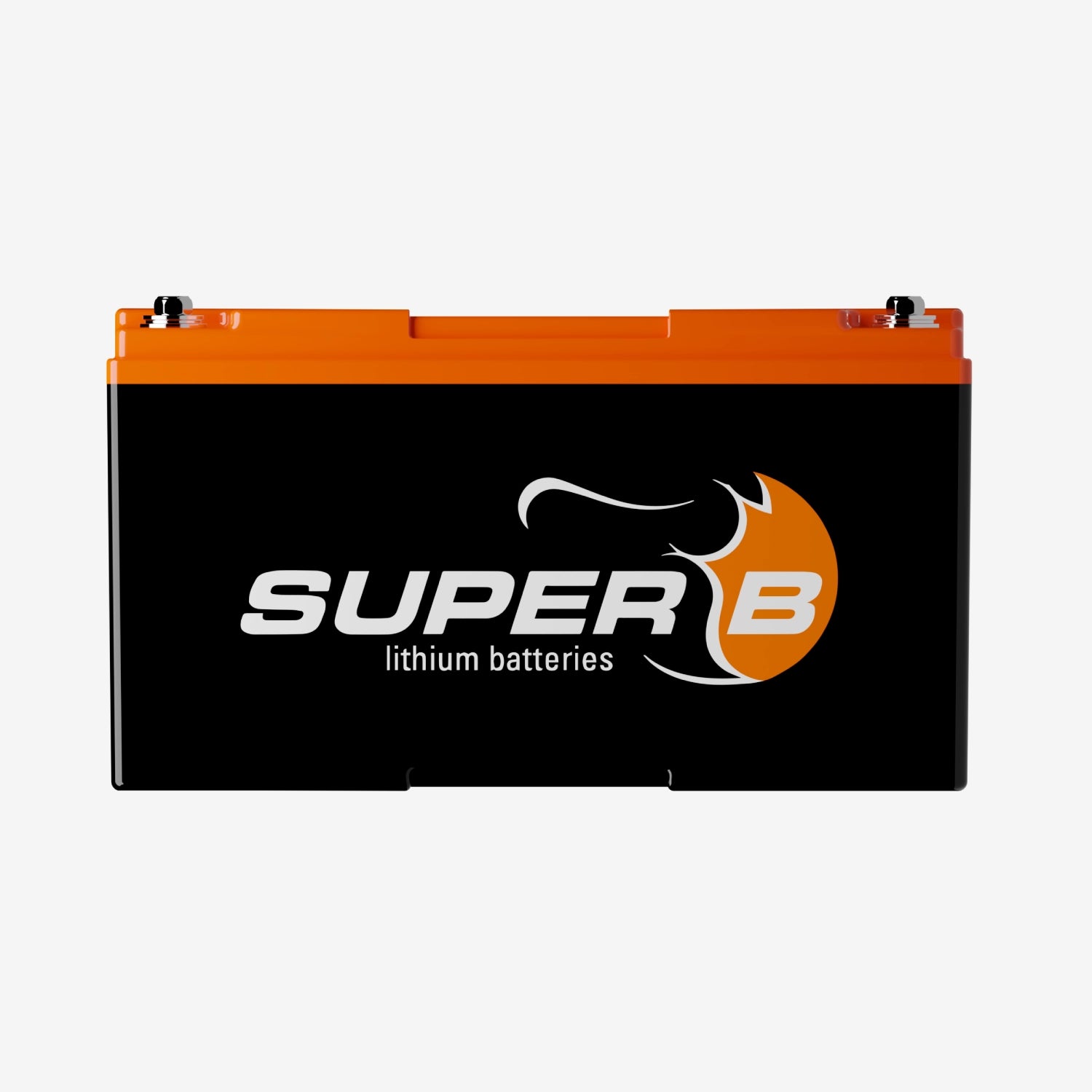

    The Super B Andrena 12V20Ah-SC Lithium Battery is a slightly larger and heavier version of the Andrena 12V20Ah, providing the same battery performance and power in a slightly larger form
    superb lithium batteries
    What Is The Super B Andrena 12V20Ah-SC Lithium Battery?
    The Super B Andrena 12V20Ah-SC Lithium Battery is a high-performance lithium iron phosphate (LiFePO4) battery that has been specially developed for motorsports. It’s a reliable and lightweight alternative to traditional lead-acid batteries.

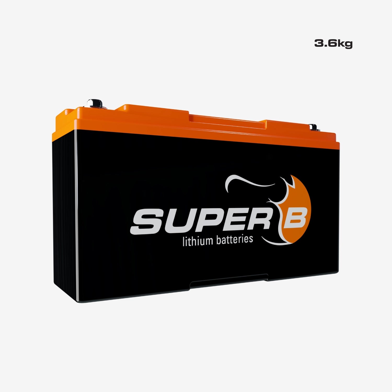

    Lightweight Design
    With a weight of 3.6 kg (8.0 lbs), the Andrena 12V20Ah-SC Battery saves up to 80% in weight compared to traditional lead-acid batteries. The Andrena is also only ⅓ of the size of conventional batteries. This compact, lightweight design not only improves the performance of your vehicle, but also helps to increase the fuel economy.

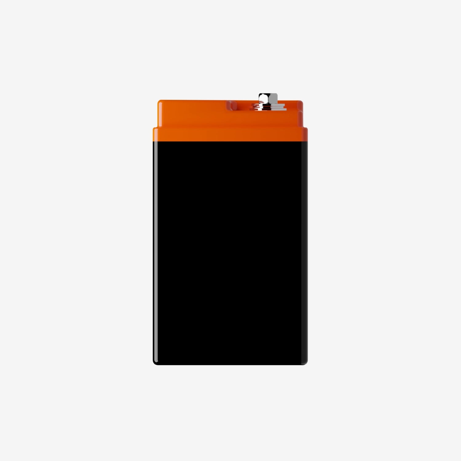

    MECHANICAL SPECIFICATIONS
    Dimensions (LxWxH)
    249 x 96 x 141mm | 9.80” x 3.78” x 5.55”
    Weight
    3.6 kg / 8.0lbs
