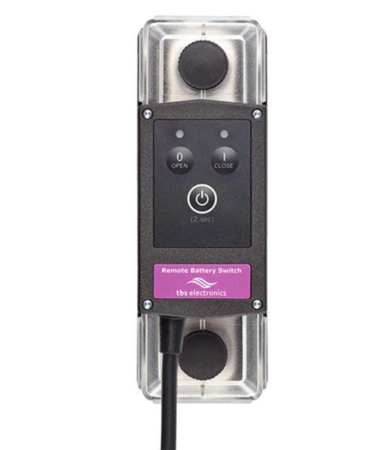

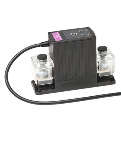

The Super B Relay TBS Remote Battery Switch (RBS) is a smart, high-current magnetic latching contactor that can handle continuous DC currents of up to 500Amps. The TBS RBS can be controlled by the Battery Communication Interface (BCI) and is suitable for the Nomada and Nomia lithium batteries. The TBS Remote Battery Switch is available in a 12V500A, 24V500A and 48V350A variant.
