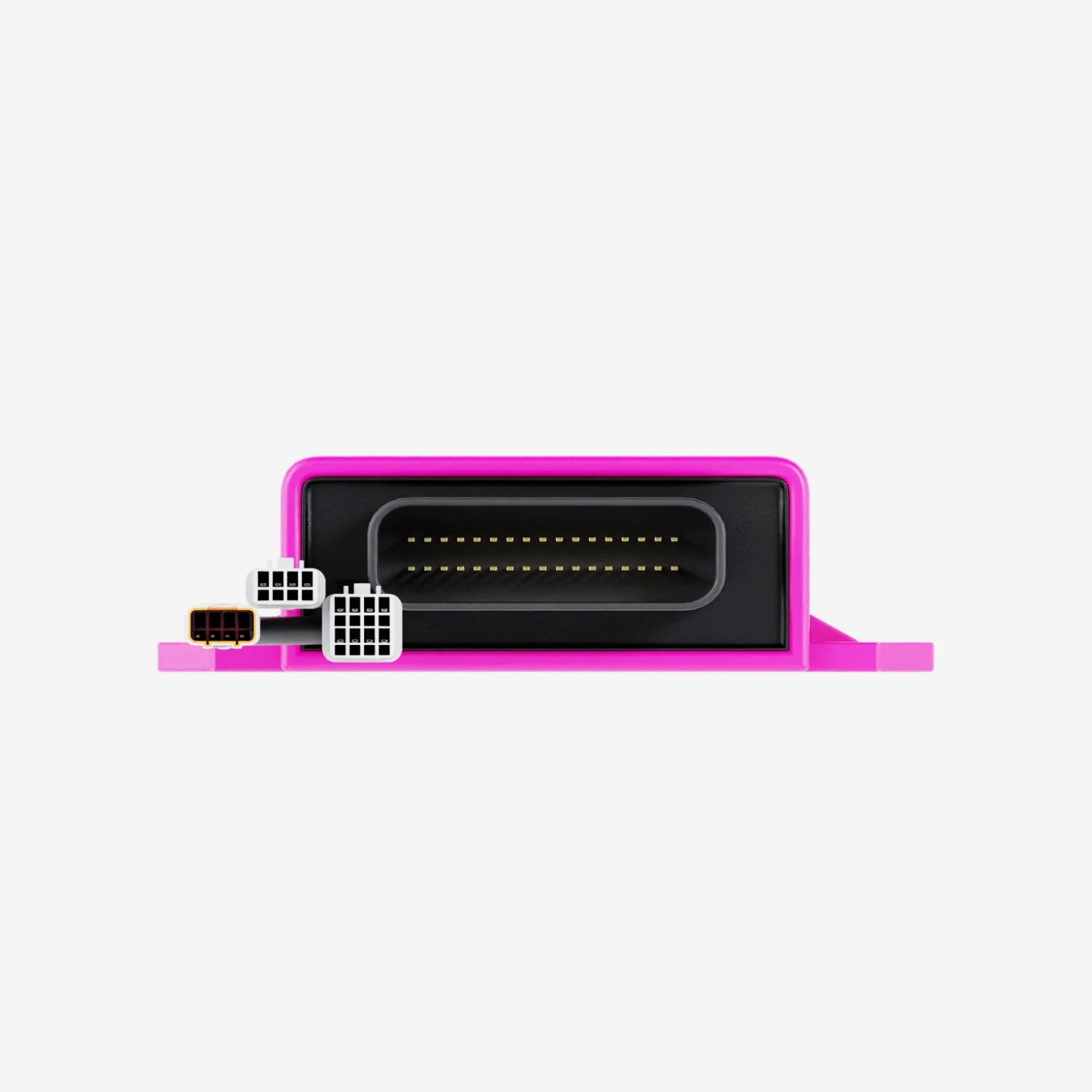

Taipan Y ECU Connections

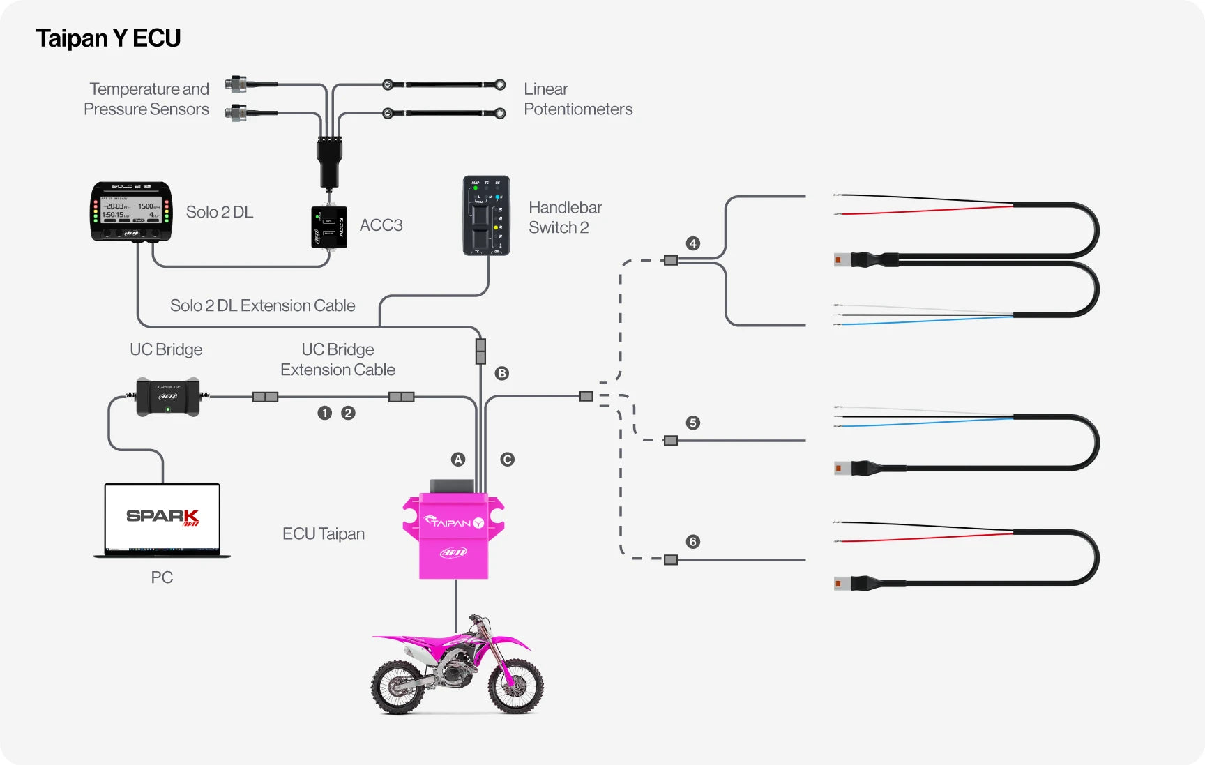

The Taipan Y ECU has 4 connectors:
  • Main Connector: Compatible with most off-road bikes.
  • CAN Connector: Connects to the Handlebar Switch 2 and data logger.
  • 2nd CAN Connector: Connects to the UC Bridge to communicate with the PC.
  • 3rd Connector: Connects to spare analogue inputs and a possible second injector.

The Taipan Y ECU Expansion list; Solo 2 DL, SmartyCam 3, Handlebar Switch 2, UC-Bridge and more
The Taipan ECU works seamlessly with Aim’s ecosystem of devices.
  • CAN-BT Module: The CAN-BT Module grants instant access to key engine data from your Taipan ECU. Install the SPARK App on your smartphone for a streamlined, data-driven interface for real-time monitoring of live engine parameters.
  • Handlebar Switch 2: HBS2 is the compact, high-performance, and durable Handlebar Switch. If you're looking for a highly flexible and ergonomic switch, the model from Aim offers a great solution with 4 push buttons and 11 integrated LEDs.
  • UC-Bridge: The UC Bridge serves as the essential interface connection between the CAN bus of the ECU and the USB port of your PC.
  • Data Hub: Split EXP ports to connect multiple expansions such as the Solo 2 lap timer, UC Bridge, Handlebar Switch or additional converters.
  • Two 0-5V analogue inputs sampled at 1,000Hz each - could be alternatively used as a switch to ground
  • One low-side driver (1A)
  • Two CAN bus - one for calibration purposes, one for expansions (Aim Handlebar Switches, data loggers, dashes etc)
  • Three JST JWPF waterproof auxiliary connectors
