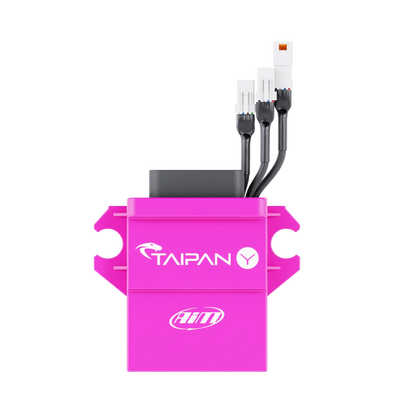

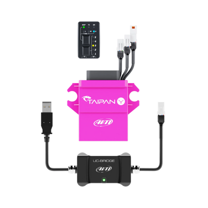

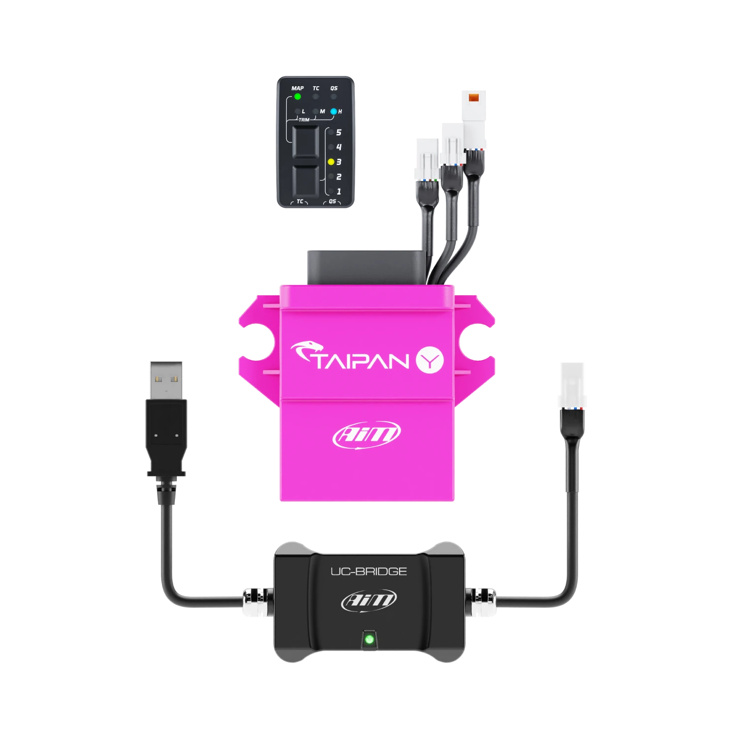

    AiM Taipan Y ECU Plug & Play Kit For Yamaha Motocross Bikes
    Taipan Y is the brand-new aftermarket plug & play ECU created by AiM, exclusively designed for off-road bikes. Thanks to its high technology 32-bit core, it represents an important step forward to improve the performance of your bike, without sacrificing reliability and smoothness.
    It provides the ultimate control in feeling, ignition, ignition phase, start maps, launch control, traction control with altitude and engine temperature corrections.

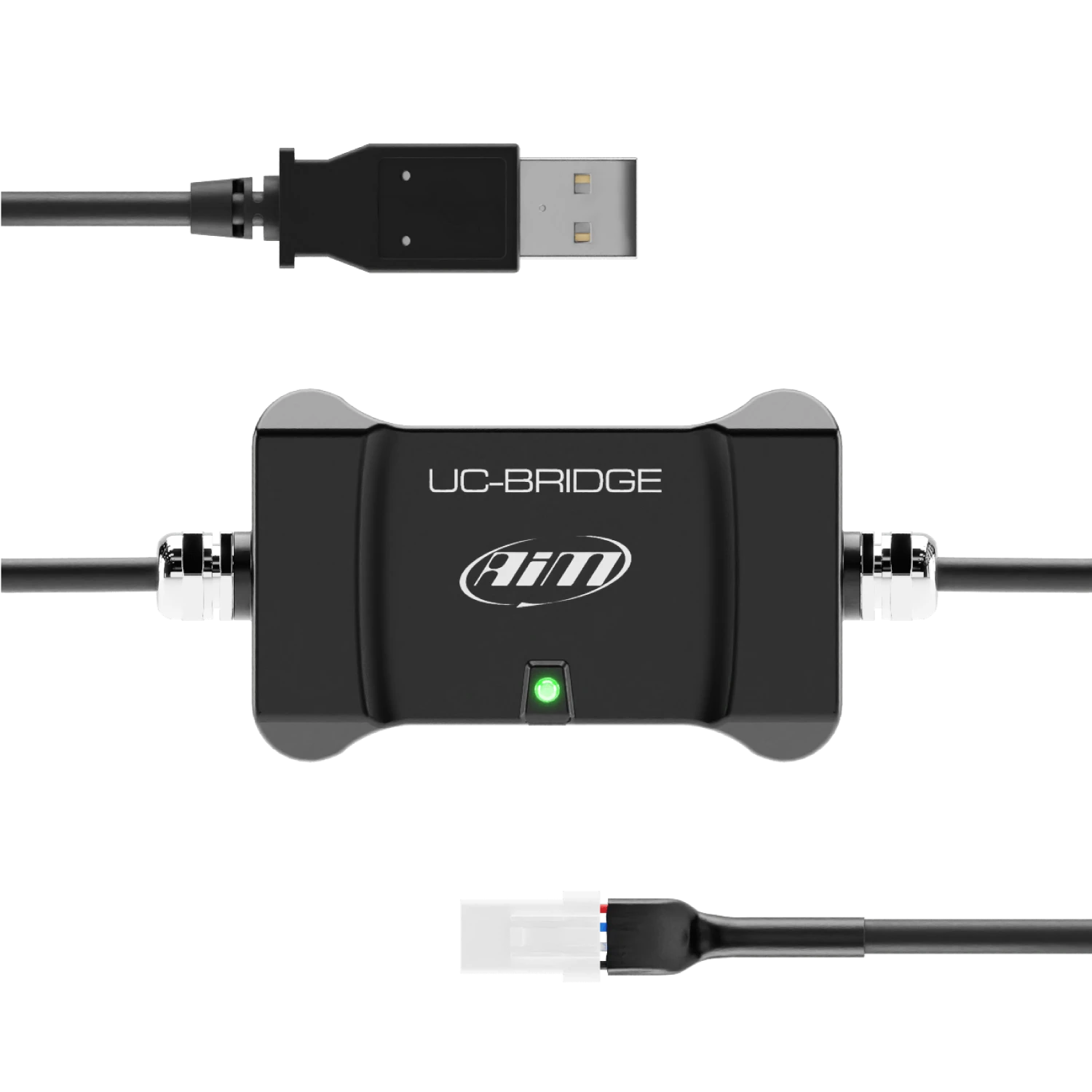

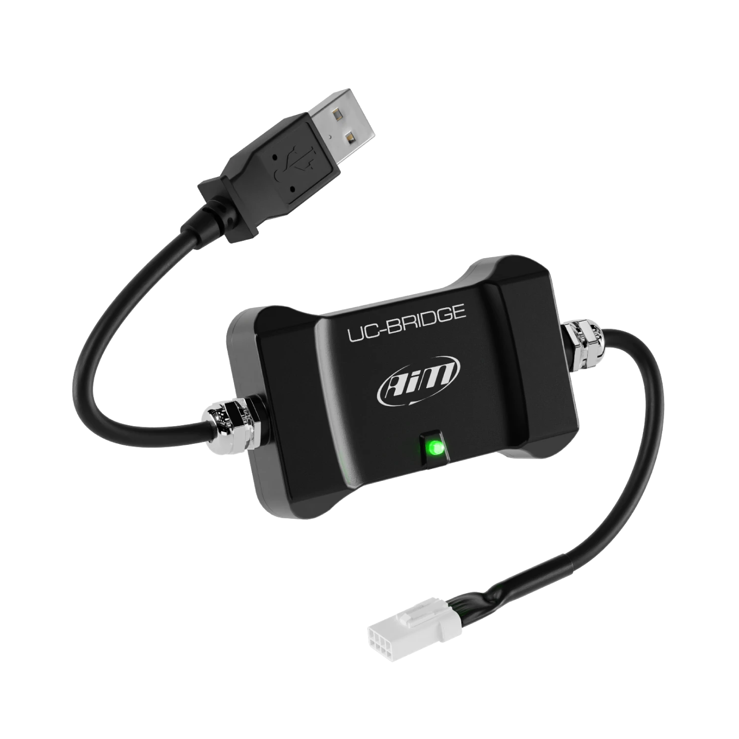

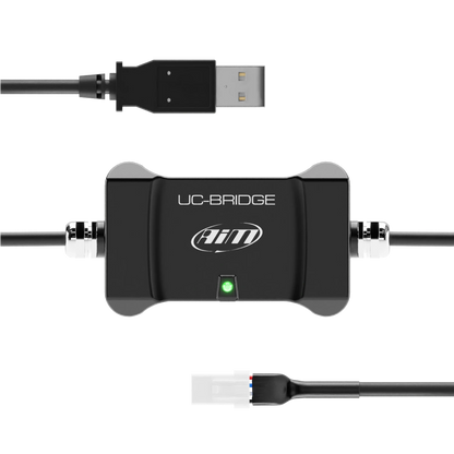

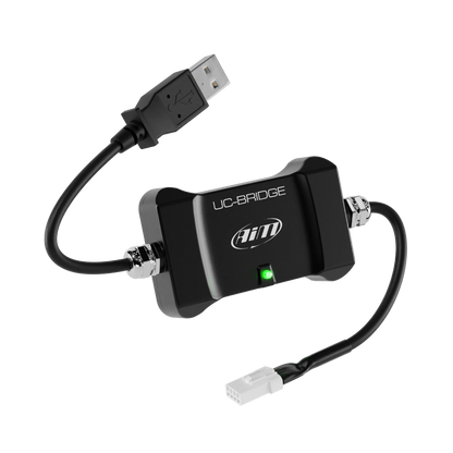

    UC Bridge
    The UC Bridge is the connection between the CAN bus of the ECCU and the USB port of your PC. It is available in 2 different licenses :
    User License : A Taipan Y ECU comes with some basic maps that already give you better performance than the stock maps. Highly professional tuners all over the world offer specific maps that better fit your requirements, managing, for example, different exhaust, two injectors etc.
    The UC Bridge is required for two functions :
    - Transfer new and different maps to your ECU through the User License UC Bridge.
    - Receiving diagnostic information from the Taipan Y ECU.

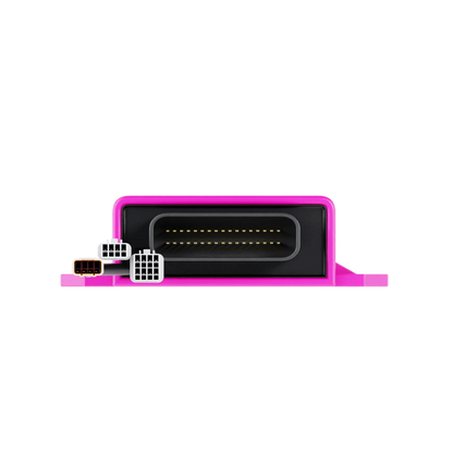

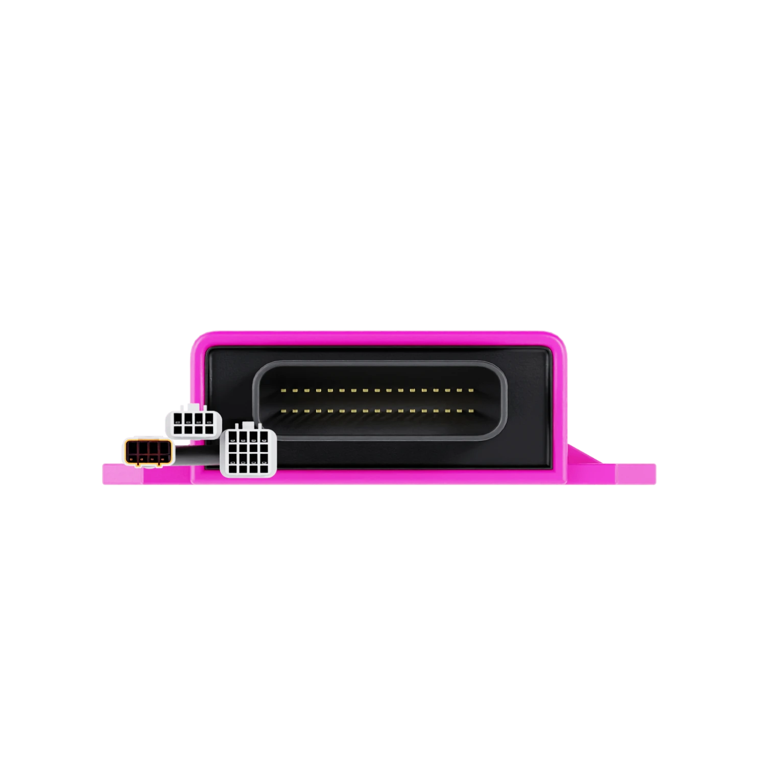

    Taipan Y ECU Connections
    The Taipan Y ECU has 4 connectors :
    2nd CAN Connector - Connect to the UC Bridge, in order to communicate with the PC.
    3rd Connector - Connect to spare analogue inputs and to a possible second injector.

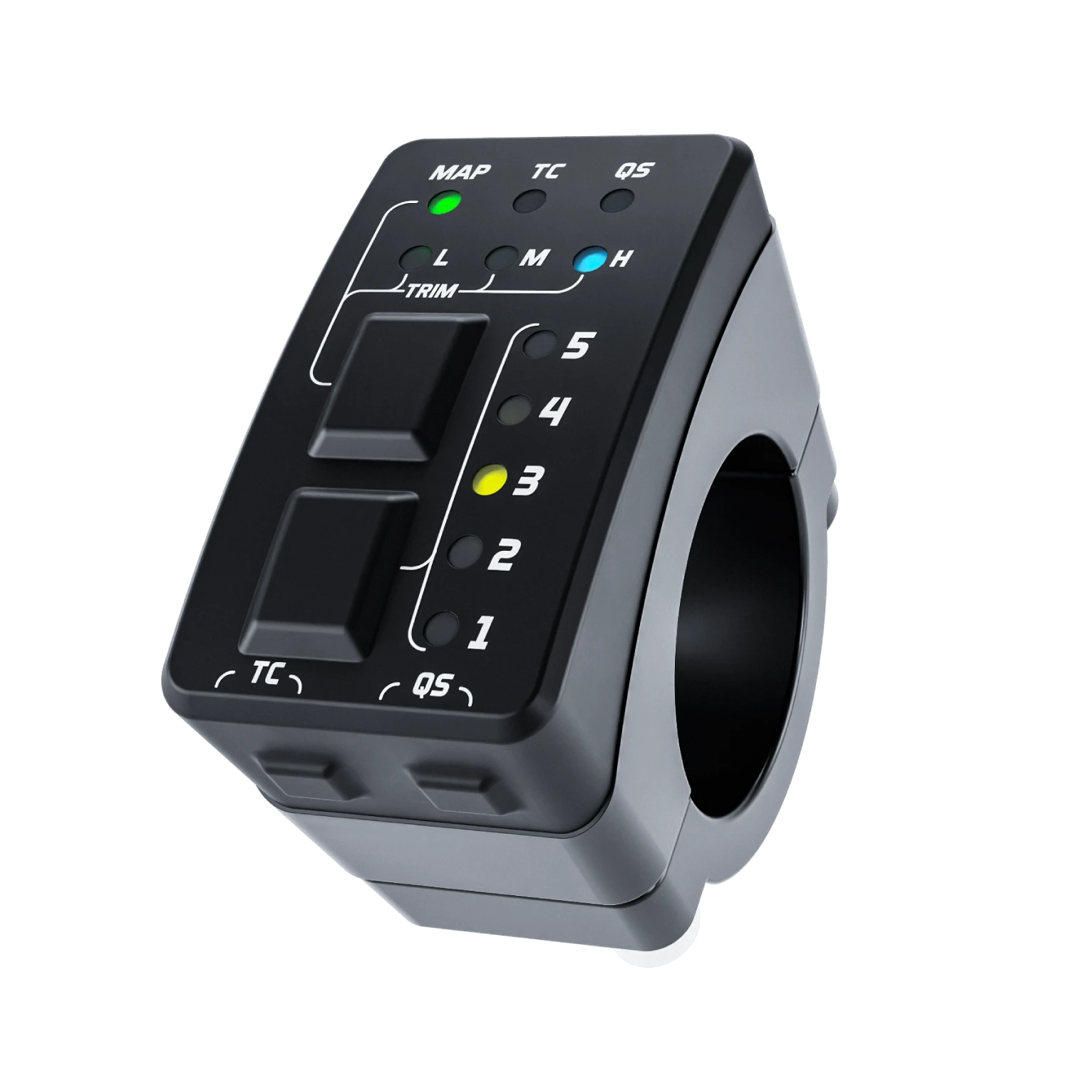

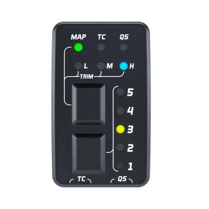

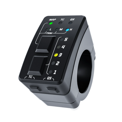

    Aim Handlebar Switch
    The Aim Handlebar Switch is the best way for changing the behaviour of your bike; it features 2 pushbuttons, 10 LEDs and manages the following settings :
    Below shows a functional diagram of products that can be added to the Taipan Y ECU:

    AiM Taipan Y ECU Plug & Play Kit for Yamaha
    • Plug & Play ECU for Yamaha
    • UC Bridge
    • Handlebar Switch
