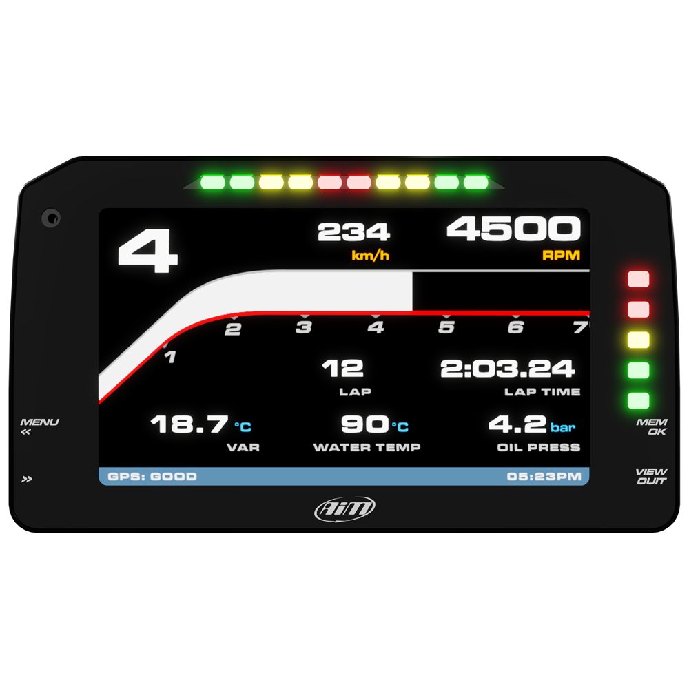

The dash has a 6" TFT high contrast colour display. The visual quality is optimised by the ambient light sensor, which keeps the backlight at the best brightness levels.
Race icons allow you to apply conditions to the LED icons, such as fuel, engine, oil, lights and more.
Pre-Configured Pages
The Aim PDM 6" Display can show the RPM scale and all the data you need, like speed, water temperature and oil pressure, lap times and much more. You can customise pages to suit your requirements, including up to four additional fields. Define what data is shown with the end of scale and measure units. Swapping between the pages is easy; just use the push buttons.
