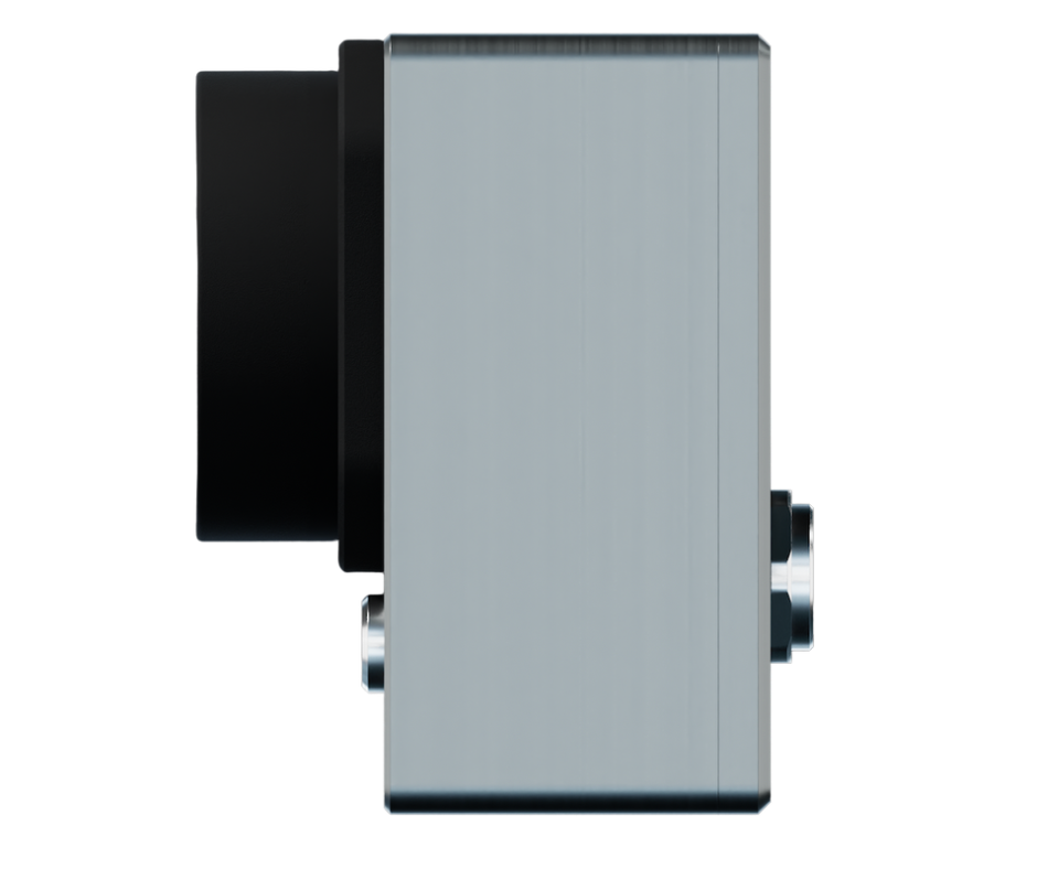

Why Choose the Aim SmartyCam 3 Corsa
The SmartyCam 3 Corsa allows you to automatically start and stop recording via an inbuilt 3-axis accelerometer, so you can focus on driving. It has a global shutter CMOS sensor that eliminates the “wave effect” from engine vibrations, while the rugged, machined aluminium housing withstands extreme track conditions and is IP65 sealed.

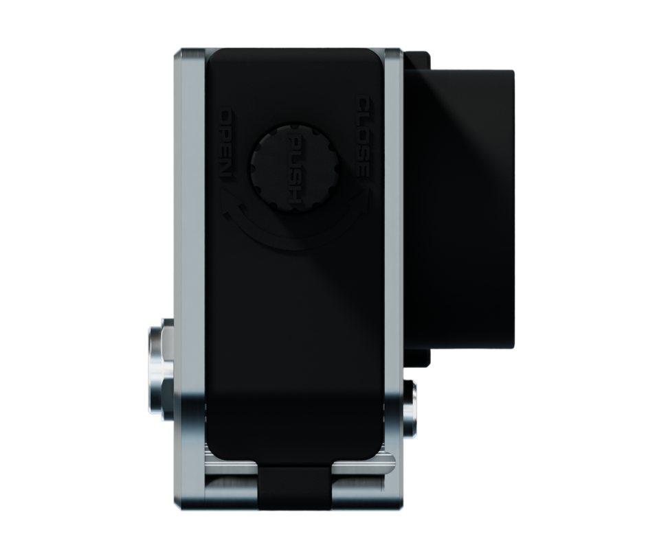

The SD card housing on the Aim SmartyCam 3 Corsa is 100% protected from air and weathering.

  • CMOS Sensor: Global shutter
  • Field Of View: 67° or 84°

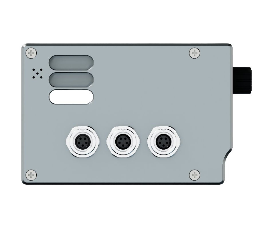

  • External Power: 9-15V

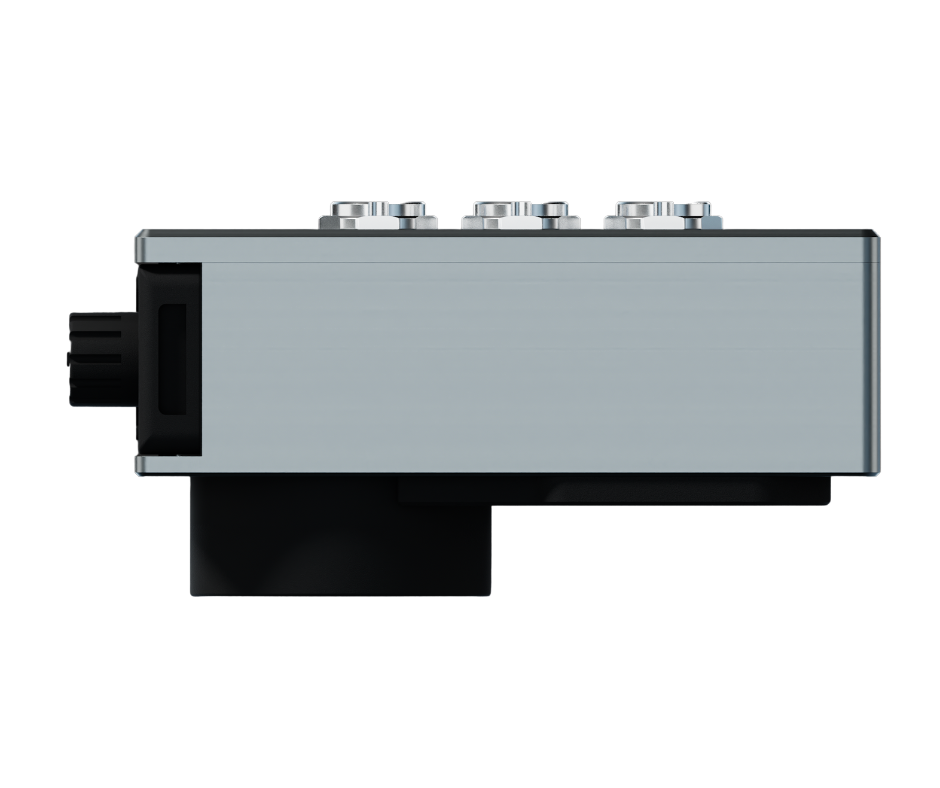

  • Connectors: 1 7-pin binder 712 female, 2 5-pin binder 712 female & 1 USB-C
  • Auto Power ON/OFF: Yes
  • Dimensions: 102.2 x 63 x 46.5mm
  • Weight: 280g, battery included
