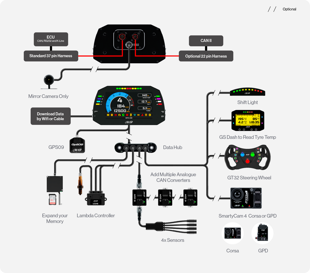

The MXG digital dash is designed to collect and display data from the ECU, the internal accelerometer & gyro, the included GPS09 Module, analogue & digital inputs, and predefined math channels. You can also expand its capabilities by adding up to 8 modules to enhance performance and data acquisition.
Connecting the MXG 1.3 dash to your car’s ECU is simple. You can sample dozens of channels straight from the car's ECU (compatible with over 1,000 different ECUs), requiring only a cable connection to the ECU instead of multiple connections and analogue sensors.

Two analogue camera inputs are available to switch your display into a mirror camera, activated by a push button or event. The camera is sold separately.
GPS Options
The included GPS09 module connected via CAN to the MXG dash logger, simplifies lap time calculations and track position analysis. With 4,000+ worldwide tracks already stored with the start and finish line coordinates, you will have no problem when you're on the track.
As soon as the MXG is turned on, the GPS module will locate its position, identify track line coordinates and start immediately sampling lap and split time. If the track is not in the database, you can easily add the start/finish line coordinates to the MXG using our Race Studio 3 software.
Note: The GPS Module is available with cable lengths of 0.5m, 1.3m, 2m or 4m, or a roof version with 2m or 4m length cables.

MX Logger Series Expansions list; SmartyCam, ACC3, Data Hub, GPS, and more.
The LCU-One S allows you to perfectly tune the carburetion of your engine to keep it at its best and improve the engine's performance. Alongside the Analogue CAN Converter, you can choose among 5 different split harnesses. Up to 4 thermocouples or 4 analogue channels 0-5V/0-12V are available.
The SmartyCam camera series also connects to record synchronised video and telemetry ready for analysis in Race Studio 3.
