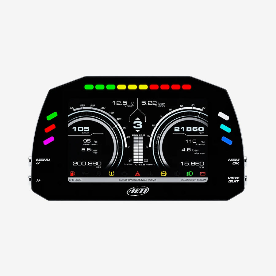

The MXG display logger also comes with 8 RGB LEDs, allowing you to customise colours, alarm types (solid or flashing), flashing frequency and accompanying text messages. Alarm priorities can be set to suit your specific requirements.
Load video: Pre-configured dash display screens for the MX Logger Series.
Configurable Pages
With a high contrast 7" TFT display, which is fully configurable, you can create and customise pages/displays to suit your requirements, choosing from a variety of styles, data types and measurement units. An ambient light sensor adjusts the backlight for optimal brightness, ensuring clear visibility in all lighting conditions.

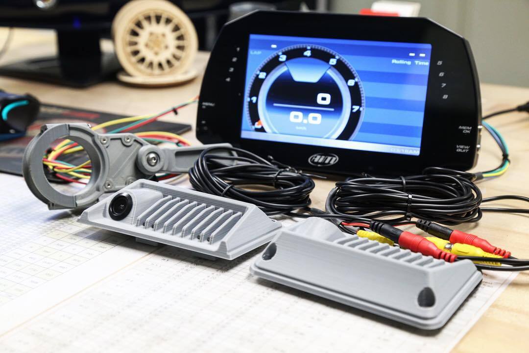

Two analogue camera inputs are available to switch your display into a mirror camera, activated by a push button or event. The camera is sold separately.

The SmartyCam camera series also connects to record synchronised video and telemetry ready for analysis in Race Studio 3.
