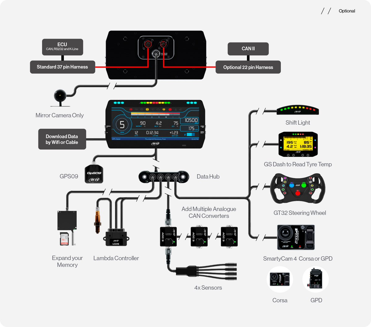

The MXT digital dash is designed to collect and display data from the ECU, the internal accelerometer & gyro, the included GPS09 Module, analogue & digital inputs, and predefined math channels. You can also expand its capabilities by adding up to 8 modules to enhance performance and data acquisition.
Connecting the MXT 1.3 dash to the ECU is simple. You can sample dozens of channels straight from the car's ECU, (compatible with over 1,000 different ECUs) requiring only a cable connection to the ECU instead of multiple connections and analogue sensors.

MX Logger Series Expansions list; SmartyCam, ACC3, Data Hub, GPS, and more.
The LCU-One S allows you to perfectly tune the carburetion of your engine to keep it at its best and improve the engine's performance. Alongside the Analogue CAN Converter, you can choose among 5 different split harnesses. Up to 4 thermocouples or 4 analogue channels 0-5V/0-12V are available.
The SmartyCam camera series also connects to record synchronised video and telemetry ready for analysis in Race Studio 3.
