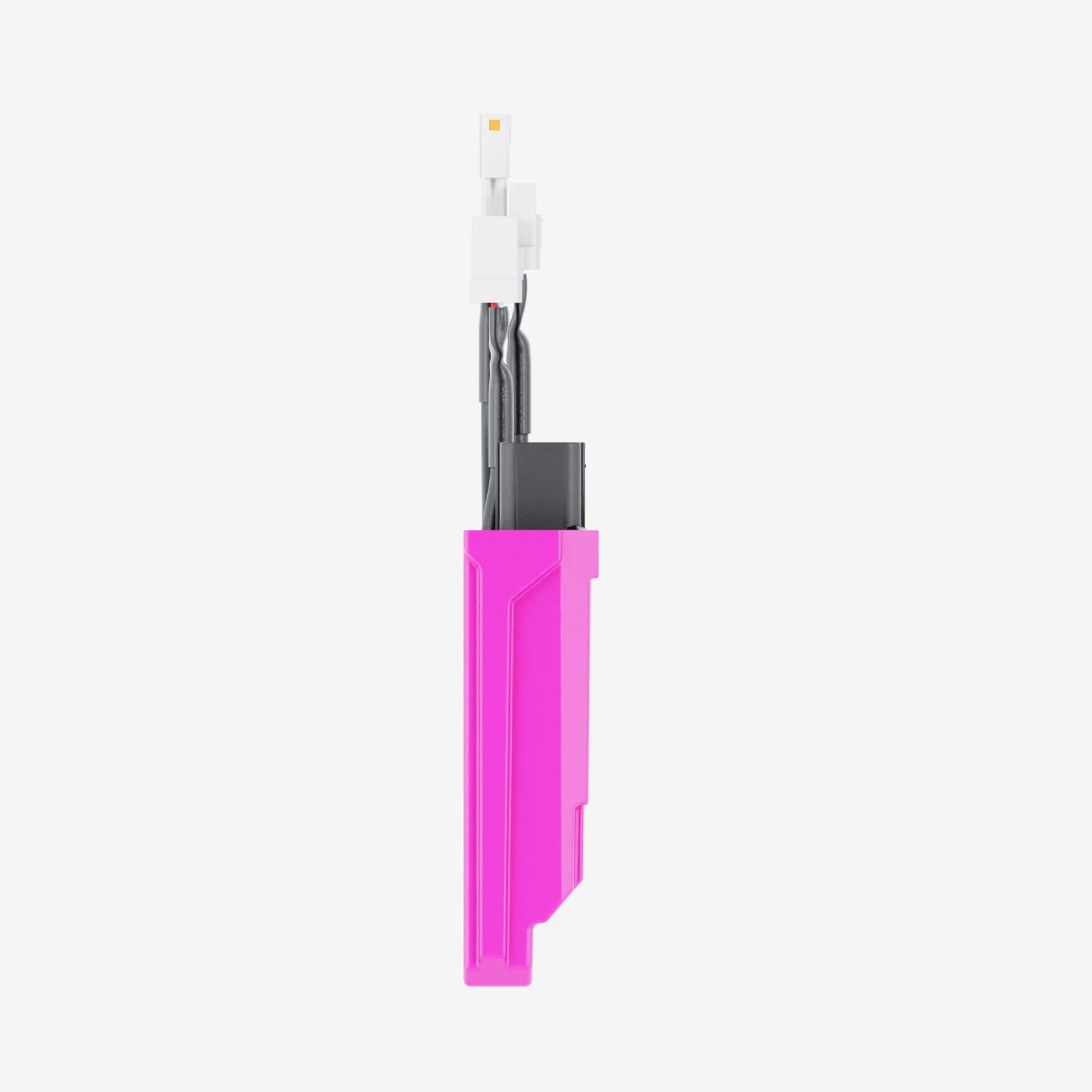

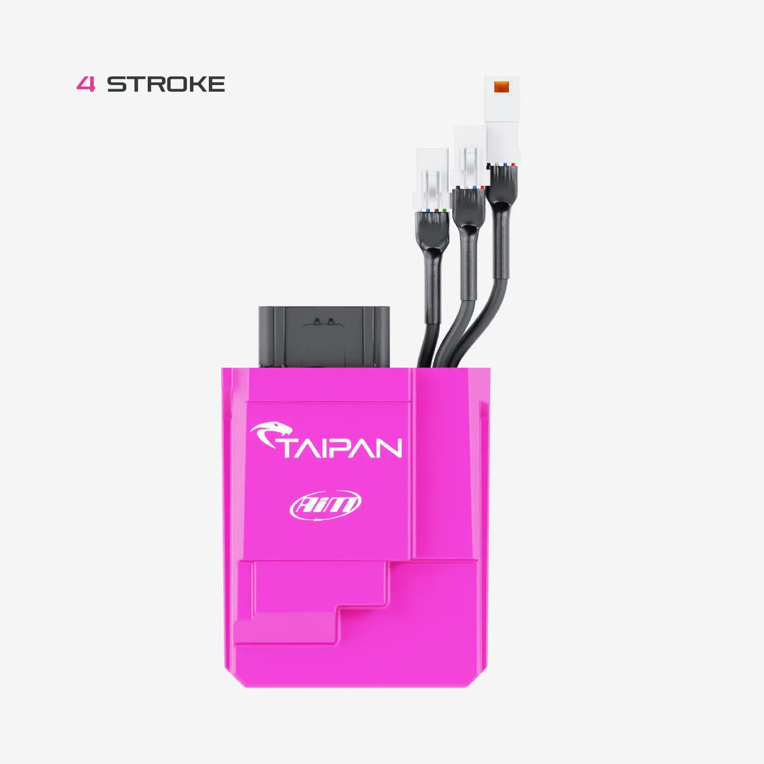

Aim Taipan Motocross Engine Control Unit

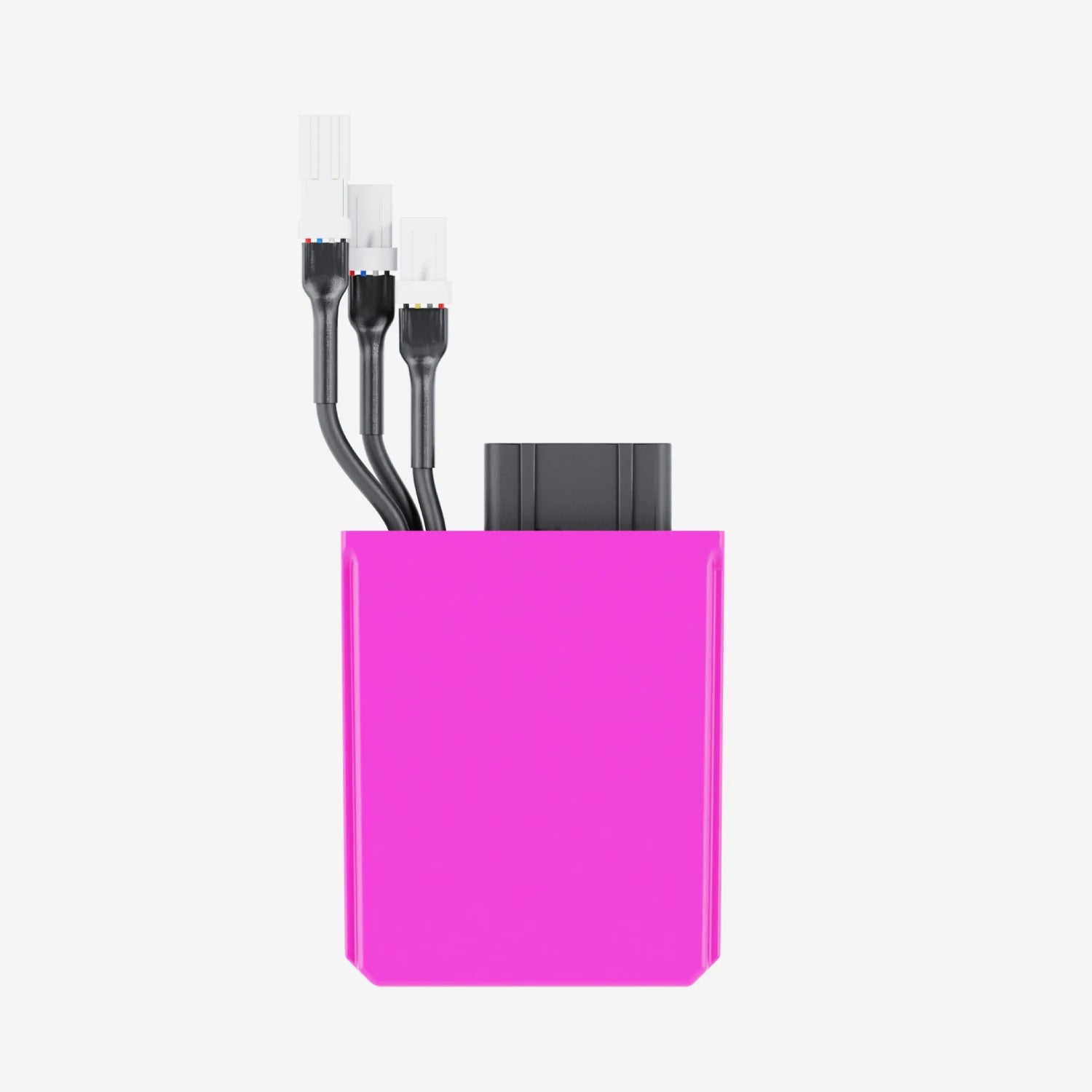

Motocross bike manufactures that Taipan ECU is compatible with: KTM, GASGAS, Husqvarna, Kawasaki, Honda & Ducati
The Taipan Engine Control Unit (ECU) is our aftermarket plug & play ECU exclusively designed for off-road motocross bikes: GASGAS, KTM, Honda, Kawasaki, Ducati and Husqvarna. Thanks to its high-technology 32-bit core, it represents an important step forward to improve the performance of your motorcycle, without sacrificing reliability and smoothness.
Why Choose the Taipan ECU
Engine control requires precision. With its high technology 32-bit core, at 20,000 RPM, the Taipan ECU guarantees precision of 1/10 of a degree: this means an accuracy within 0.8 microseconds (µs) for turning the spark ON.
This precision is the key to guarantee:
  • A very consistent engine rotation.
  • The possibility of repeating dozens of tests at the bench, always obtaining the same result.
  • A perfect reactivity at every minimum change of any point of a map, resulting in more power at the wheel.

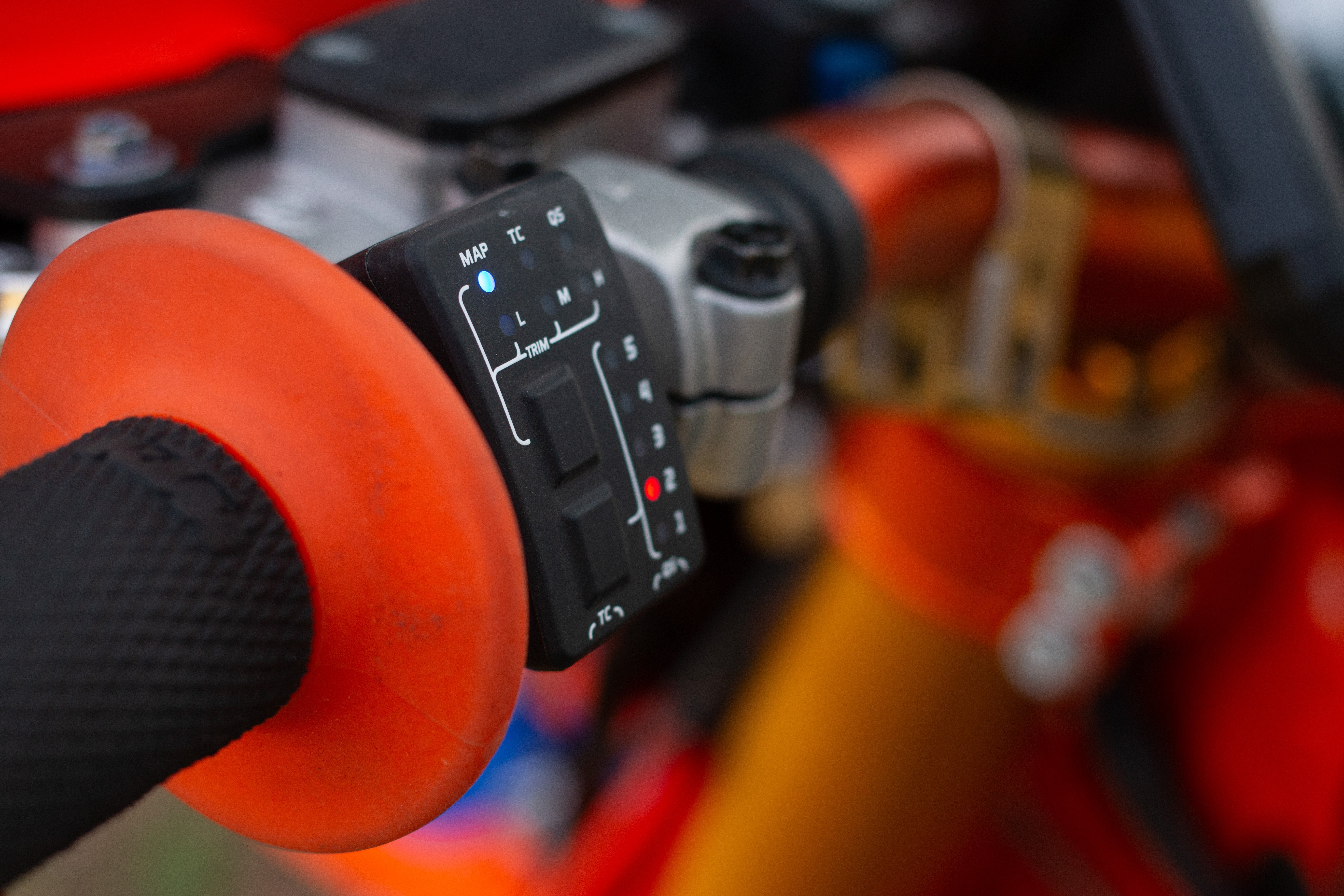

Handlebar Switch 2
You can choose from up to five selectable maps with the Handlebar Switch 2.
The Taipan can manage up to five maps that can be selected both by OEM switches (Honda, Husqvarna, KTM) or even more easily by the Aim Handlebar Switch 2.
HBS2 is the compact, high-performance, and durable Handlebar Switch.
If you're looking for a highly flexible and ergonomic switch, the model from Aim offers a great solution with 4 push buttons and 11 integrated LEDs.
  • Map Management
  • Fuel Trim
  • Traction Control Management
  • Launch Control Management
  • Buttons Setting Memorisation
HBS2 also allows the management of quick shifting on factory-equipped bikes.

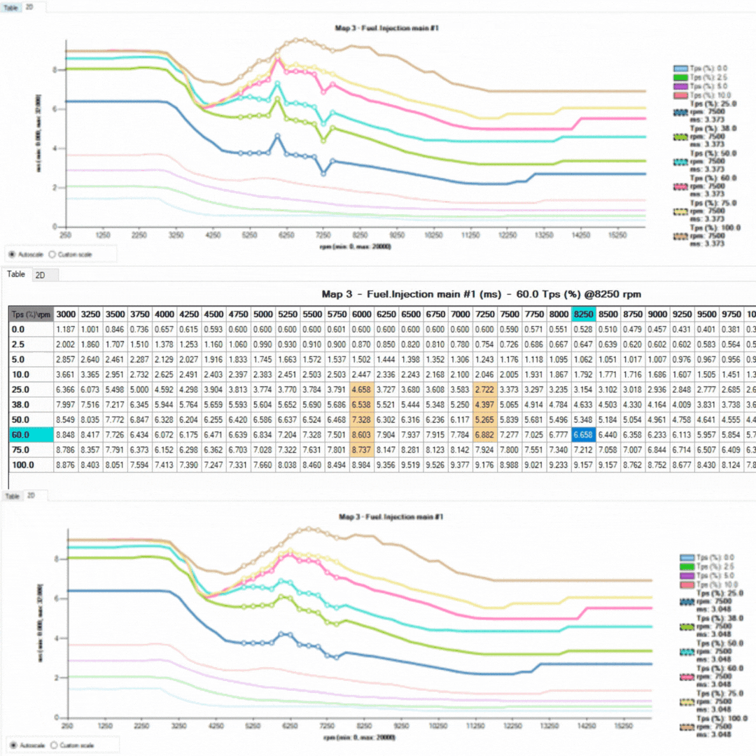

Smoothing algorithm feature on Spark Software
Smoothing Algorithm
By selecting at least three contiguous cells and right-clicking, a context menu appears. Choosing ‘Smoothing’ from the menu applies the smoothing algorithm, which is also reflected in the 2D view.

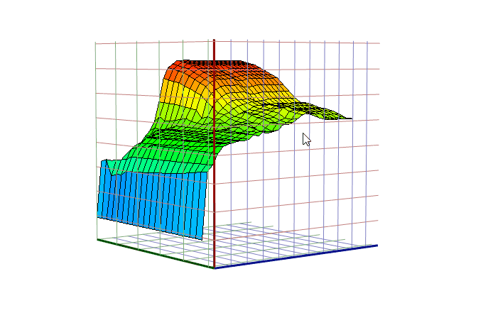

3D visualisation on Spark Software
3D Visualisation
3D visualisation mode complements the 2D view. The 3D graph supports rotation, zooming, and panning, with controls detailed in the tab’s legend.

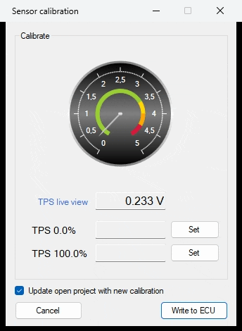

Tyre pressure sensor calibration gauge on Spark Software
TPS Sensor Calibration Gauge
TPS Sensor Calibration Gauge provide a clearer and more intuitive visualisation of the TPS signal voltage.

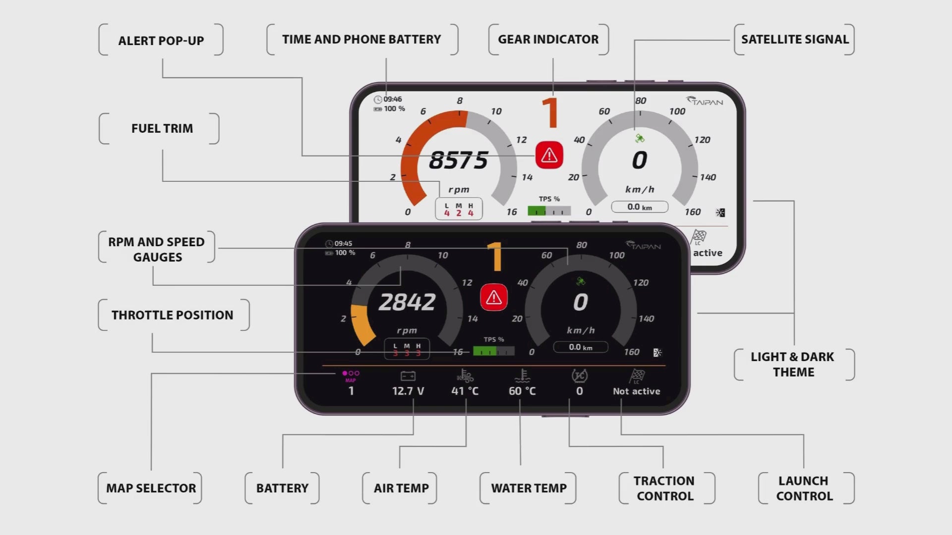

تحميل الفيديو: Showcase of the Spark Software on mobile devices
Download the FREE SPARK App
SPARK is now available as a mobile app for both Android and iOS, with seamless Bluetooth connectivity to your bike.
Connect your smartphone to the Taipan and ECU in two ways:
  • Via the CAN-BT Module, for instant access to key engine data and real-time telemetry.
  • Using the XLog, if you want to collect data while driving as well.
The Taipan ECU Expansion list; Solo 2 DL, SmartyCam 3, Handlebar Switch 2, UC-Bridge and more
The Taipan ECU works seamlessly with Aim’s ecosystem of devices.

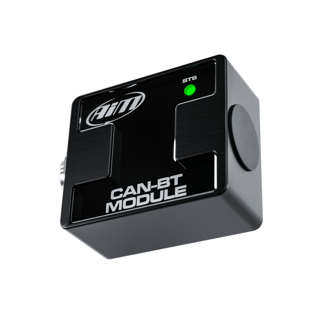

  • CAN-BT Module: The CAN-BT Module grants instant access to key engine data from your Taipan ECU. Install the SPARK App on your smartphone for a streamlined, data-driven interface for real-time monitoring of live engine parameters.
  • Handlebar Switch 2: HBS2 is the compact, high-performance, and durable Handlebar Switch. If you're looking for a highly flexible and ergonomic switch, the model from Aim offers a great solution with 4 push buttons and 11 integrated LEDs.
  • UC-Bridge: The UC Bridge serves as the essential interface connection between the CAN bus of the ECU and the USB port of your PC.
  • Data Hub: Split EXP ports to connect multiple expansions such as the Solo 2 lap timer, UC Bridge, Handlebar Switch or additional converters.
  • Two 0-5V analogue inputs sampled at 1,000Hz each - could be alternatively used as a switch to ground
  • One low-side driver (1A)
  • Two CAN bus - one for calibration purposes, one for expansions (Aim Handlebar Switches, data loggers, dashes etc)
  • Three JST JWPF waterproof auxiliary connectors
  • Power Consumption: 150mA
  • Body: PA6 + 30% glass fiber

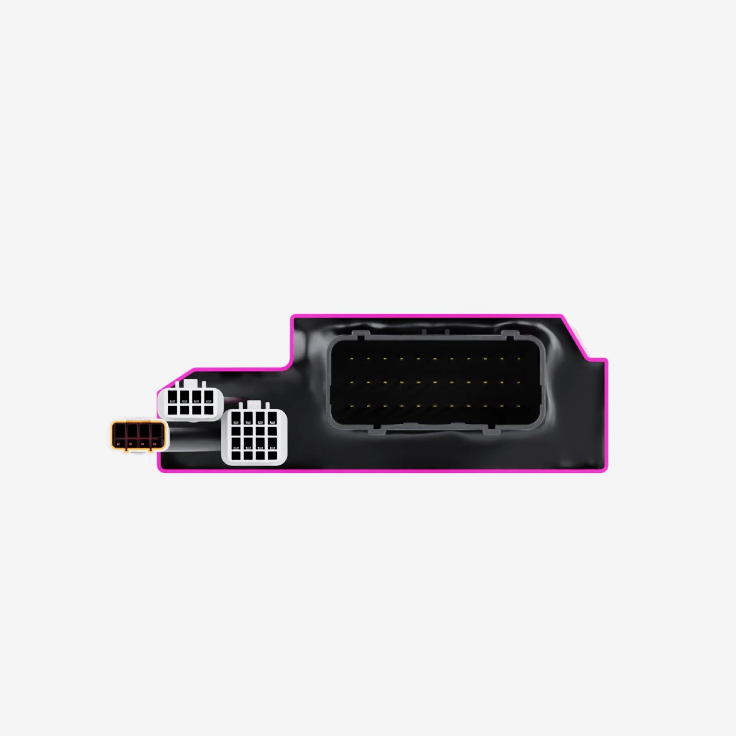

Connectors
  • 1 JST 04T-JWPF-VSLE-S connector
  • 1 JST 08R-JWPF-VSLE-D connector
  • 1 JST 04R-JWPF-VSLE-S connector
  • 1 33-pin male connector
  • Weight: 260g
  • IP67
SKU: C-ECU
Part Number: XE1ECUCB0

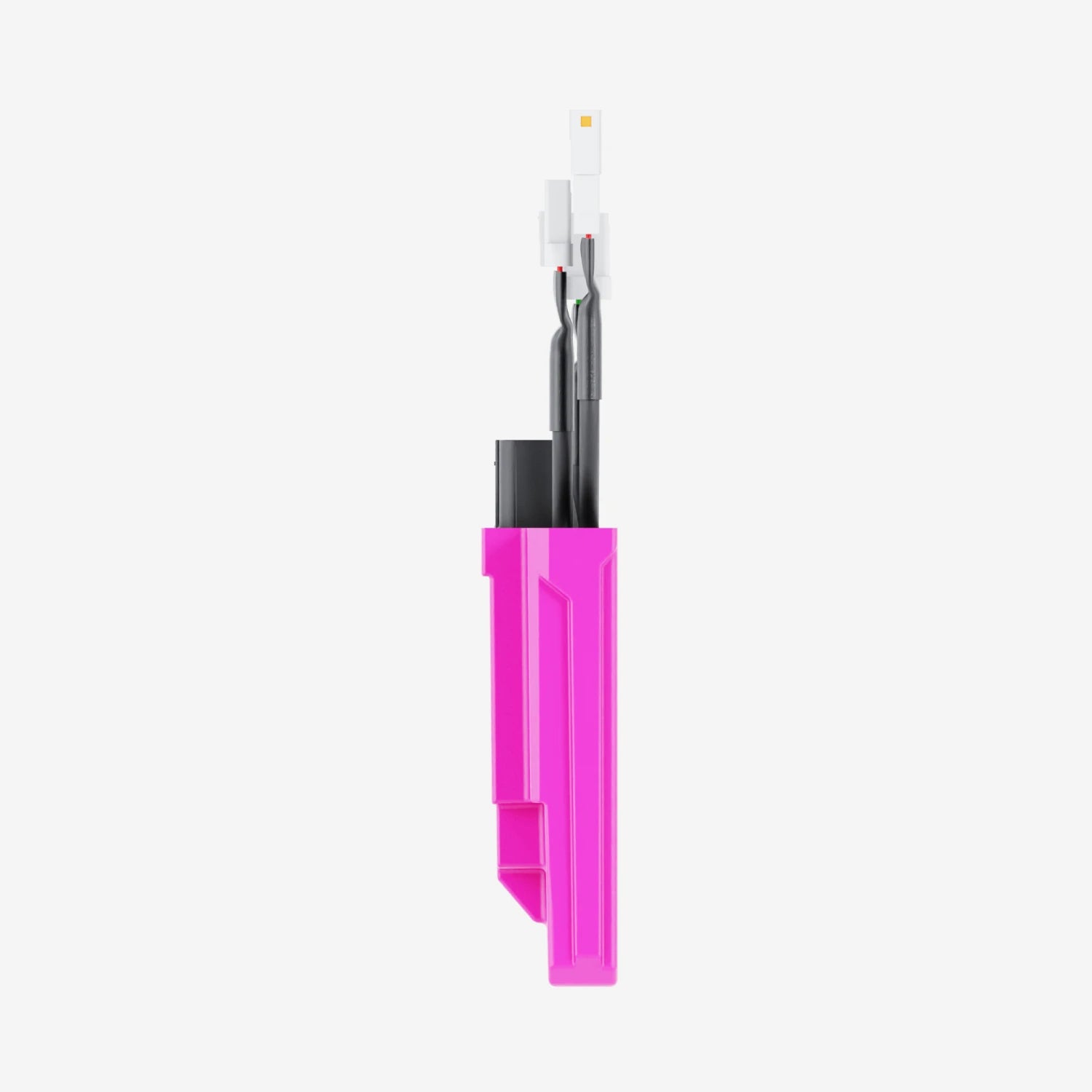

Taipan Y V2
Made For:
  • 4-Stroke MX Bikes
  • Ducati Desmo450 MX
  • GASGAS EC 250F/EC 350F/MC 250F/MC 450F
  • Honda CRF 250R/CRF 450R/CRF 450L/CRF 450R
  • Husqvarna FC 250/FC 350/FC 450/FE 250/FE 350/FE 450/FE 501/FE 450 Supermoto
  • Kawasaki KX250/KX450
  • KTM SX-F 250/SX-F 350/SX-F 450/EXC-F 250/EXC-F 350/EXC-F 450/EXC-F 500/SMR 50
  • Various Years From 2019 to 2025

  • Taipan Control Unit
  • Taipan K Control Unit
  • Taipan Y Control Unit
  • Taipan Y V2 Control Unit
  • Analogue Inputs: Two 0-5V sampled at 1,000Hz each - could be alternatively used as a switch to ground
  • Second Injector Driver: (12Ω) for high impedance saturated injectors
  • Low-Side Driver: 1 (1A)
  • CAN Bus: 2 - one for calibration purposes, one for expansions (Aim Handlebar Switches, data loggers, dashes etc)
  • Connectors:
  • Analogue Inputs: Two 0-5V analogue inputs sampled at 1,000Hz each - could be alternatively used as a switch to ground
  • Connectors:
  • Connectors:
  • Connectors:
