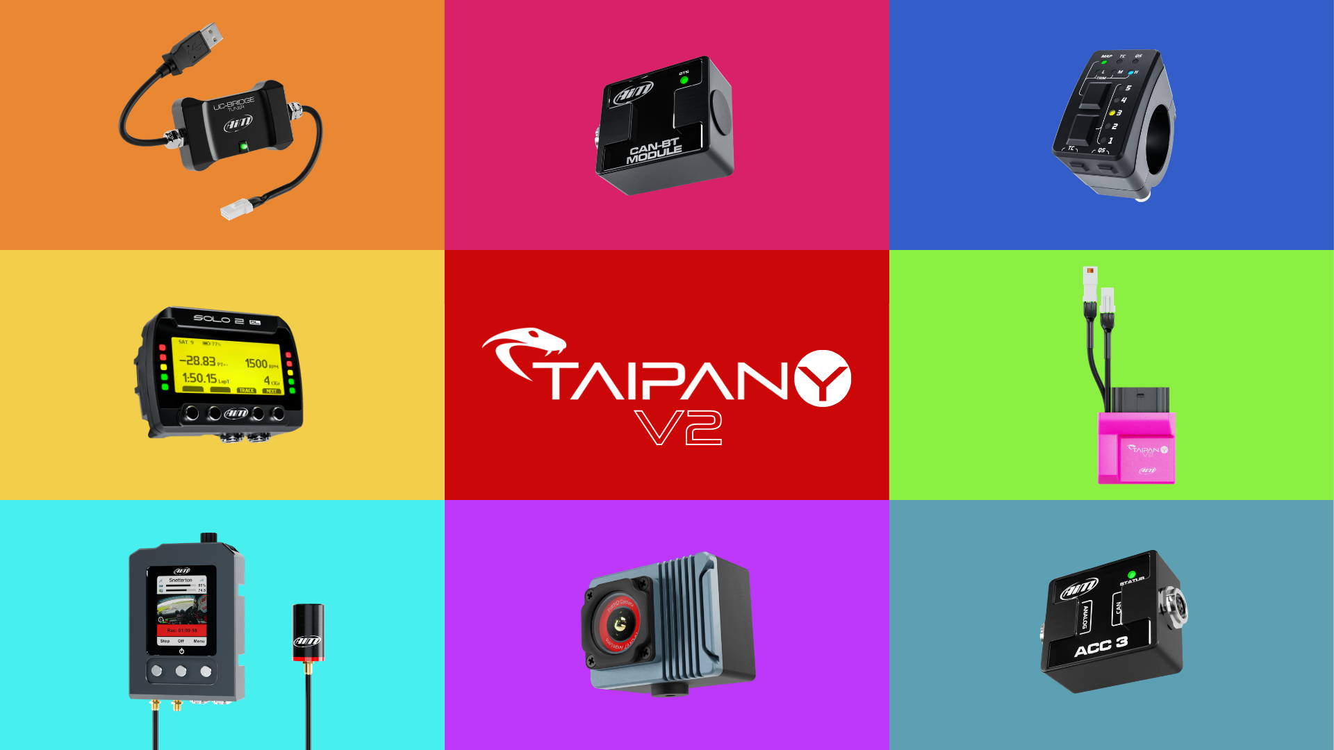

The Taipan ECU Expansion list; Solo 2 DL, SmartyCam 3, Handlebar Switch 2, UC-Bridge and more
The Taipan ECU works seamlessly with Aim’s ecosystem of devices.
  • CAN-BT Module: The CAN-BT Module grants instant access to key engine data from your Taipan ECU. Install the SPARK App on your smartphone for a streamlined, data-driven interface for real-time monitoring of live engine parameters.
  • Handlebar Switch 2: HBS2 is the compact, high-performance, and durable Handlebar Switch. If you're looking for a highly flexible and ergonomic switch, the model from Aim offers a great solution with 4 push buttons and 11 integrated LEDs.
  • UC-Bridge: The UC Bridge serves as the essential interface connection between the CAN bus of the ECU and the USB port of your PC.
  • Data Hub: Split EXP ports to connect multiple expansions such as the Solo 2 lap timer, UC Bridge, Handlebar Switch or additional converters.
