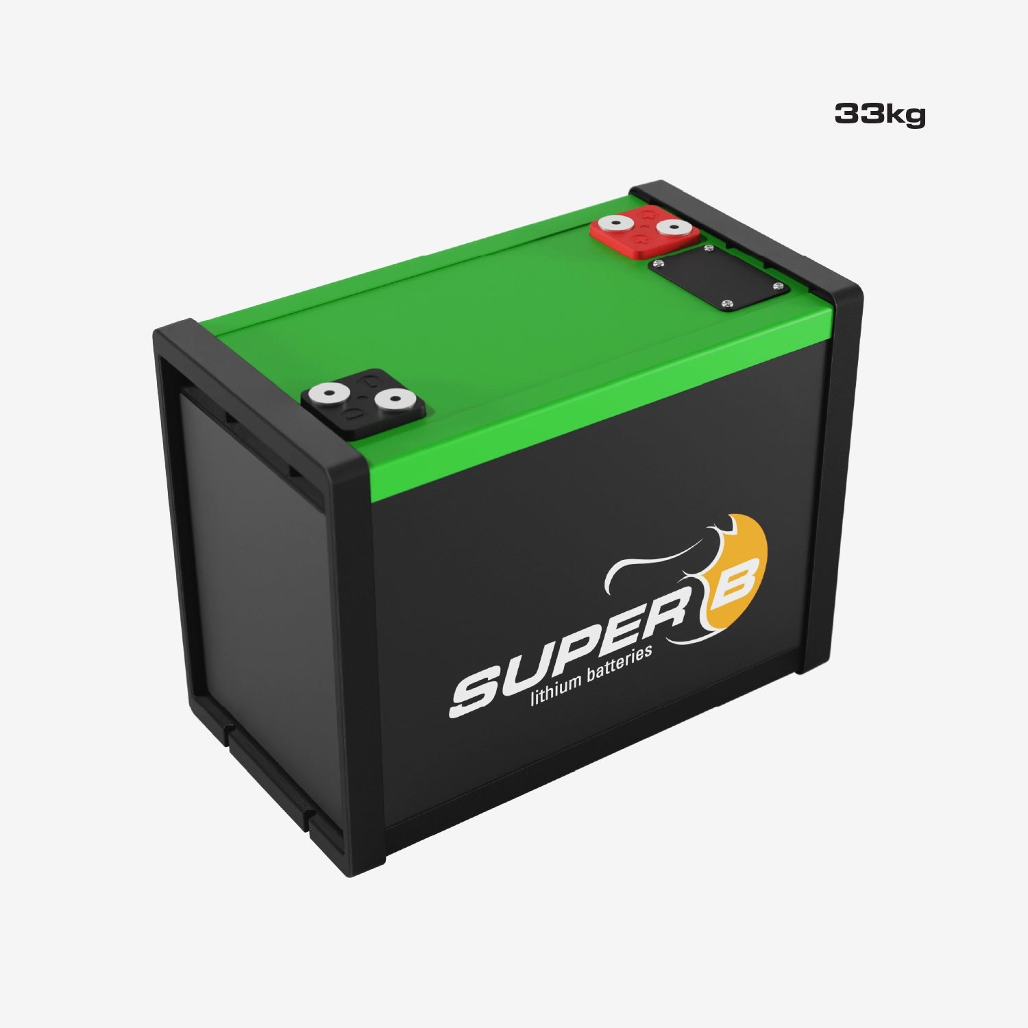

    The Super B Nomia 12V340AH Lithium Traction Battery is a state-of-the-art Lithium Iron Phosphate battery (LiFePO4) with a rated capacity of 340Ah for high-performance energy storage. Its advanced technology and smart software makes this lithium battery a robust, low-maintenance, safe and user-friendly energy storage solution, offering significant weight and space savings compared to conventional lead-acid batteries.
    Product Features
    Traction battery
    Lithium Iron Phosphate (LiFePO4): Safe Li-Ion technology
    Integrated BMS (Battery Management System), external disconnect device needed
    Glass fibre reinforced plastic (GRFP) Casing, Aluminium / PE sandwich side panels
    Terminals for 2 x M8 bolts
    Integrated fuse, 32V / 500A
    Wired communication interface: CAN open
    Battery monitoring / History storage
    Adaptive cell balancing
    Configurable in serial or parallel connection
    Output for bistable relay/latching relay
    Weight & space-saving battery
    Aim Shop Youtube Channel Product Videos - Aim Academy
    Intended Use
    The Nomia 12V340Ah Li-Ion battery is ideal for recreational vehicles, commercial vehicles, leisure boats, commercial vessels and stationary applications.
    Potential applications of this Li-Ion battery include: off grid power supply, marine power supply, medium for (renewable) energy storage and (traction) battery for vehicles.
    Note: This battery is not suitable for use as a starter battery. Up to 4 batteries can be connected in series or in parallel to increase the total capacity up to 1360Ah. For more batteries, consult with Super B for guidance.
