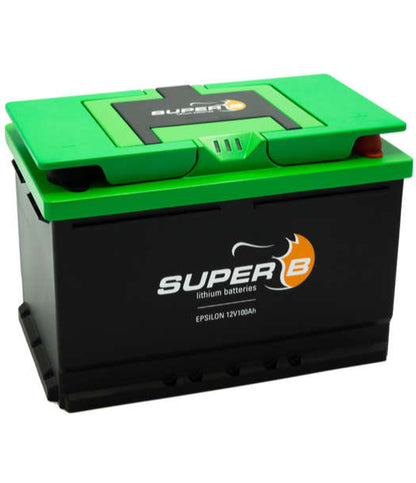

    The Super B Epsilon 12V100Ah Lithium Iron Phosphate Battery offers the highest power capacity currently available in a standard-size casing. Specifically designed for demanding applications across motorsports, marine, RV and off-grid energy systems, these lightweight batteries provide superior performance thanks to their integrated battery management system (BMS), automatic heating and Bluetooth monitoring.
    Engineered by Super B Energy, the Epsilon Battery delivers reliable lithium power with advanced safety, monitoring and thermal performance—making it a go-to choice for motorsport teams and mobile adventurers alike.
    Super B Epsilon 12V100Ah Intended Use
    The Super B Epsilon 12V100Ah Lithium Traction Battery offers peak performance for competitive racing environments. Its high discharge current and robust design make it ideal for motorsport teams who demand consistent power output under stress.
    Beyond motorsports, this battery shines in recreational vehicles, commercial vehicles, leisure boats, commercial vessels and stationary applications where space, weight and reliability are crucial. It can be used for off-grid power supply, marine power supply or a medium for (renewable) energy storage, and its compact size and fast charging make it the perfect drop-in upgrade from bulky AGM or lead-acid systems.
    Please Note: Use as a starter battery is not possible. Never install multiple Epsilon Li-ion batteries in series. Up to 8 batteries can be connected in parallel to increase the total capacity up to 800Ah for the 12V100Ah Epsilon variant.
    Why Choose Super B Epsilon 12V100Ah?
    It uses top-grade Lithium Iron Phosphate (LiFePO4) prismatic cells for safety, durability and long cycle life
    Integrated Battery Management System (BMS) provides real time protection against overcharging, overheating, short-circuiting and imbalance—ensuring maximum longevity and performance in every charge
    Automatic internal heating allows for sub-zero charging, making it ideal for harsh environments
    Robust casing made from environmentally friendly materials (fully recyclable)
    Battery monitoring / history storage
    Adaptive cell balancing
    Configurable general-purpose inputs/outputs to control external devices like chargers
    Separate power output connection for powering accessories. Analogue SoC output

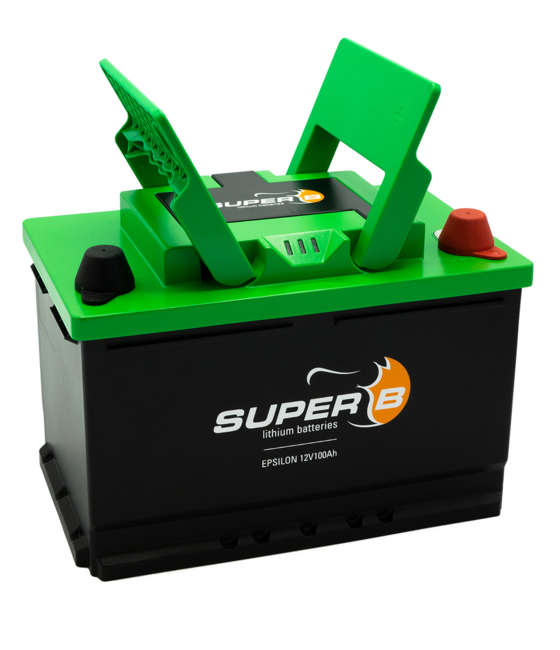

    Multi-connectable coated aluminium terminals, including temperature sensors for protection
    LN3 / DIN H6 and LN5 / DIN H8 sizes available in different capacities (100Ah and 150Ah)
    Integrated and configurable discharge limit (Shutdown based on State of Charge)
    CAN bus (wired), LIN bus (wired) and Bluetooth (wireless) connectivity allows you to monitor your battery in real time using the free Be In Charge app
    Compared to traditional batteries, the Super B Epsilon 12V100Ah Lithium Traction Battery delivers faster charging times, a significantly longer lifespan and more usable energy per cycle. With over 5,000 cycles at full depth of discharge and over 96% energy efficiency, it's an investment in long-term performance and peace of mind.
    Its low self-discharge (less than 3% per month) ensures that the battery retains its charge, even when not in use—ideal for seasonal applications like racing, sailing or overlanding.

    Specifications
    ELECTRICAL SPECIFICATIONS
    Nominal capacity
    100Ah
    Open circuit voltage
    13.2v
    self-discharge
    <3% per month
    Cycle Life
    >5000 cycles (at 100% DoD)
    Voltage
    12v
    MECHANICAL SPECIFICATIONS
    Dimensions (LxWxH)
    278 x 175 x 190 mm / 11” x 6.9” x 7.5” (=DIN H6 / LN3)
    Weight
    10.7 kg / 23.6 lbs
    Case material
    PC/ABS
    Ingress protection
    IP56
    Cell type / Chemistry
    Prismatic - LiFePO4
    Charge method
    CCCV
    Charge voltage
    14.3V - 14.6V
    Max. charge current
    90A
    End of discharge voltag
    8V
    Discharge current continuous
    190A
    Discharge pulse current
    300A
    TEMPERATURE SPECIFICATIONS
    Charge temperature
    -30°C to 45°C / -22°F to 113°F
    Discharge temperature
    -20°C to 60°C / -4°F to 140°F
    Storage temperature
    -20°C to 45°C / -4°F to 113°F
    COMPLIANCE SPECIFICATIONS
    Certifications
    CE, FCC, UN 38.3, UN ECE R10.06, UL 1642 (Cells)
    Shipping classification
    UN 3480
    GENERAL SPECIFICATIONS
    EAN-13
    8718531362208
    Battery designation
    IFpP/27/148/135[2p4s] M/-20+60/95
