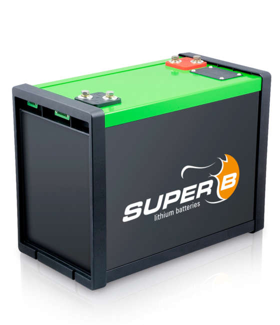

    The Super B Nomia 12V210Ah is a lighter (23kg vs 33kg) and lower capacity version of the Nomia 340Ah, making it ideal for weight-sensitive setups like campervans and mobile applications
    superb lithium batteries
    What Is The Super B Nomia 12V210AH Lithium Traction Battery?
    The Super B Nomia 12V210AH Lithium Battery is a state-of-the-art Lithium Iron Phosphate battery (LiFePO4) designed for traction and energy storage applications. Its advanced technology and smart software makes this lithium battery a robust, low-maintenance, high-efficiency, safe and user-friendly energy storage solution, offering significant weight and space savings compared to traditional lead-acid batteries.

    The Super B Nomia 12V210Ah Lithium battery stands out for its high energy capacity (210Ah) and advanced LiFePO4 technology, offering superior safety, longevity and performance. It provides reliable protection against overcharging, deep discharging and overheating, contributing to its long cycle life of over 3,500 cycles at 100% depth of discharge.
    Despite its strong output, the battery remains compact and lightweight at just 23 kg, making it ideal for space-sensitive applications. The Nomia also supports fast charging up to 200A, delivers high discharge currents and has a low self-discharge rate under 3% per month. Overall, it offers a reliable, low-maintenance power solution for a variety of setups.

    Specifications
    ELECTRICAL SPECIFICATIONS
    Nominal capacity
    210Ah
    Open circuit voltage
    13.2v
    self-discharge
    <3% per month
    Cycle Life
    >3,500 cycles (at 1C charge/ discharge, 100% DoD)
    Voltage
    12v
    MECHANICAL SPECIFICATIONS
    Dimensions (LxWxH)
    417 x 227 x 314 mm / 16.4” x 8.9” x 12.4”
    Weight
    23kg / 50.7lbs
    Case material
    GFRP
    Ingress protection
    IP50
    Cell type / Chemistry
    Prismatic - LiFePO4
    Charge method
    CCCV
    Charge voltage
    14.3V - 14.6V
    Max. charge current
    200A
    End of discharge voltage
    10V
    Discharge current continuous
    200A
    Discharge pulse current
    600A (30 sec)
    TEMPERATURE SPECIFICATIONS
    Charge temperature
    0°C to 55°C / 32°F to 131°F
    Discharge temperature
    -20°C to 55°C / -4°F to 131°F
    Storage temperature
    -20°C to 45°C / -4°F to 113°F
    COMPLIANCE SPECIFICATIONS
    Certifications
    CE, FCC, UN 38.3, UN ECE R10.06, UL 1642 (Cells), EN/IEC 62619-62620 (ESTRIN), RINA Type Approval
    Shipping classification
    UN 3480
    GENERAL SPECIFICATIONS
    EAN-13
    8718531361645
    Battery designation
    IFpP/36/130/195/ [2P4S]M/-20+55/95
