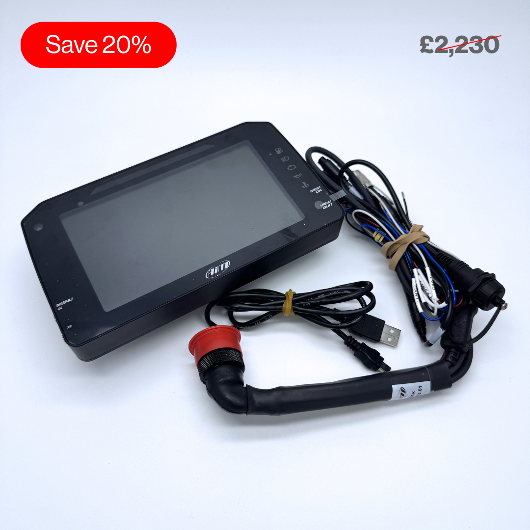

This MXP Logger with Road Icons is fully equipped and ready to take on its second life. The product is in full working order at a reduced price, and has been meticulously checked by our technicians. The icon casing has been swapped to a 'Road ' variant, please note that this in no way affects the condition or the efficiency of the product.
