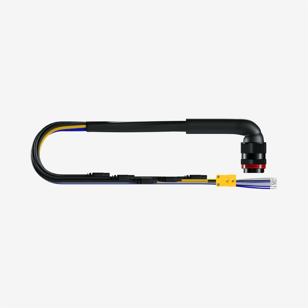

Deutsch Harness with 1 Thermocouple

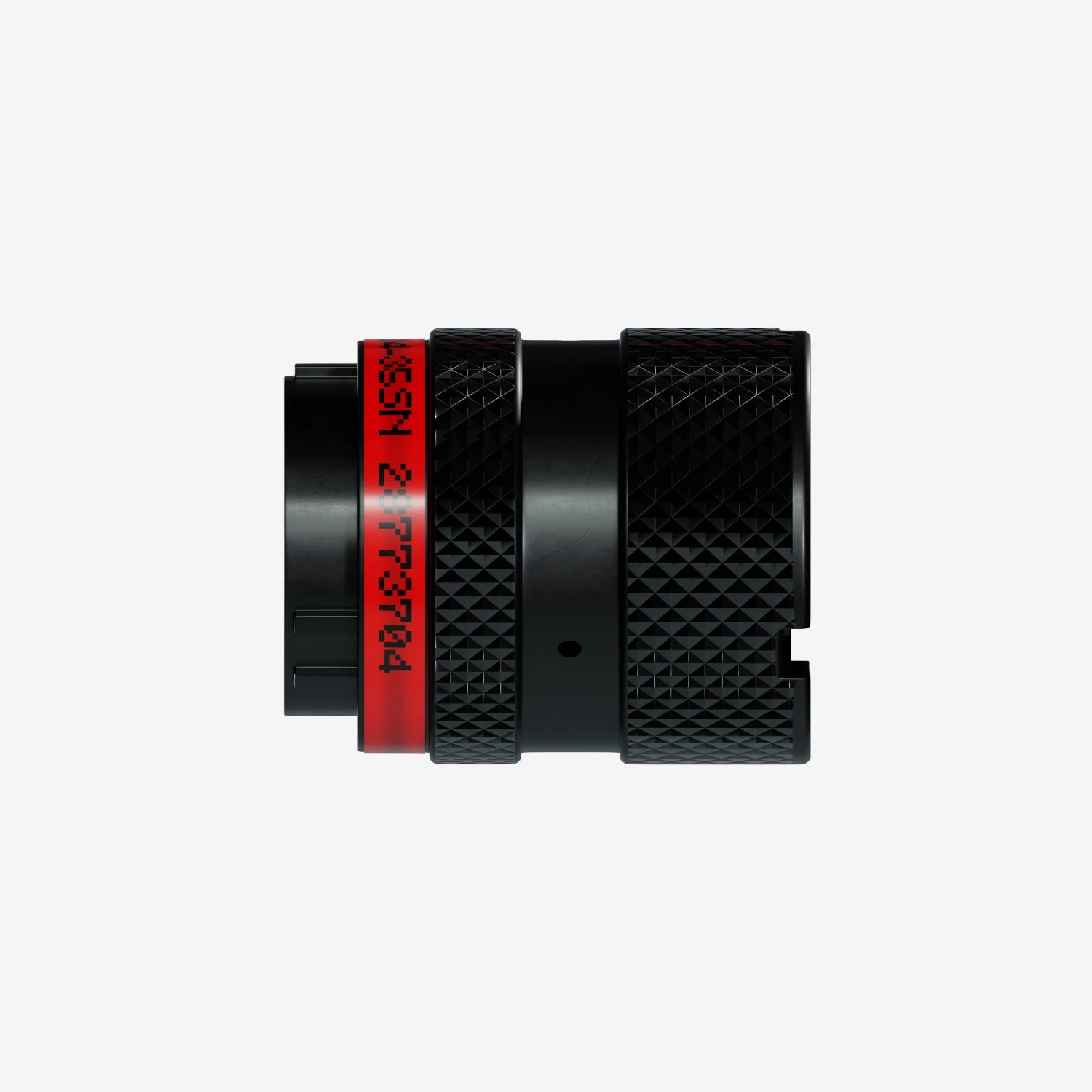

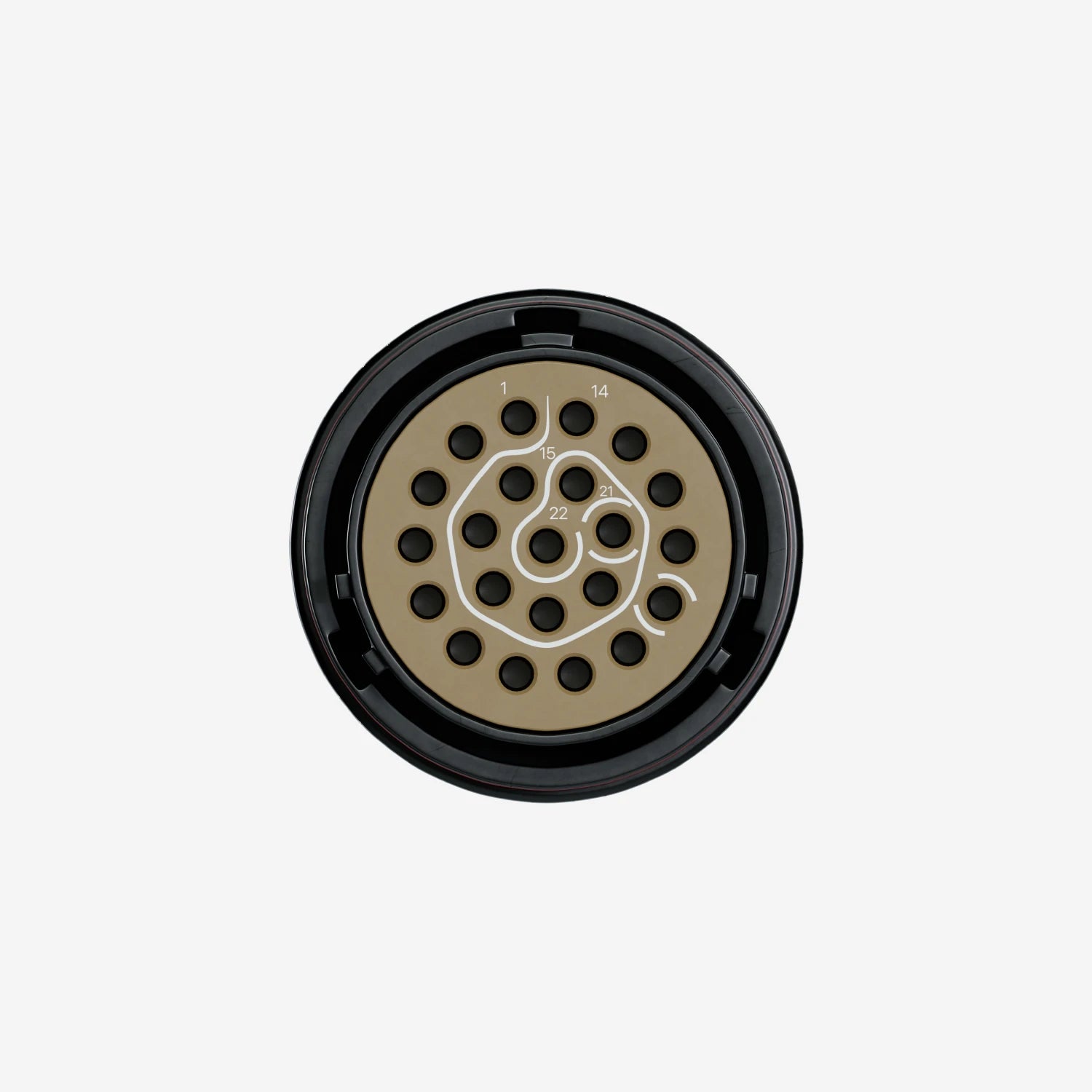

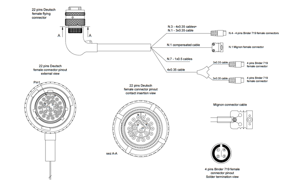

The Aim 22-Pin Deutsch Harness gives you expanded input/output capability for your Aim MX Logger alongside the main 37-Pin Harness. The 22-Pin Deutsch Harness includes a 22-pin Deutsch female flying connector, one female TC Yellow connector and 4-pin 719 female binders. It connects into the 22-pin socket on your MX Data Logger, giving you access to analogue sensor channels (6-8), digital wheel speed sensor inputs (2-4), digital 12V outputs, an RS232 ECU connection and a channel (5) to connect one K-Type thermocouple sensor.

The standard 37-Pin Harness that comes with the logger supports 4 primary analogue channels, including water temperature, oil temperature, oil pressure and brake pressure; this 22-Pin Harness expands your capability for things like steering angle, throttle position, gearbox input and differential temperature. The pre-wired thermocouple connector also allows you to measure things like exhaust gas temperature (EGT) directly from the harness.
