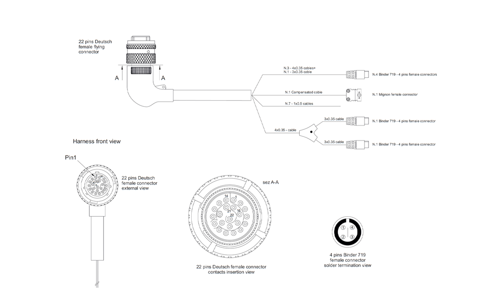

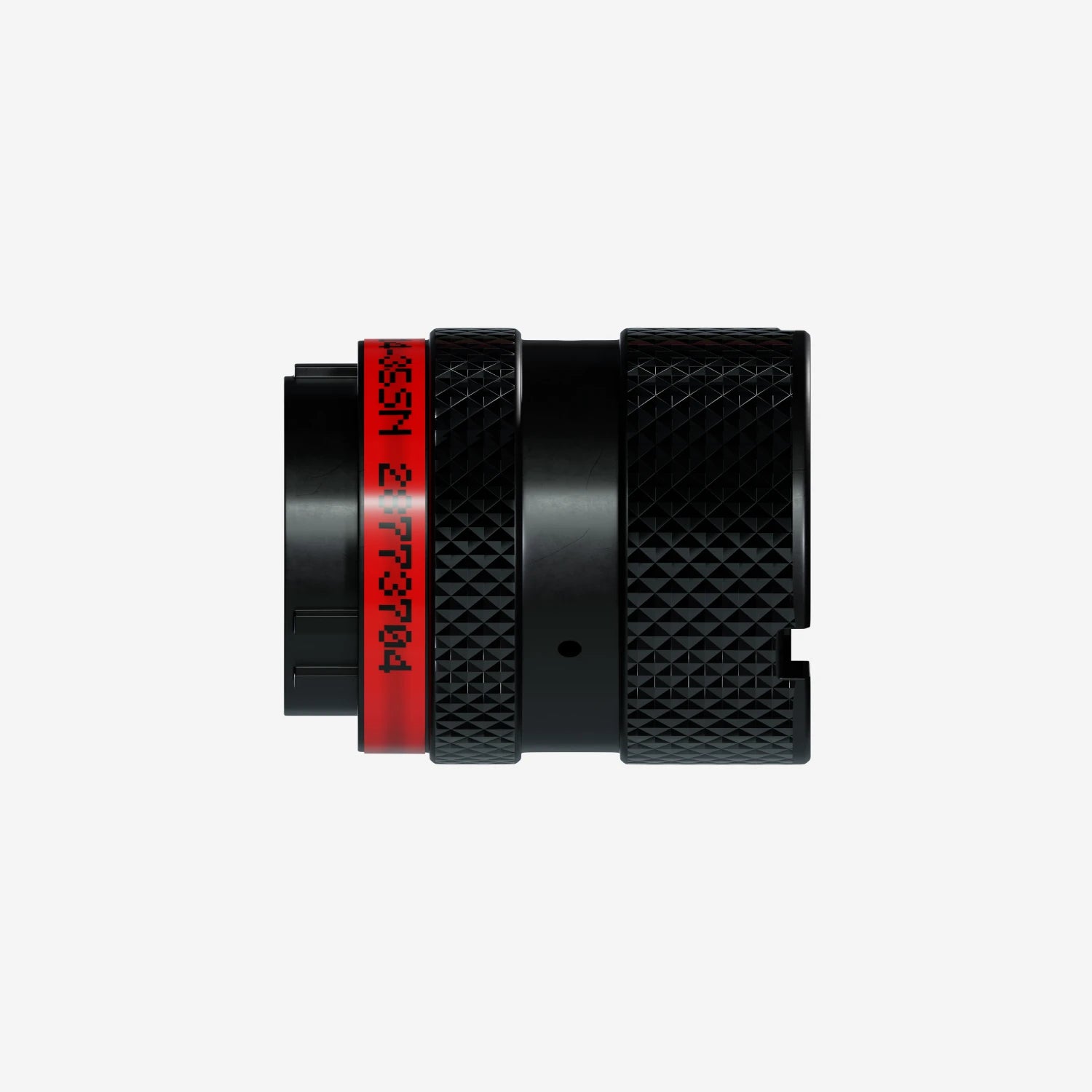

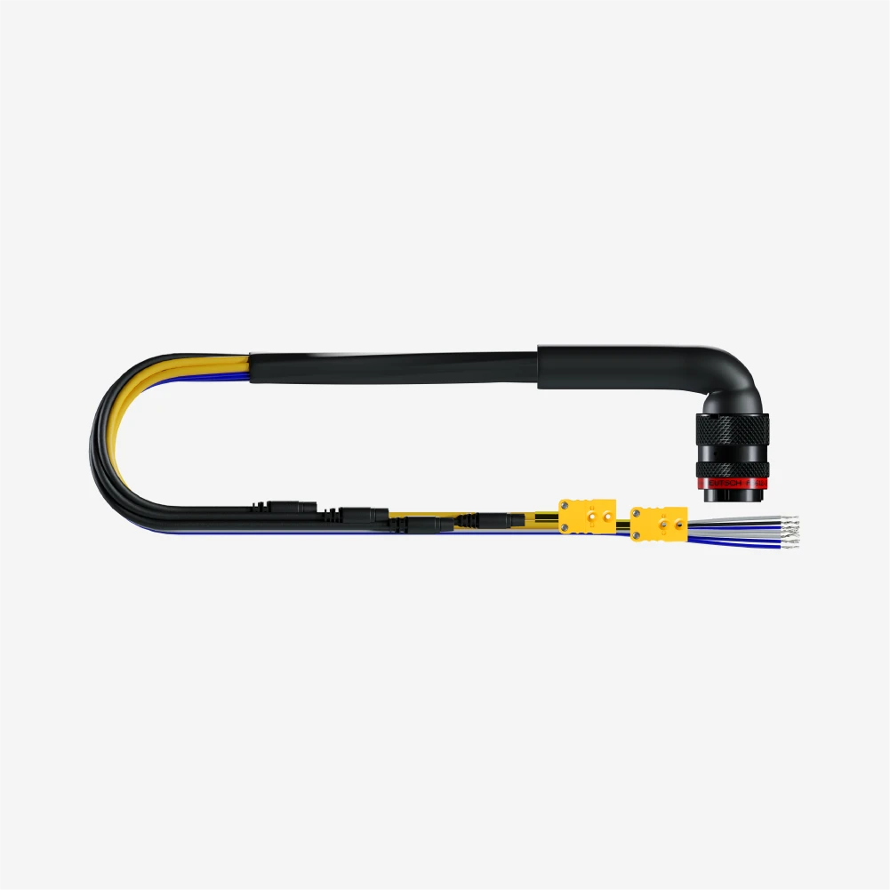

Deutsch Harness with 2 Thermocouples

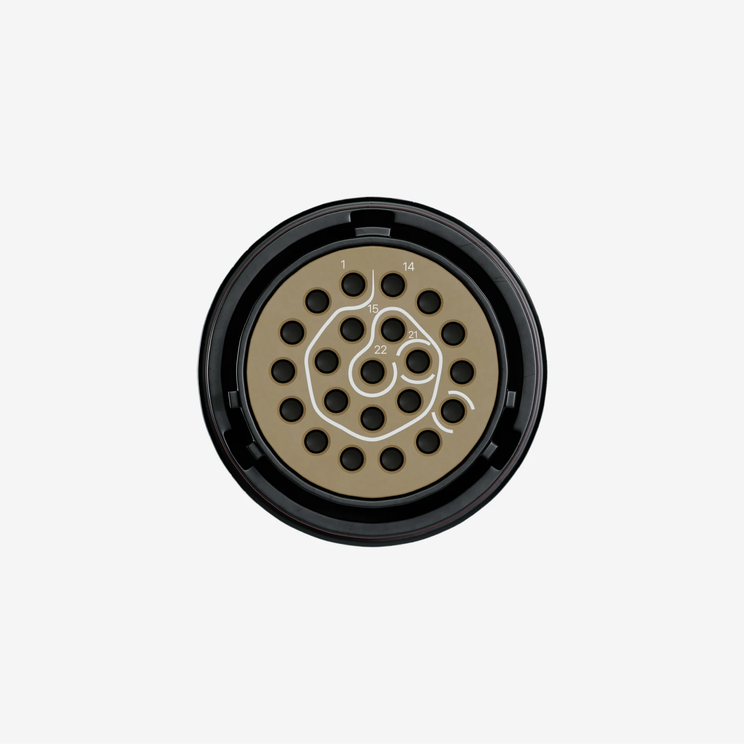

The Aim 22-Pin Deutsch Harness gives you expanded input/output capability for your Aim MX Logger alongside the main 37-Pin Harness. The 22-Pin Deutsch Harness includes a 22-pin Deutsch female flying connector, two female TC Yellow connectors and 4-pin 719 female binders. It connects into the 22-pin socket on your MX Data Logger, giving you access to analogue sensor channels (7-8), digital wheel speed sensor inputs (2-4), digital 12V outputs, an RS232 ECU connection and channels (5-6) to connect two K-Type thermocouple sensors.
Why Choose the Aim 22-Pin Deutsch Harness with Thermocouples
The Aim 22-Pin Deutsch Harness is built to integrate with Aim MX Display Loggers in race or track vehicles, offering additional channels and advanced functions in a compact, motorsport-ready harness.
The standard 37-Pin Harness that comes with the logger supports 4 primary analogue channels, including water temperature, oil temperature, oil pressure and brake pressure; this 22-Pin Harness expands your capability for things like steering angle, throttle position, gearbox input and differential temperature. The pre-wired thermocouple connectors also allow you to measure things like exhaust gas temperature (EGT) directly from the harness.
