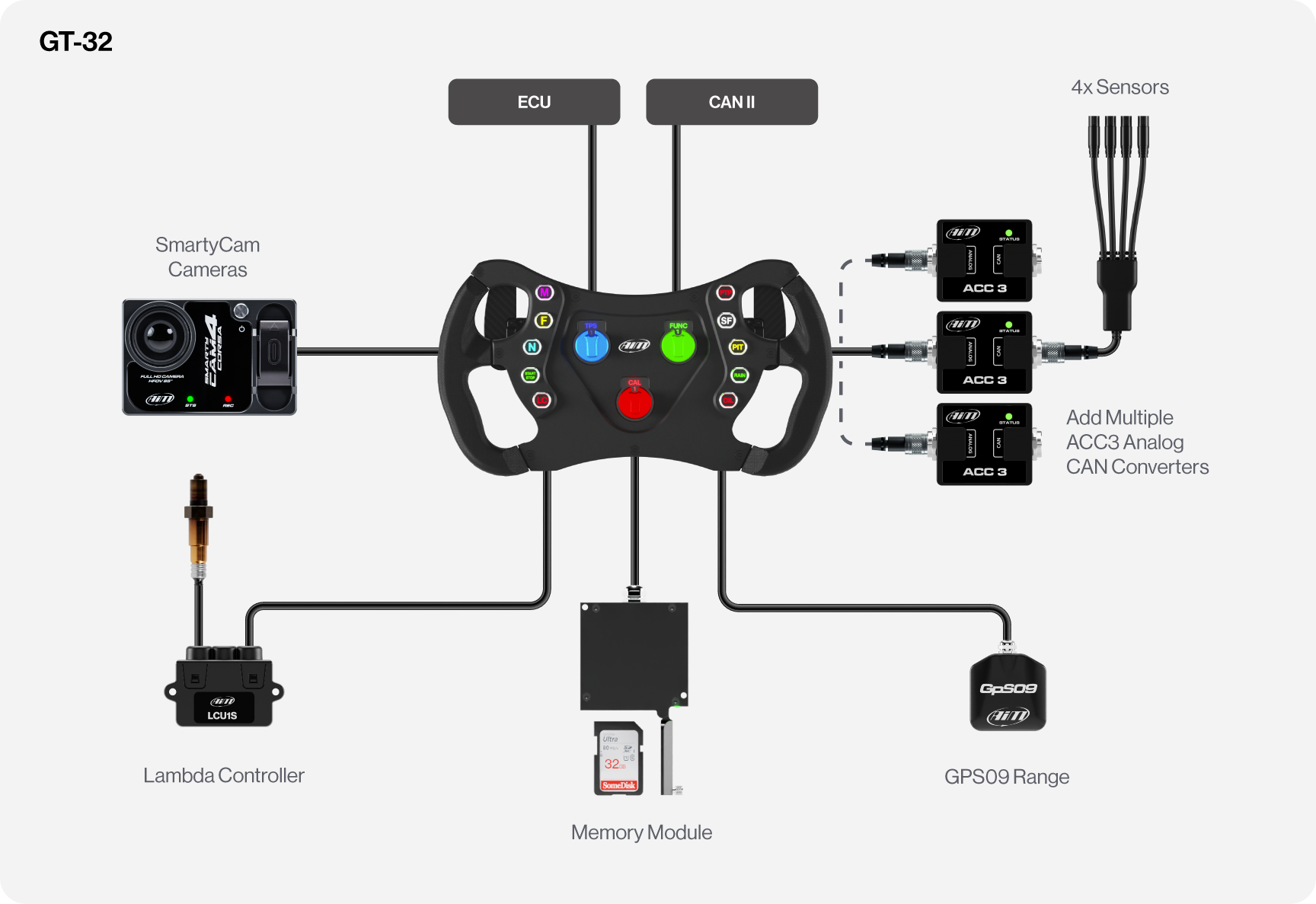

Standalone: GT32 is available in a completely standalone version that connects via CAN to any ECU.
Expansion: GT32 CAN Open Steering Wheel is available as an expansion for the PDM32/08 Power Distribution Module, providing seamless integration into a complete Aim electronics system.

In standalone mode, the GT32 Steering Wheel can also manage a CAN input protocol, providing LED feedback (such as colour changes) based on received information.
Additional accessories can be added to your GT32 to expand the system
capabilities:
  • Additional Controls: In expansion mode, the GT32 can also manage an Aim display connected to a PDM32 or PDM08 Power Distribution Module.
