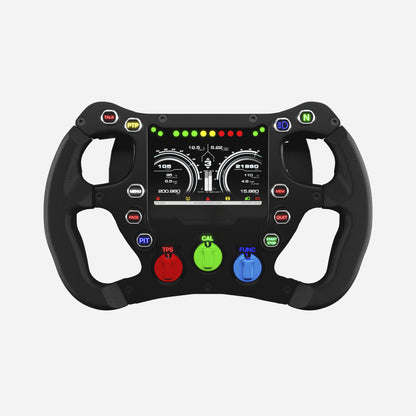

The Aim Formula Steering Wheel 4 280 is amongst our most advanced motorsport steering wheels to date. It has an internal data logger with complete configuration, removable grips, rotary switches and a long list of fully compatible ECU and CAN connectivity options.
Why Choose the Aim 280 Steering Wheel
The Aim Formula Steering Wheel 280 has been specifically designed for professional motorsport applications. The internal data logger is fully configurable and has been developed to acquire and display data from the ECU, with over 1,000 fully compatible ECU protocols.
Our Formula Steering Wheels come in a range of sizes (270, 280, GT320 & GT350). The compact 270 and 280 versions are the ideal choice for single-seaters or sports prototypes where cockpit space is at a premium.

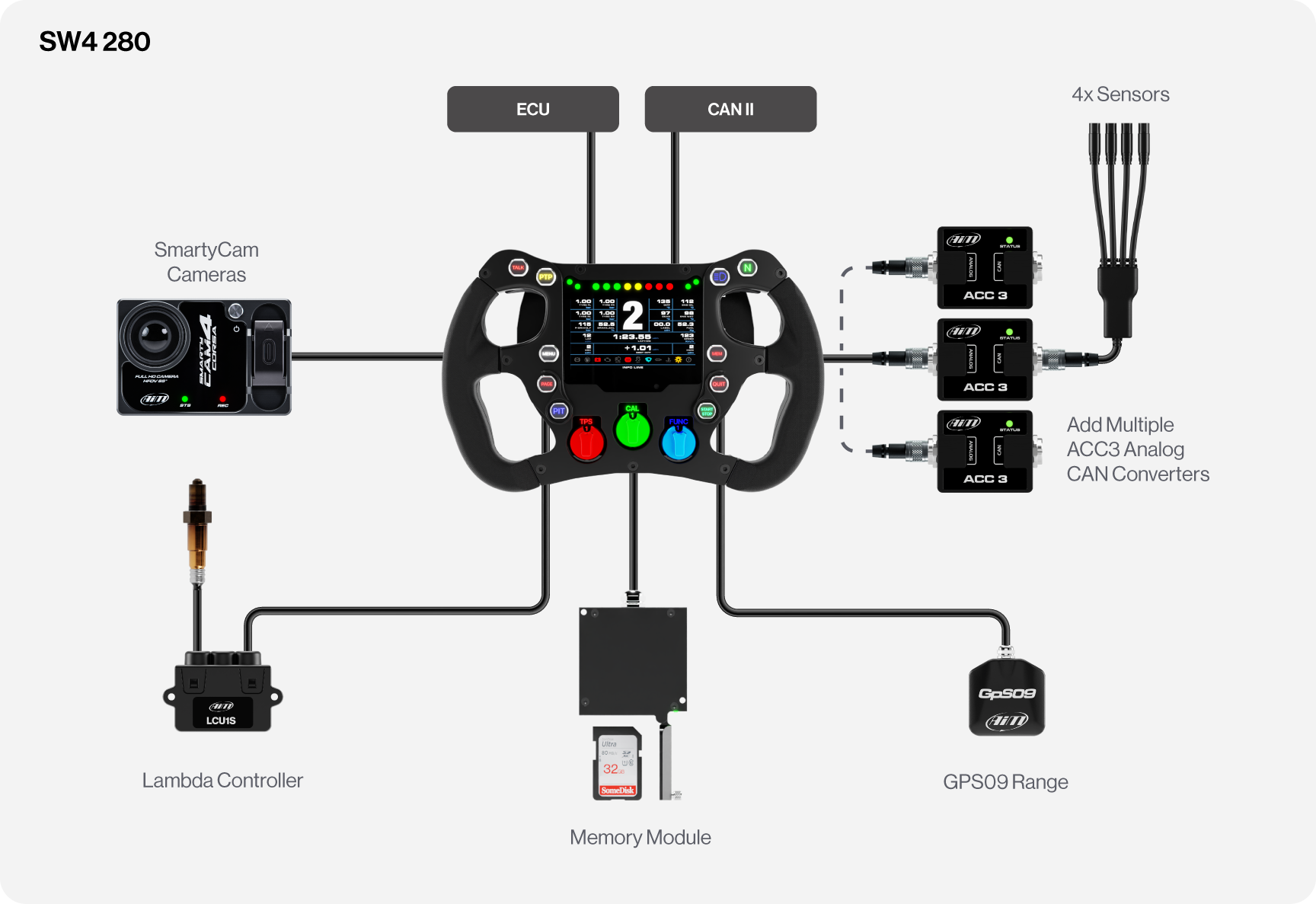

The Aim SW4 280 Formula Steering Wheel is also fully compatible with our PDM32 via CAN communication.
Connecting the Aim 280 Formula Steering Wheel to your ECU is straightforward. You can choose between an Aim Harness or craft your own harness using the existing Deutsch cable connected to the module to sample dozens of channels directly from the ECU using a single connection, rather than installing multiple analogue sensors.
The data sampled depends on the ECU in use, but typically includes RPM, engine load, throttle position (TPS), oil, air, and water temperatures, oil pressure, battery voltage, speed, gear, and lambda values (air/fuel ratio). The list of available ECU drivers is constantly updated and upgraded, and includes over 1,000 different ECUs.
With CAN output, you can send messages directly to an existing CAN network, enabling extended integration with other vehicle systems.
Display & Push Buttons

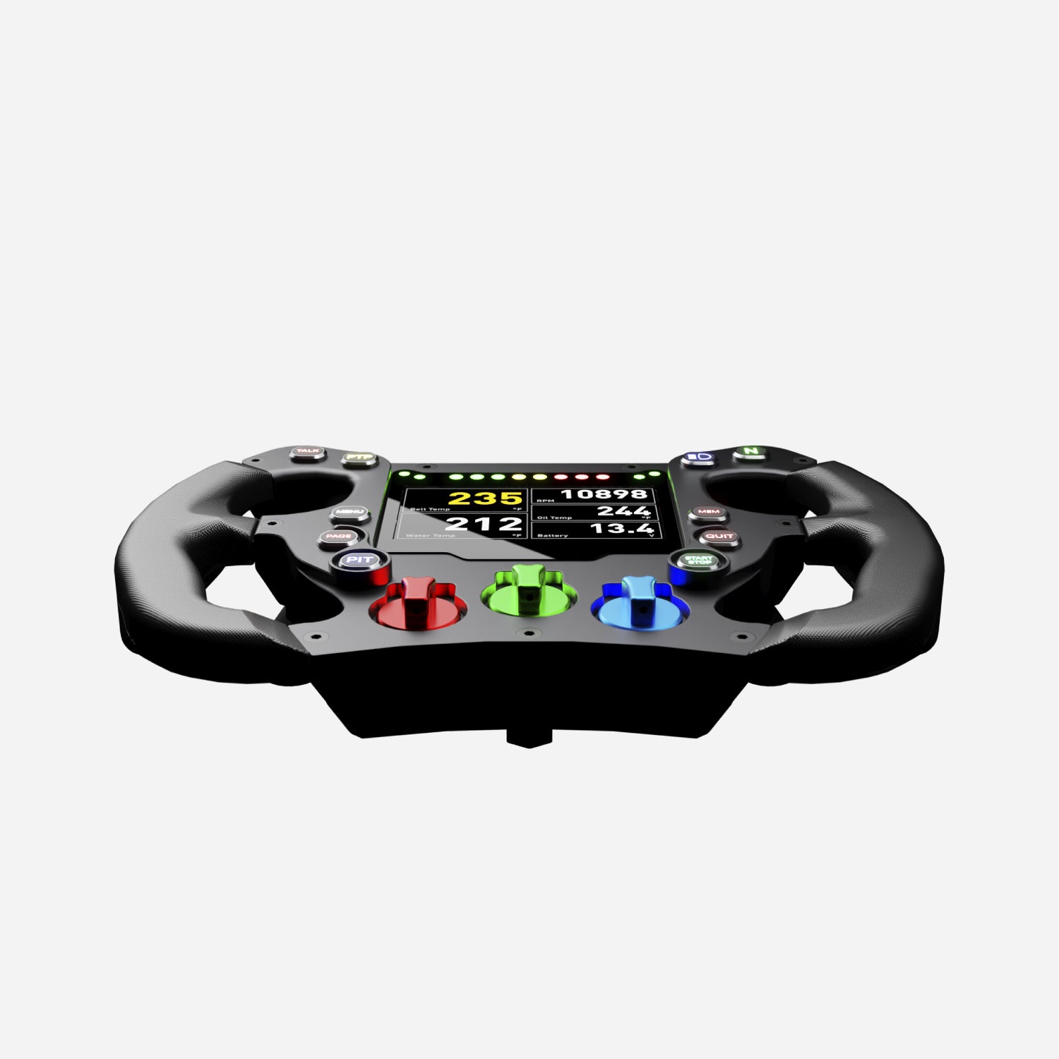

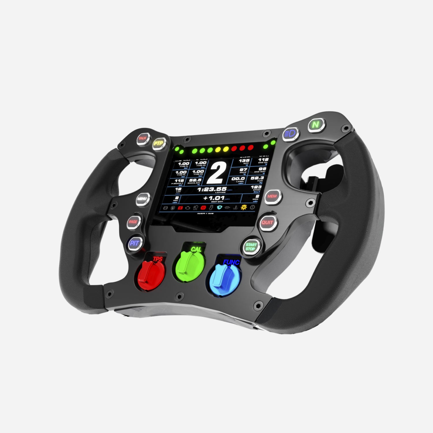

The Aim Formula Steering Wheel 4 280 is equipped with a high-contrast 4.3" TFT display, fully configurable and sunlight viewable. With 8 shift lights, 4 RGB alarm LEDs and an integrated ambient light sensor, the steering wheel delivers clear, precise, and reliable information directly to the driver at all times.
The Formula Steering Wheel 4 280 features 10 push buttons and 3 rotary switches, all backlit with RGB LEDs. It also includes removable grips, rotary switches, and a wide range of ECU and CAN connectivity options.
Flexible Alarms
The Aim SW4 280 Formula Steering Wheel offers 8 configurable shift light RGB LEDs and 4 configurable alarm RGB LEDs. You can define conditions, colours, priorities, and flashing frequencies, as well as display accompanying text messages when required.
The advanced multi-colour RGB shift lights can be fully customised, with the option to define different shift patterns for each gear.

  • GPS Module: Connected via CAN, the GPS Module makes lap timing and track position analysis easy.
  • Clutch Paddles: Left/right clutch paddles can be added from the accessories at the top of the page to suit your driving style.
  • Other Expansions: Expand your system with a range of additional Aim devices, including the TC Hub, Lambda Controller, SmartyCam, RIO, GS-Dash, and more.

Aim SW4 Steering Wheels are compatible with other Aim devices and data logging systems, such as the ACC3 Analogue CAN Converter, SmartyCam Cameras and various sensors. This allows for a more detailed and advanced data collection and analysis, making it a very versatile product for different motorsport applications.
