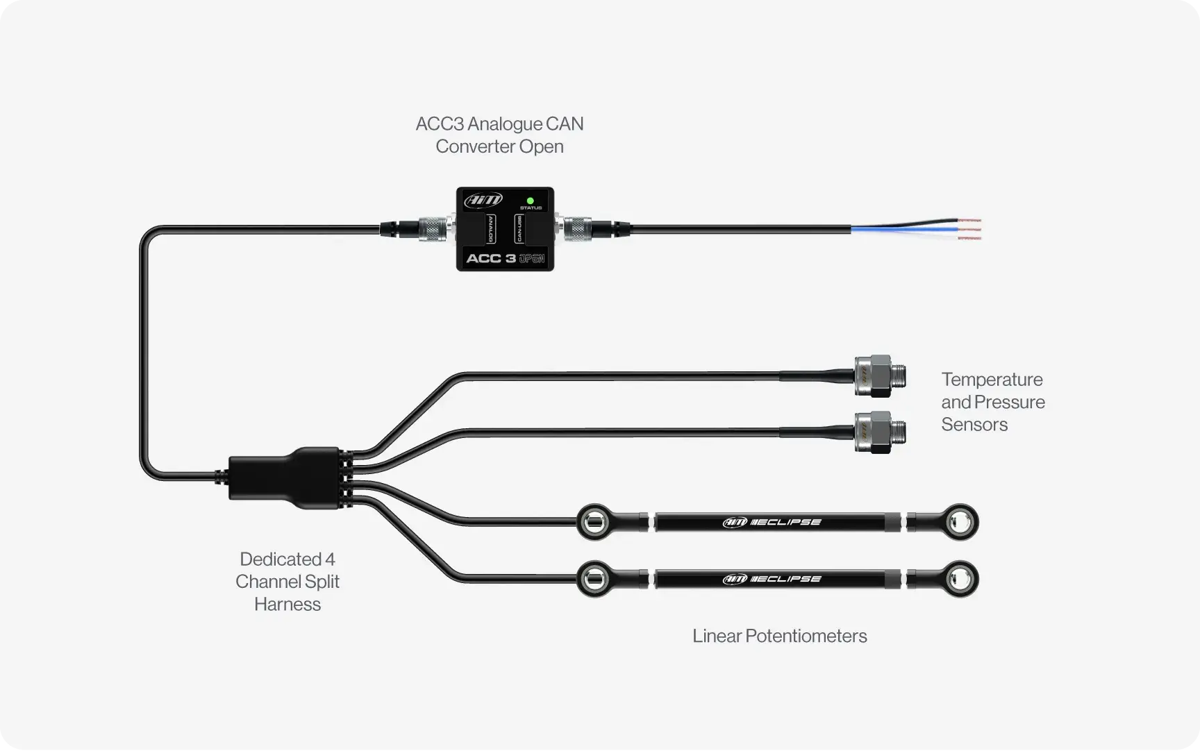

By selecting the appropriate harness, channels can be customised to the sensors you connect. The ACC3 Open supports up to 4 K-type thermocouples for accurate temperature measurement across multiple areas of your vehicle.
Suspension Analysis
The ACC3 Open can be connected to Aim Eclipse sensors, allowing for a comprehensive analysis of the entire chassis. Data acquired from Aim linear potentiometers can be processed through the suspension analysis tool in Race Studio 3, providing a detailed picture of your vehicle’s dynamics.
ACC3 Open
CAN Cable
ACC3 Open Harness
