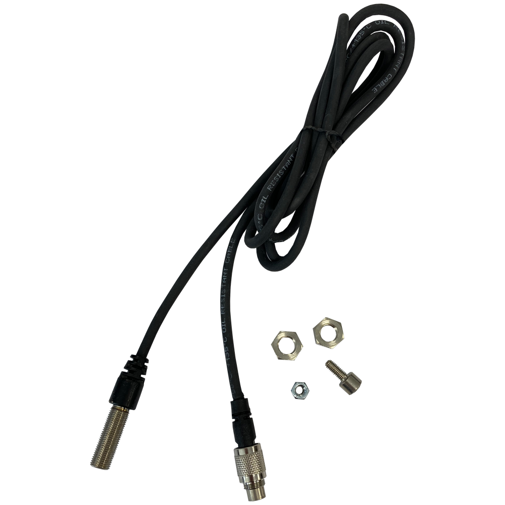

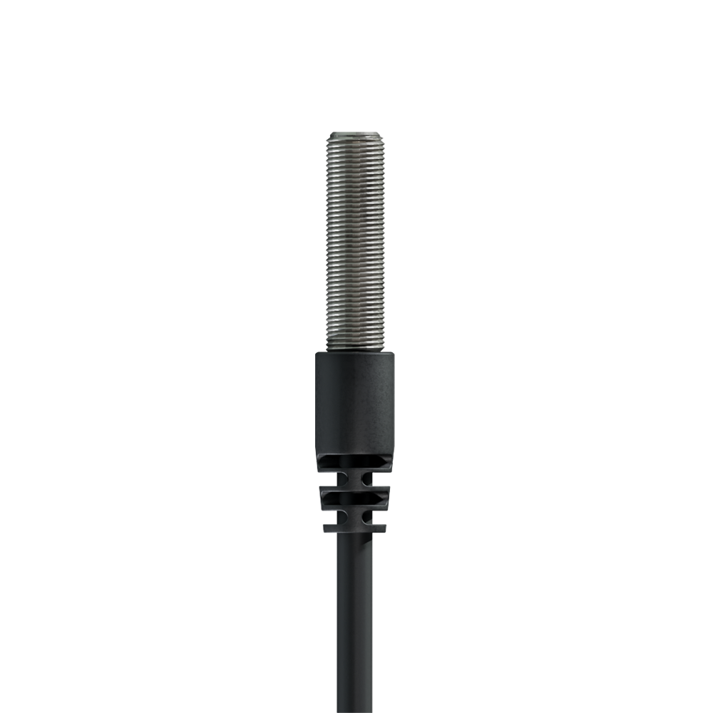

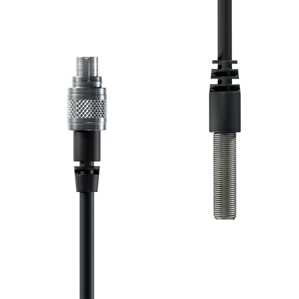

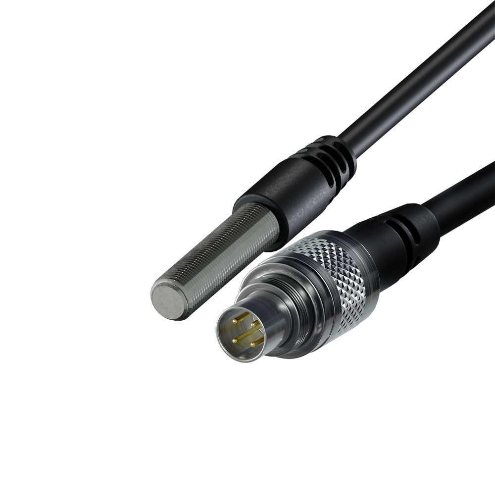

    Rear Speed Pick Up Sensor
    The AiM wheel speed non-contact sensor for MyChron Displays.
    Key Features:
    • 712 4 pin male connector
    • Speed Sensor
    • Magnetic
    • Free Race Studio 3 download
    Rear Speed Wheel Sensor
    The Aim axle rear speed pickup sensor is suitable for use with the MyChron 6 and MyChron 6 2T, as well as our older MyChron Kart Dash/Data Logger models.
    The rear axle speed sensor has an M10 thread and is supplied with nuts to be mounted on a bracket (not supplied).
    It is supplied with a magnetic trigger bolt and is to be installed at 3.5mm from the magnet.
    Aim Technologies are committed to supplying professional engineers with quality Motorsport products. Our cables and accessories are well-engineered and designed for demanding motorsport applications and the demands that racing puts on components. Which makes ours amongst the best in the marketplace today.
    Unlock your potential
    Our mission is to help educate you and enable you to get the most out of your Aim data equipment… whether you are new to racing or a seasoned professional, there is always something new to learn.
      Aim Axle Rear Speed Pickup Sensor
      Sensor Electrical Characteristics:
      • Power Tension: 6-24 VDC
      • Power Supply: 13.5 mA
      • Output Signal Type: Pulse 0-5 volt
      • Max Current Output: 20 mA
      • Max Operating Frequency: 100kHz
      • Max Sensibility Distance: 20mm
      • Recommended Distance: 10mm
      • Number of Pulses for Wheel Revolution: 1
      Sensor Mechanical Characteristics:
      • Operating Temperature Range: From -20 to +85° C
      • Cable Length: 1700mm
      Whats In The Box
      • Rear Speed Wheel Sensor
      • 3 Nuts
      • 1 Screw
