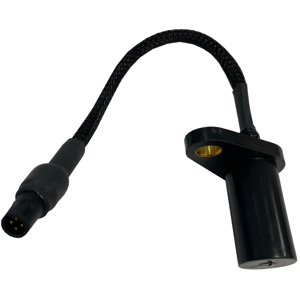

    The Aim Hall Effect Sensor is a non-contact device that needs a metallic trigger to pass in front of it.
    Hall effect wheel speed sensor
    4 pin 719 binder connector
    Aim M12 Hall Speed Pickup 719 Binder
    The Hall Effect Sensor is a non-contact device that needs a metallic trigger to pass in front of it. Again, a bracket will usually need to be fabricated to mount the sensor in a suitable position. Would you please ensure that the distance between the sensor and trigger is in a 0.5 – 2.0 mm (0.007-0.07 inches) range? Cable length is approximately 2.0m. A higher-quality Honeywell ABS hall effect sensor is also available.
    The 719 connection will suit the MXL2, all MX Series including Strada. Use with 719-719 patch lead.
    Aim Hall Effect Wheel Speed Sensor
    • Power supply voltage: 4.5-24 VDC
    • Current consumption: 10 mA (typical) 20 mA (max)
    • Output signal type: 0-5V
    • Max current output: 20mA
    • Max operating frequency: 100kHz
    • Sensibility distance: 0.5 to 2mm (from 0.007 to 0.07 inches)
    • Recommended distance: 1mm
    • Operating temperature range: from - 40 to 150°C (from 104 to 302F)
    • Cable length: 80mm
