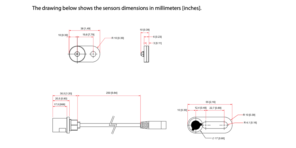

The Aim Non-Contact Brake/Accelerator Pedal Position Sensor works by using a magnetic sensor to measure the movement of the pedal without any physical contact between moving parts. A small magnet is mounted to the brake/accelerator pedal, while the sensor itself is fixed to the kart chassis.
As the pedal moves during braking or acceleration, the distance between the magnet and sensor changes, allowing the system to accurately calculate pedal travel. The sensor then sends this data to the Aim MyChron data logger, where pedal position is displayed and logged. This allows drivers and teams to analyse braking input, consistency, trail braking, and pedal usage throughout a lap.
  • The sensor comes with a 25cm cable with a 4-pin 719 male connector
  • Binder Connection Pin:
  • 1 - Analogue signal 0-5V
  • 2 - GND
  • 3 - Not Connected
  • 4 - V reference (4.5V)
  • 1 150cm patch lead - 4-pin 719 female to 712 male
  • 1 magnetic bracket
  • 1 L bracket
  • 2 washers
  • 1 M6 x 16 Allen screw
  • 1 nut
