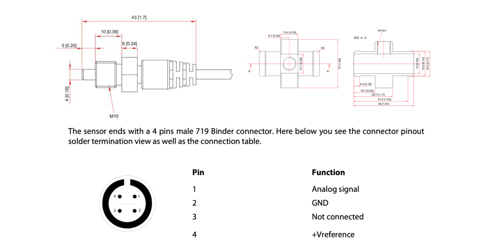

The Aim water temperature sensor/thermoresistor can measure and sample water temperature, providing accurate readings. With a temperature range of 0-150°C, a cable length of 25cm, a 4-pin 719 male binder connection, and an M10 thread most commonly found on Rotax, X30 and OK engines, this professional water coolant temperature sensor is of the utmost quality and technical grade for accurate readings.
Please Note: This water temperature sensor cannot be used in a car, as there would not be a resistor in place between the 5V and the analogue input. The result would be no voltage at the analogue input, and hence no temperature.
Why Choose the Aim Water (Coolant) Temperature Sensor
The Aim PT100 water (coolant) temperature sensor is for use with all MyChron kart lap timer/data loggers, such as the MyChron 6 and the older generation MyChron 5 & 4 models. The sensor can measure and sample water temperature, providing the most accurate readings.
The thermoresistor should be in the cooling system/oil sump. It is recommended to install the sensor away from heat and electromagnetic interference sources like the RPM or lap receiver cables.
