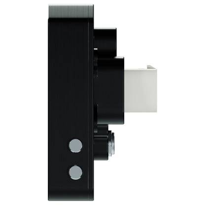

AiM MXP Strada 6" TFT Dash Display with Road Icons
The MXP Strada IVA compliant digital dash display is a complete road legal display solution.
6" TFT display Road legal & MOT approved
CAN output Configure data
The MXP Strada features a 6" wide colour TFT display, offering a fantastic visual impact. It is configurable to show data coming from the ECU, nine axes inertial platform (accelerometer, GYRO and magnetometer). Eight analogue inputs, six digital inputs, pre-defined math channels, a second CAN and an optional GPS Module.
Connecting the MXP Strada dash to your ECU is simple. You can sample and display dozens of channels straight from the vehicle ECU. This is usually the quickest and easiest setup, needing only 2 cable connections to the ECU instead of multiple connections to analogue sensors.
The dash comes with a  23 pin loom which has pre-configured connections for all the relevant electrical items in your vehicle such as oil. temperature, engine temperature, fuel level, sidelights, hazards, front and rear fog, handbrake, main beam, dipped beam and left and right-hand indicator. A speed sensor is also included in the kit to connect to this additional loom.
  • Display: 6" TFT
  • CAN Connections: 3
  • Second CAN: Yes
  • Body: Anodized Aluminium
  • Pushbuttons: Metallic
  • Power Consumption: 400 mA
  • Weight: 590g
  • Waterproof: IP65
  • MXP Strada
  • 23 IVA Loom
  • Wheel Speed Sensor
  • AiM Sticker
