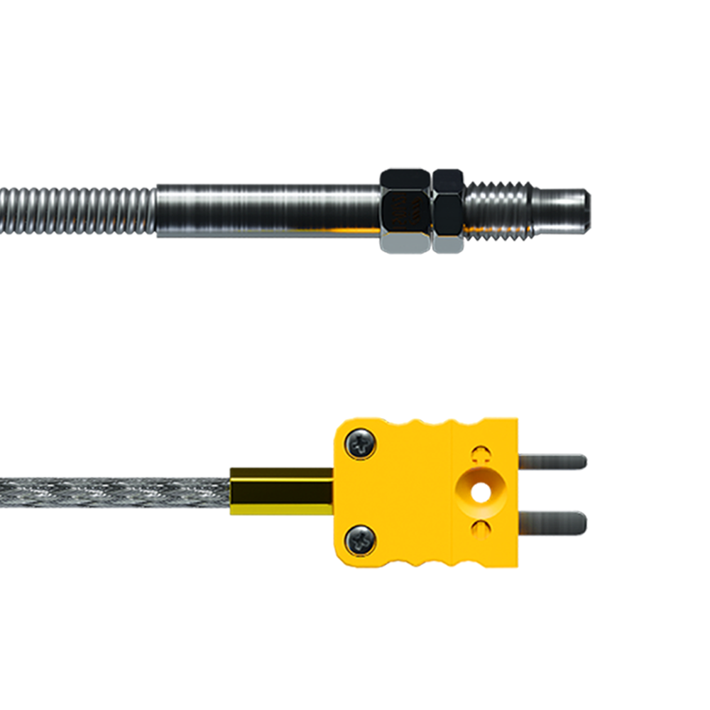

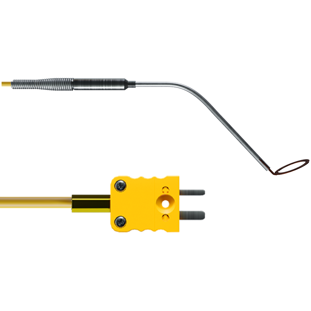

- A cylinder head temperature thermocouple and an exhaust gas temperature (EGT) thermocouple to accurately measure the EGT, which can both be fitted to the provided dragster thermocouple split cable.

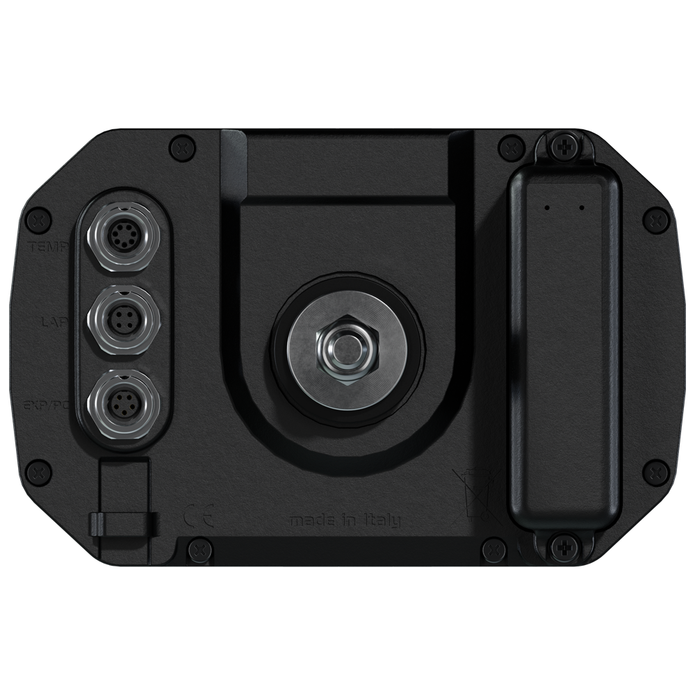

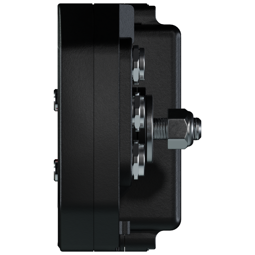

It’s important to install your MyChron5 660 data logger in a place where you and mechanics can see the display while the dragster engine is being worked on. We recommend underneath the engine ON/OFF switch. To install the MyChron5 660, fix a bracket to the vertical bulkhead and then fix the logger to the bracket.
An RPM wire needs to be connected to the dragster ON/OFF switch. The switch is, in most cases, 2 poles (some switches are only 1 pole). The 2 poles are RPM and coil. RPM wire should be going to the coil side of the kill switch. Running it to the grounded side of the switch causes the RPM signal to drop in and out and sometimes not to work at all. Bring the ON/OFF switch opposite the bulkhead, drill a 0.2” (5mm) hole inside the bulkhead and remember to insert the rubber wire-holder in the hole to protect the RPM wire from tears and cuts. The RPM sampling frequency is 50Hz.

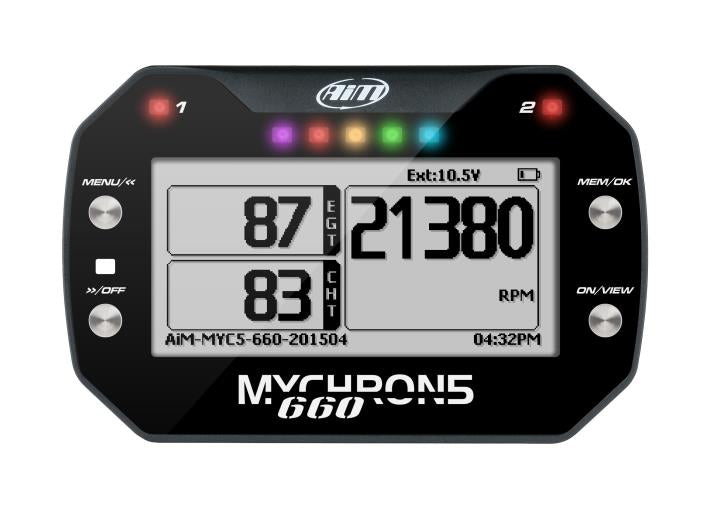

The MyChron5 660 features a high-contrast LCD screen, offering great flexibility and readability while you drive. Choose from 8 configurable RGB backlight colours to suit your requirements. The ambient light sensor switches the backlight ON/OFF according to the ambient light conditions. The MyChron5 660 has 2 RGB alarm LEDs. You can set these to work as a temperature alarm.
Keyboard & Display Configuration
The MyChron5 660 has 4 metal, easy-to-use push buttons. This system has been designed to make the configuration of your display as easy as possible. You can configure the LCD set-up, drive set-up, RPM set-up, and units of measure. You can check that all sensors and expansions are connected and are in working order, and also know the number of recorded test sessions you have completed. Set the date and time and configure your Wi-Fi.

Cylinder Head Thermocouple
Exhaust Gas Thermocouple
