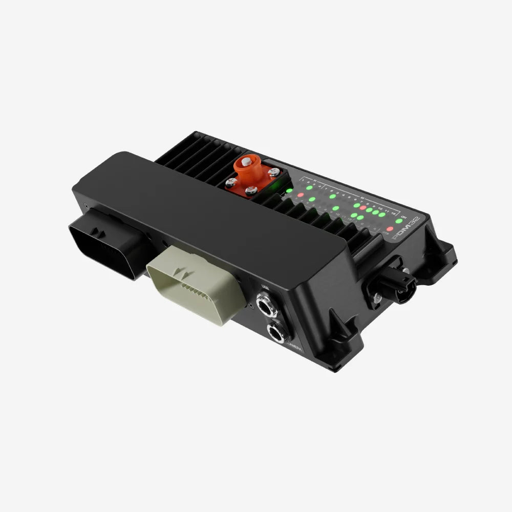

The Aim PDM32 is a 32-channel advanced power distribution module designed to power a multitude of vehicle circuits, removing the need for traditional fuse boxes and relays. It allows for a simplified wiring harness with increased reliability and control functions.
Why Choose the PDM32
The PDM32 is available on its own or with a choice of 5", 6" or 10" dash displays. It also capable of receiving data from the vehicles ECU and even includes a data logger and GPS module for lap timing and track mapping.
With a total continuous max current of 120A, each of the outputs provides feedback to the data logger to provide vital information such as open circuits, short circuits, high/low voltage, the number of fault reties and the time between the reties is user definable. All outputs can be configured as PWM's for a soft start/stop. All of the PDM circuits can be set up and monitored via the Race Studio 3 software.

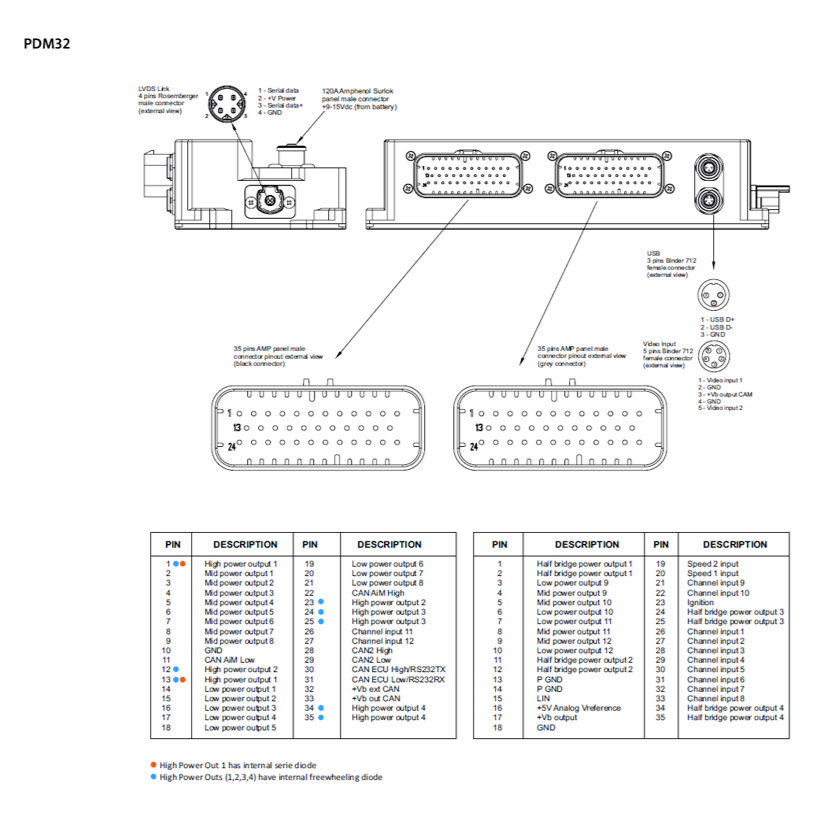

Grey & Black 35-Pin Plug & 70 Gold Pins
CAN Expansion Cable
SurLok Power Connector
Download Cable
