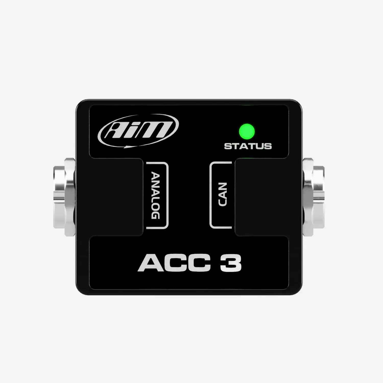

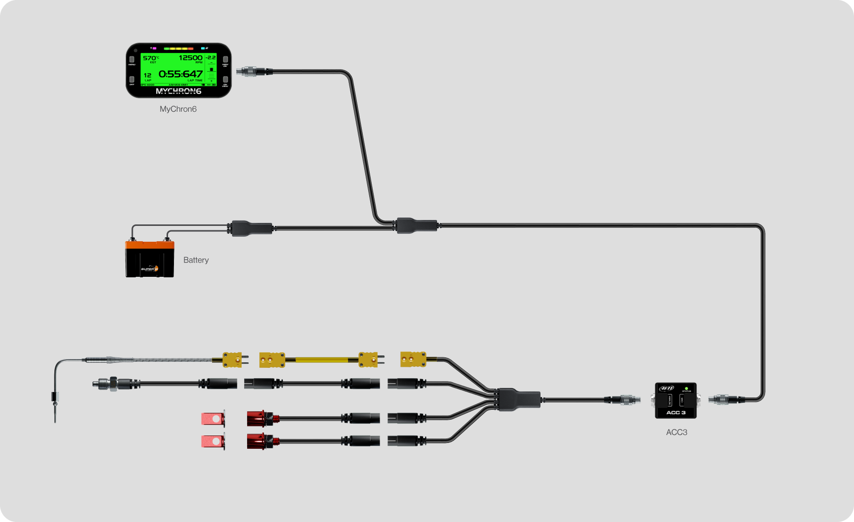

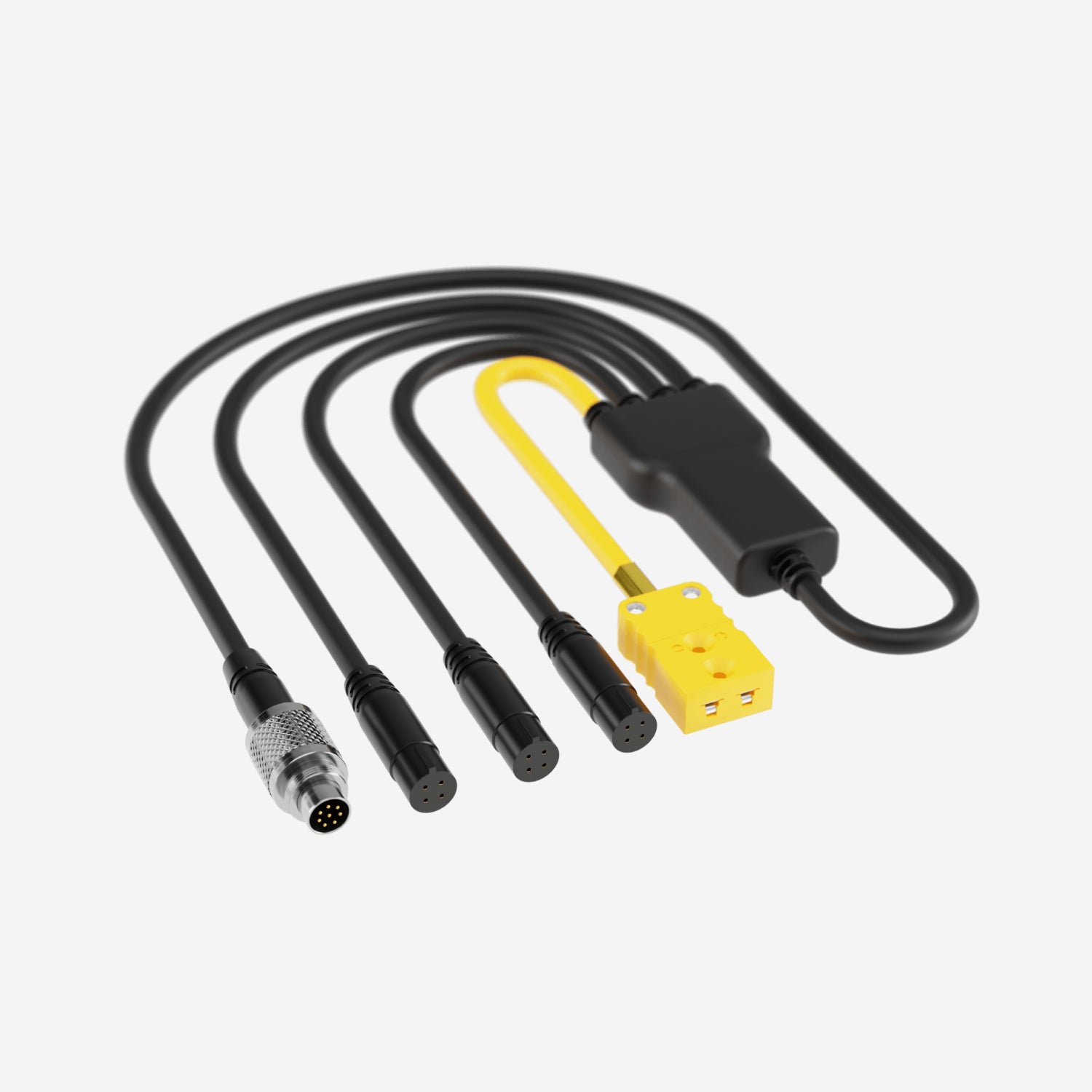

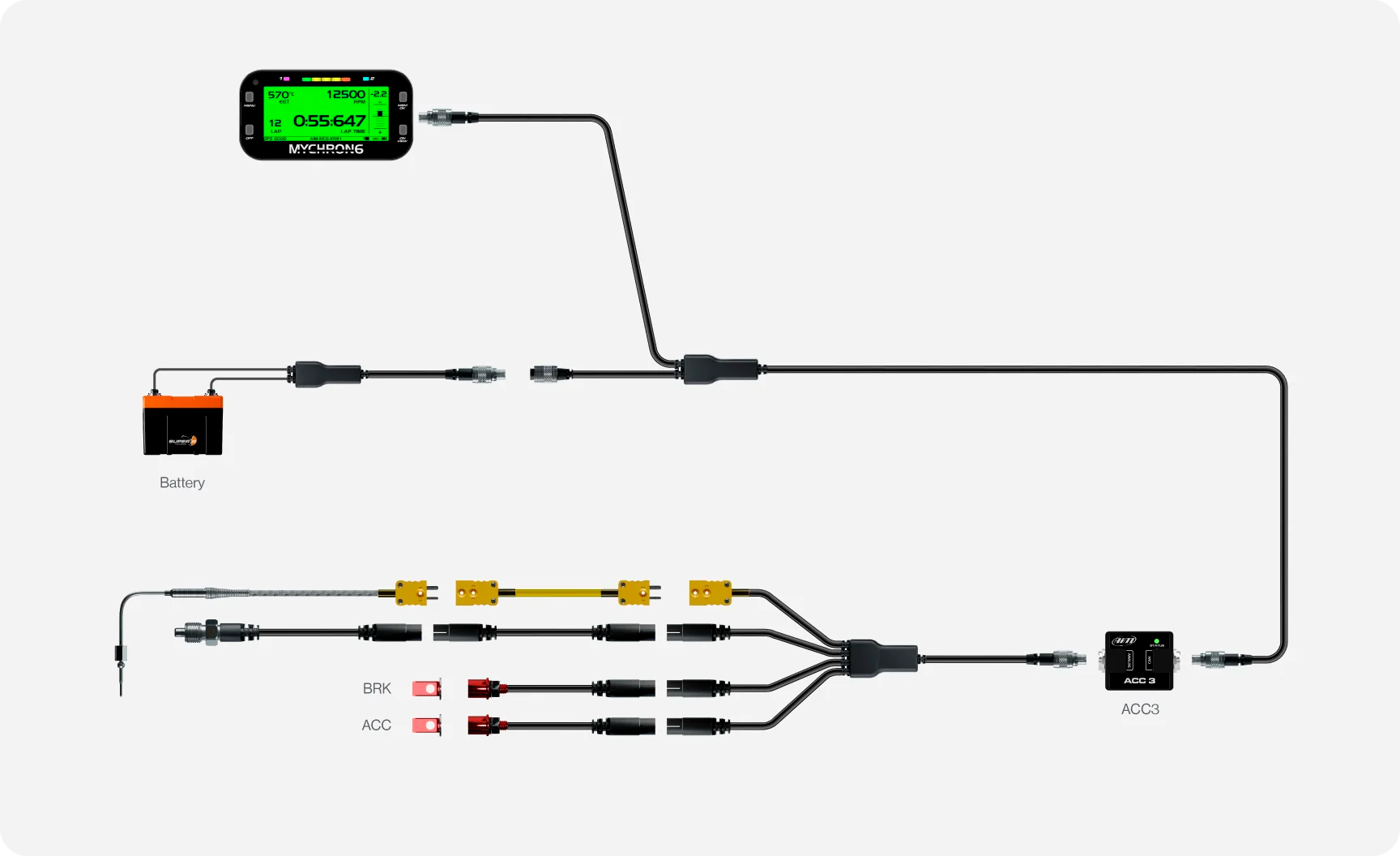

The kit includes the MyChron 6 display and logger, ACC3 Analogue CAN Converter, and split harnesses for integrating additional sensors including EGT, throttle position, brake/position, and water coolant temperature monitoring.

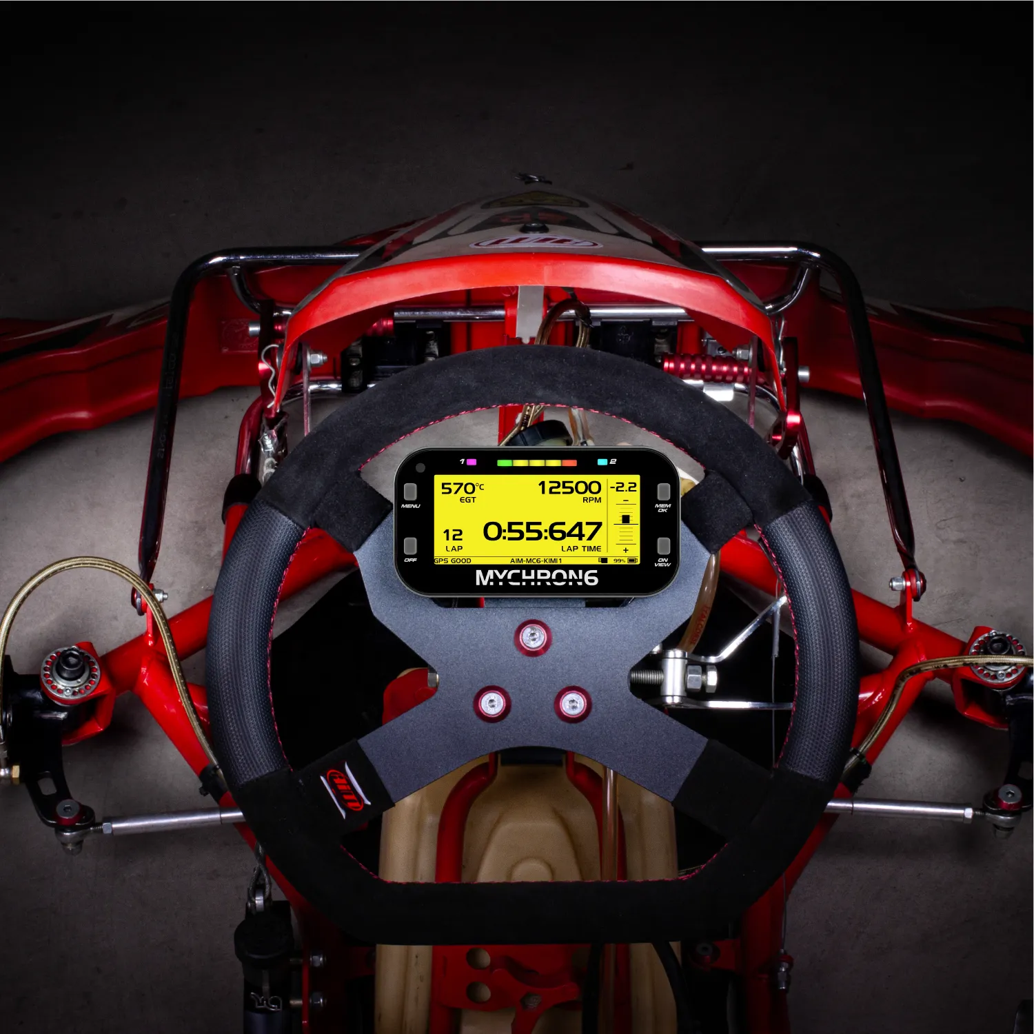

MyChron 6 Club Kit Setup on Kart
Why Choose the MyChron 6 Club Kit
The MyChron 6 Club Kit helps drivers move beyond lap times, showing exactly what the kart and driver are doing on track. By combining sensor data with GPS timing and RPM logging, drivers can identify where time is being lost, improve consistency, monitor engine health, and make more informed setup changes.
Ideal for practice, testing, and club competition, the system helps accelerate driver development while also protecting engine performance and reliability.
Sensor Integration
Using the included ACC3 Analogue CAN Converter, the MyChron 6 can record multiple sensor inputs simultaneously alongside GPS timing, RPM, speed, and track mapping. This creates a complete picture of both driver inputs and engine behaviour throughout every lap.
The modular design also allows drivers to tailor the system to their specific class, engine package, and performance goals.

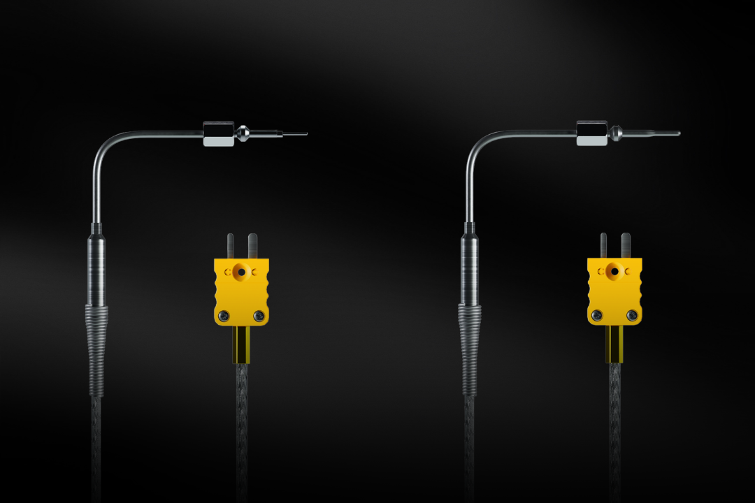

Exhaust Gas Temperature (EGT) Sensors
EGT sensors provide valuable insight into engine performance and tuning, particularly in 2-stroke kart engines. Monitoring exhaust temperature helps drivers identify lean conditions, improve carburettor setup, and maintain more consistent engine performance throughout a session.
EGT monitoring is also an important safeguard against overheating and potential engine damage.

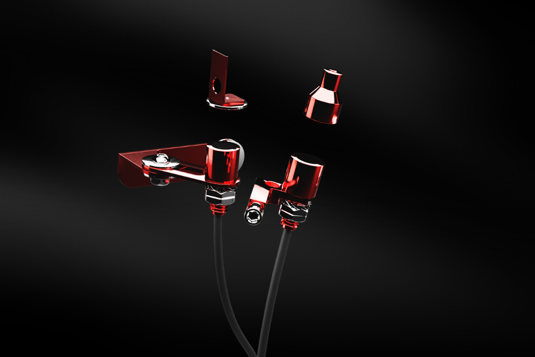

Throttle position sensors
Throttle Sensors
Throttle position sensors allow drivers to analyse throttle application throughout the lap. This makes it easier to identify hesitation on corner exits, unnecessary lifting, or inconsistent throttle usage in high-speed sections.
By comparing data between laps, drivers can develop smoother, more confident, and more repeatable driving habits.
Position & Brake Sensors
Brake and position sensors provide detailed feedback on braking behaviour and driver inputs. Analysing brake traces can help drivers improve braking consistency, refine corner entry technique, and reduce unnecessary coasting or over-braking.
This data is especially valuable for developing repeatable lap times and improving overall performance.

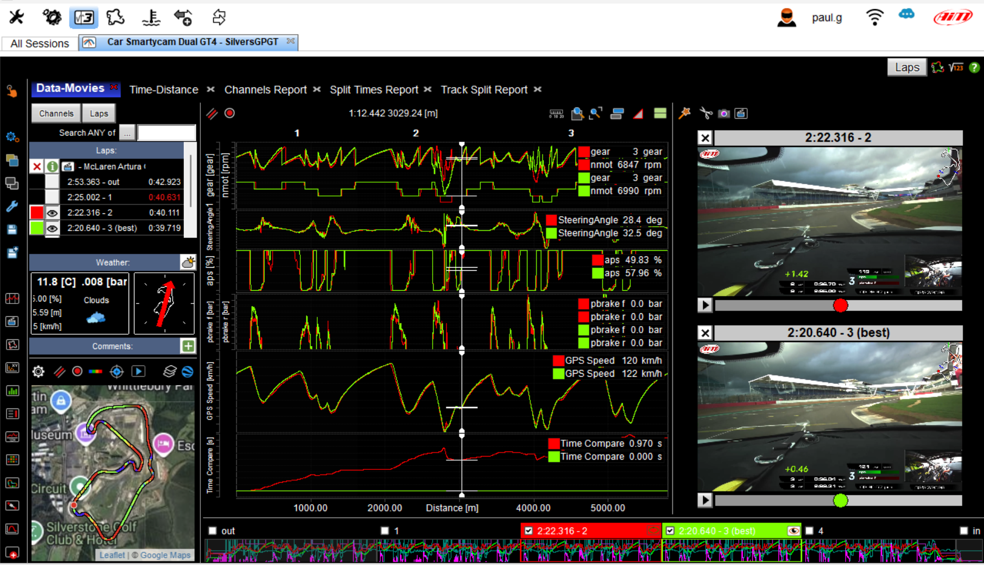

Data Analysis with Race Studio 3
All data recorded by the MyChron 6 and sensors can be analysed using Race Studio 3. The software allows drivers to review laps, compare driving inputs, analyse engine temperatures, and study GPS track maps in detail.
By turning telemetry into actionable insights, Race Studio 3 helps drivers understand performance differences and make smarter decisions both on and off the track.

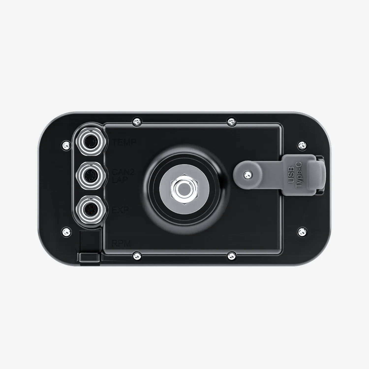

  • Connectors: 1 connector (binder) 712 fem 3 pins, 1 connector (binder) 712 fem 5 pins & 1 connector (binder) 712 fem 8 pins
  • USB Connections: For data download, mass storage support and battery charging
