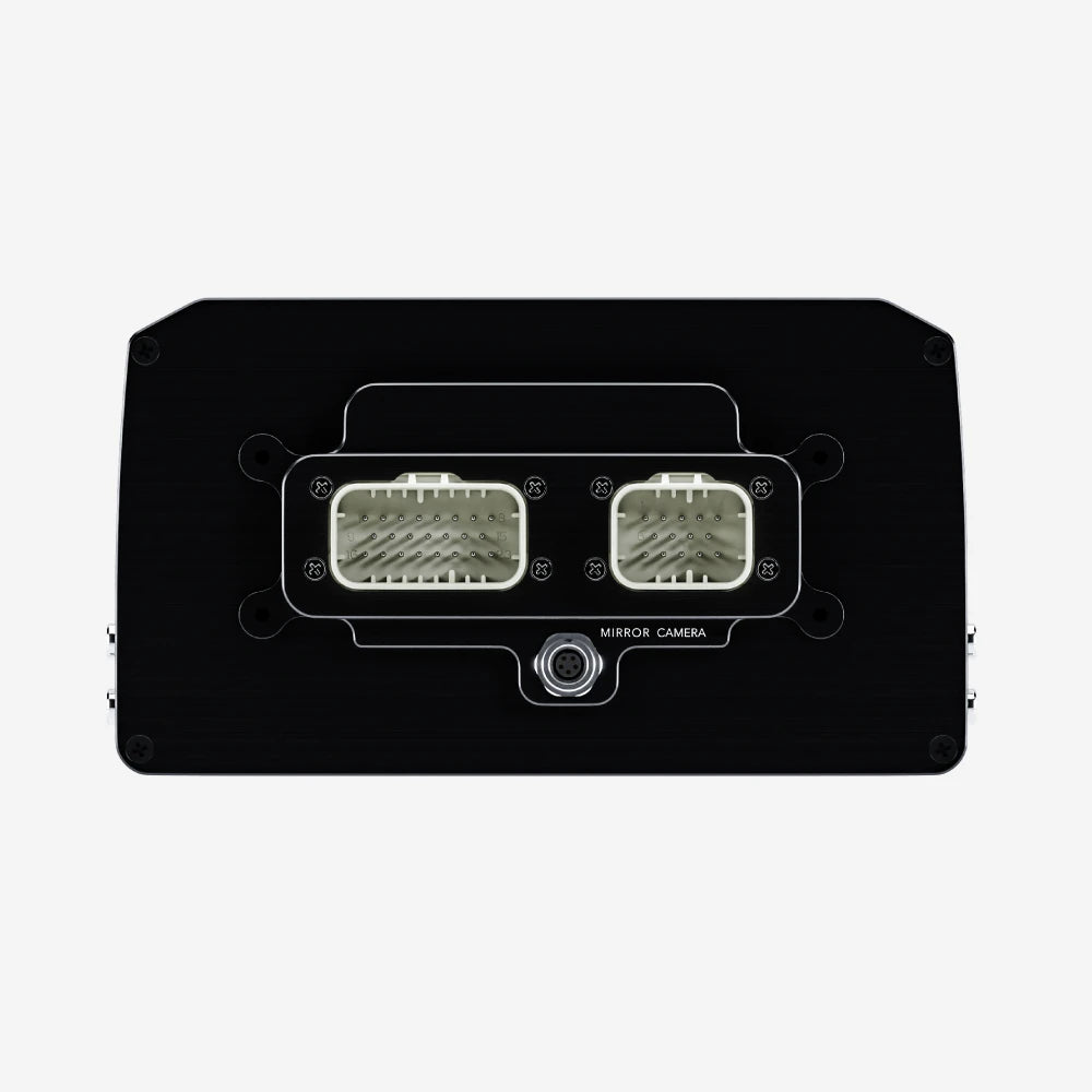

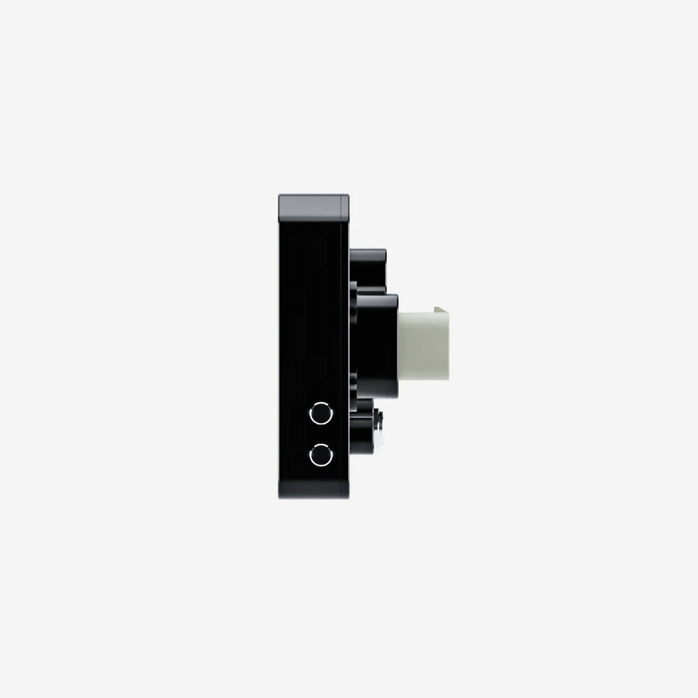

The MXP Strada with road icons is one of the most widely used dash displays on roads around the world. The MXP 1.3 Strada has a 6" colour TFT display that offers a great visual impact. You can configure the dash to show all the information coming from the motorcycle’s ECU, analogue/digital inputs, predefined math channels and an optional GPS Module.
The MXP Strada Display is an HD digital display, designed for motorcycle riders who need essential data visibility while on the track or road. The dashboard is tailored to show real time data such as speed, RPM and temperatures, but doesn't include data logging functionalities natively.

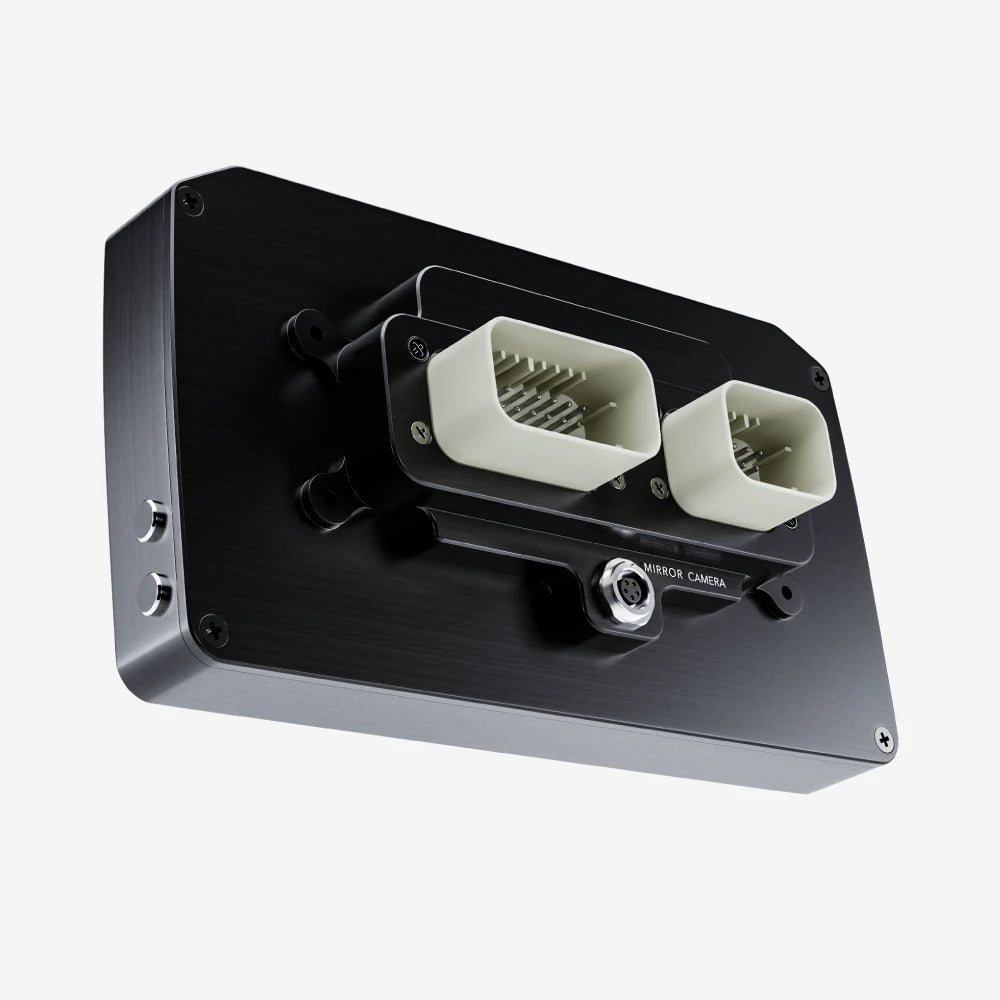

The MXP 1.3 Strada is available with a choice of connections. Choose either the OBDII or K-Line CAN, depending on whether you want to connect to the motorcycle’s ECU or OBDII port or directly to the ECU through the CAN channel.
Digital Outputs
The MXP 1.3 Strada features a 1-AMP digital output configurable to be activated/deactivated depending on the value of the analogue/digital inputs or on the impulses coming from the motorcycle’s ECU. This allows you to automatically run external systems, such as switching on/off additional lights, to activate/deactivate a cooling fan or circulation pumps when a certain event happens.
With CAN output, you can send messages directly to an existing CAN network to improve the range of the motorcycle’s control possibilities.

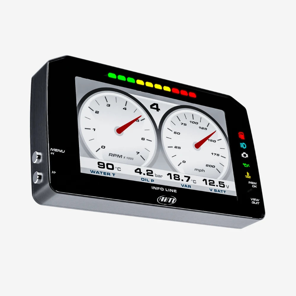

Display with Road Icons
The MXP 1.3 Strada has a 6" TFT high contrast colour display. The visual quality is optimised by the ambient light sensor, which keeps the backlight at the best brightness levels.

MXP 1.3 Strada
USB Cable
14-Pin Standard Wiring

The Aim MXP Strada is a digital dash display that can be configured to show real time information from the motorcycle's ECU, analogue/digital inputs, predefined math channels and an optional GPS Module. It provides crucial information like speed, RPM, water temperature, and oil pressure on a high-contrast TFT screen.
What size is the MXP display?
The MXP Strada comes with 5 customisable RGB LEDs, which are determined by inputs from the motorcycle's ECU or other sensors. The MXP Strada with road icons can be configured with alarms for direction lights, high beams, low beams, low fuel, low oil pressure, low oil level and other customised alarms that have been set.
