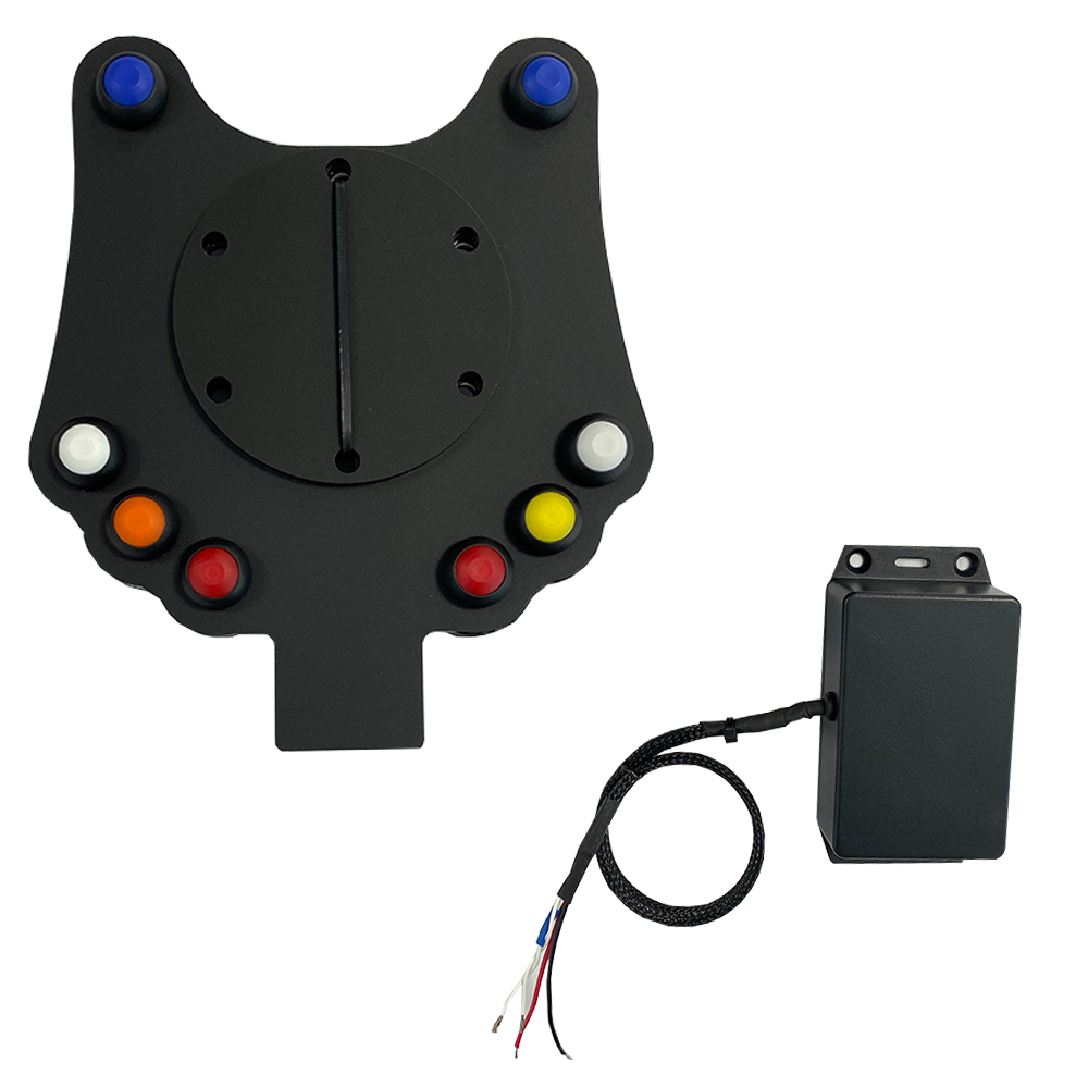

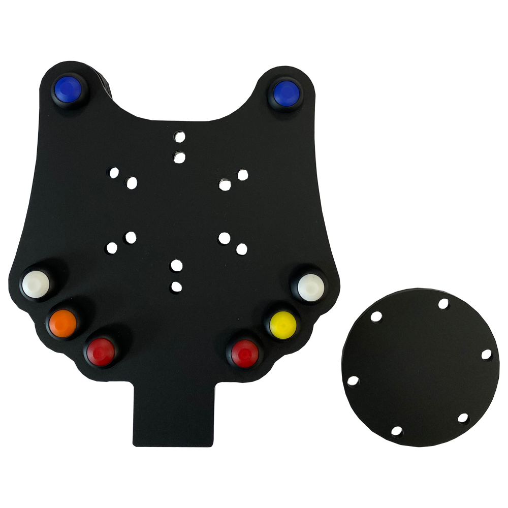

Race faster, harder and safer with push button controls at your fingertips. The 8 button wireless motorsport steering wheel plate combines minimum driver distraction with maximum ease of use.
Why Choose the 8 Button Steering Wheel Plate
The 8-channel wireless system allows you to have push button controls at your fingertips, whether you have a detachable steering wheel or would like to avoid the need for an unreliable coiled wire connection from your steering wheel to the dashboard.
8 Momentary Push Buttons
Wirelessly implemented, the in-vehicle commands are executed in a fraction of the time with 8 digital push buttons, ideal for features such as lights, horn or engine start.

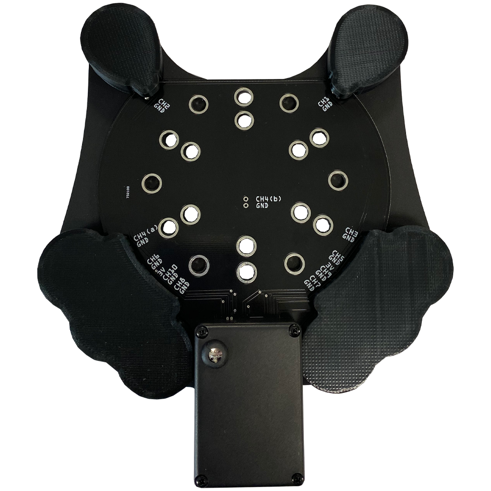

The steering wheel plate is lightweight and integrates with most CAN devices, including dashboards, ECUs, PDUs and dataloggers, and has been tested to withstand the harshest EMI that can be generated within your car.

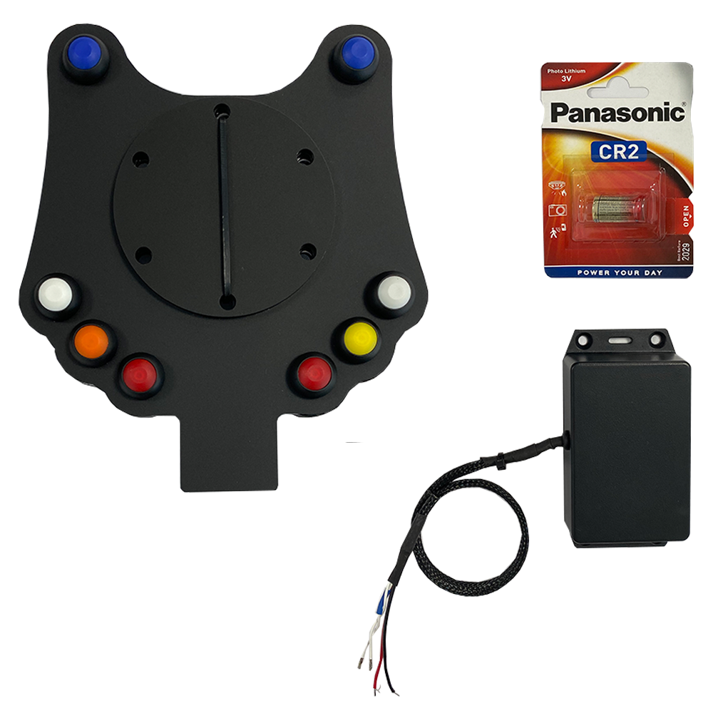

Battery Life
The 8 button wireless steering wheel plate has a standard CR2 lithium battery with a guaranteed life of 3 years or 50,000 miles, so you don't have to worry about the battery going flat.
The battery voltage is regularly transmitted to the CAN receiver with the intelligent system, and then forwarded to the Aim device that gives you around 30 days notice if the battery needs to be replaced.
Using our PDM systems and Race Studio 3 software will allow you complete control and behaviour of the momentary push buttons to act as simple latching switches or more complex management.

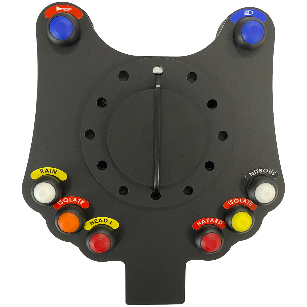

Optional Stickers
Upgrade your wheel plate with adhesive stickers; pre-cut and hard-wearing and professionally printed. They are easy to apply and add a professional finish to your wheel plate.
Please Note: Images showing the steering wheel are for illusion purposes only. The steering wheel is not included. The stickers are also for visual display to show how the wheel plate could look. Please see the accessories tab to purchase stickers.
Button Plate Front
  • Matte black, textured acrylic
  • Dimensions: 176 x 154mm
Battery
  • Housing: ABS-UL94-VO
  • Dimensions: 54 x 38 x 23mm external
  • CR2 lithium battery
  • 50,000 miles of active use
  • Push Buttons: IP67 waterproof
  • Assembly: 8-channel, 265g
