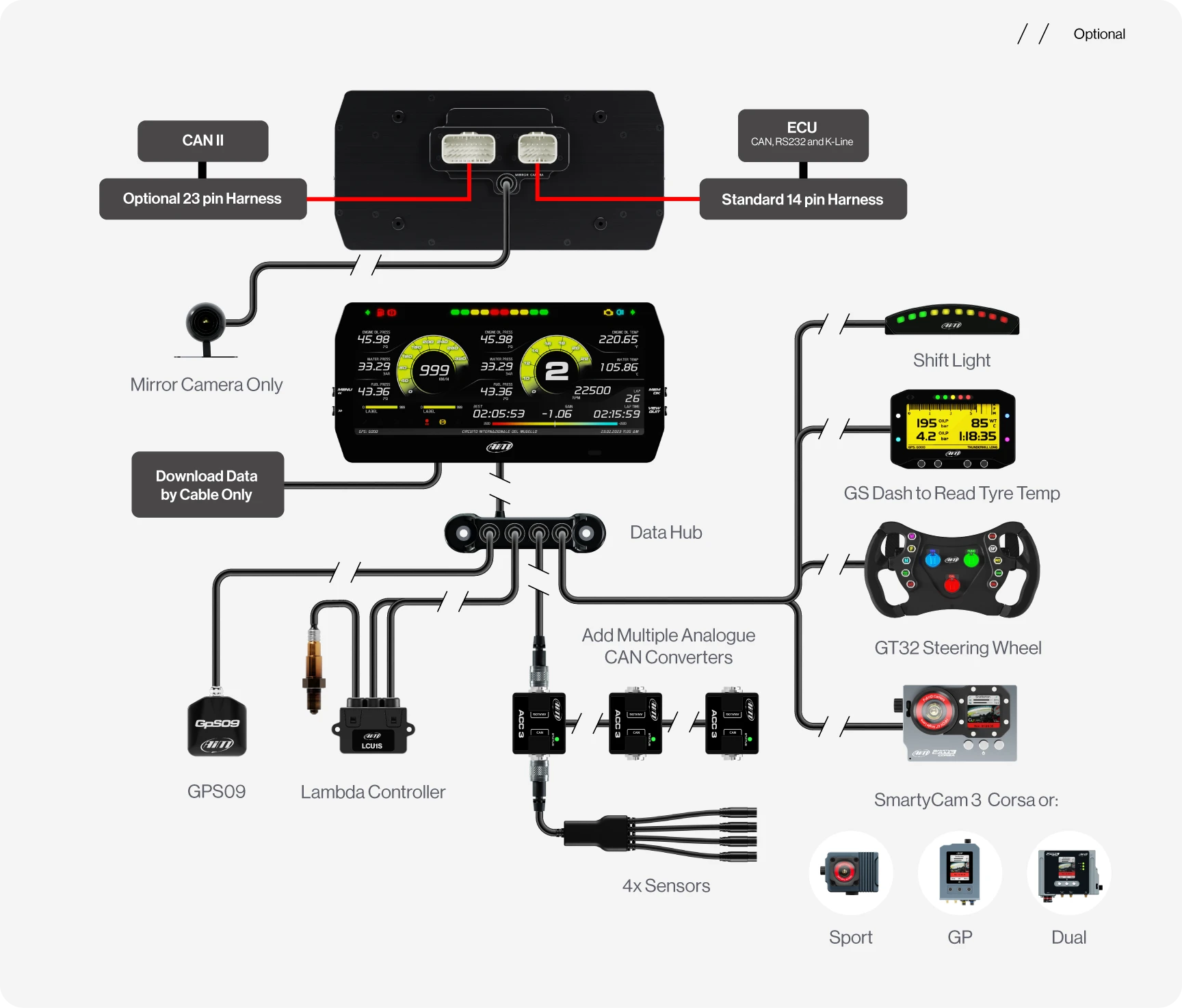

The MXT Strada with road icons is one of the most widely used dash displays on roads around the world. The MXT 1.3 Strada has a 10" colour TFT display that offers a great visual impact. You can configure the dash to show all the information coming from the ECU, analogue/digital inputs, predefined math channels and an optional GPS Module.
The MXT 1.3 Strada is available with a choice of connections. Choose either the OBDII or K-Line CAN, depending on whether you want to connect to the car's ECU or OBDII port or directly to the ECU through the CAN channel.
You can sample and display dozens of channels straight from the car’s ECU with only 2 cable connections to the ECU instead of multiple connections to analogue sensors. The sampled data depends on the actual ECU, but will typically include RPM, throttle position (TPS), oil, air, water temperature, oil pressure, battery voltage, speed, gear, and lambda value (air/fuel ratio). The list of available ECU drivers is over 1,000 and is constantly being updated.

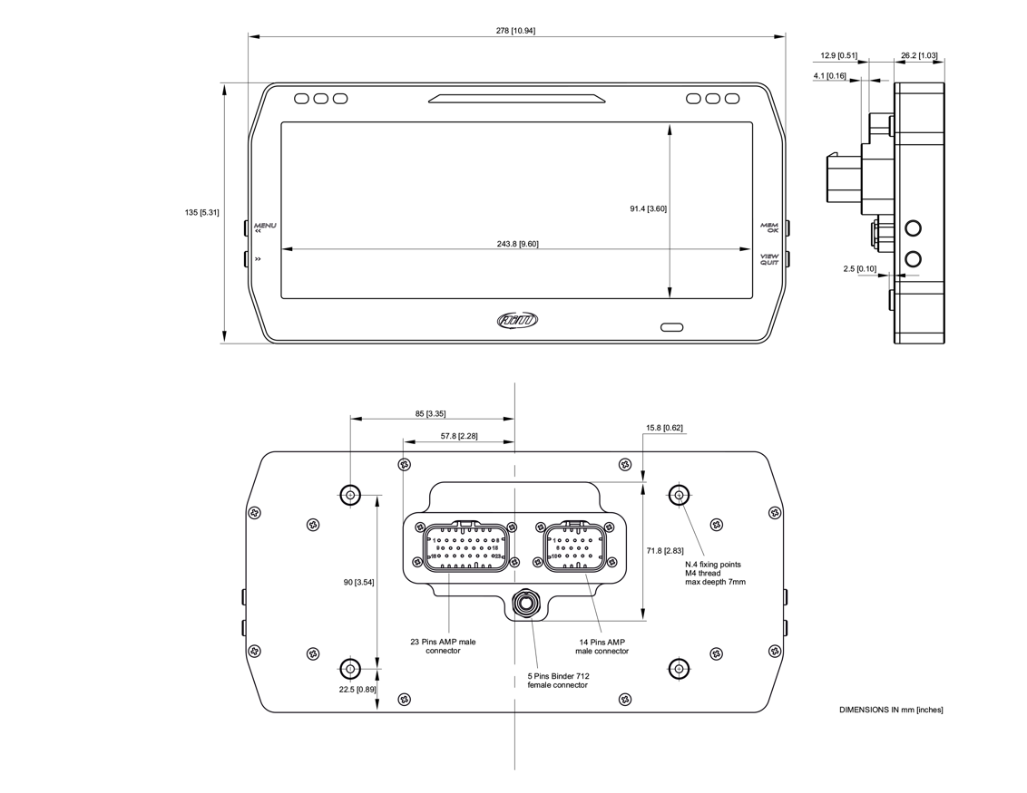

The MXT 1.3 Strada has a 10" TFT high contrast colour display. The visual quality is optimised by the ambient light sensor, which keeps the backlight at the best brightness levels.
