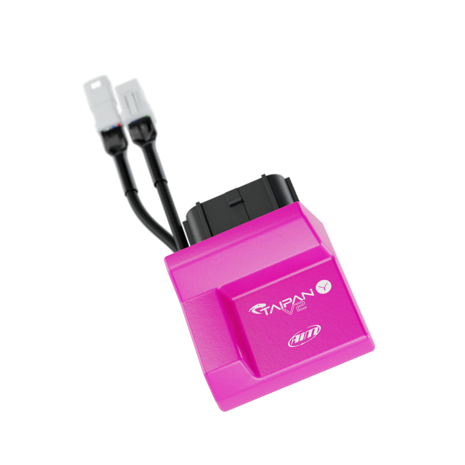

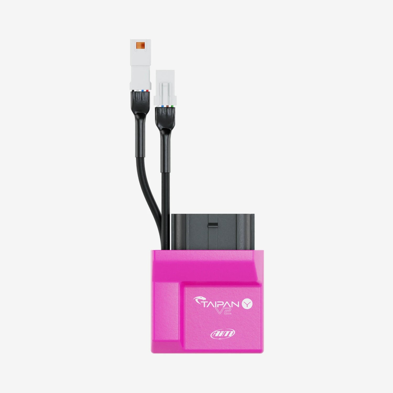

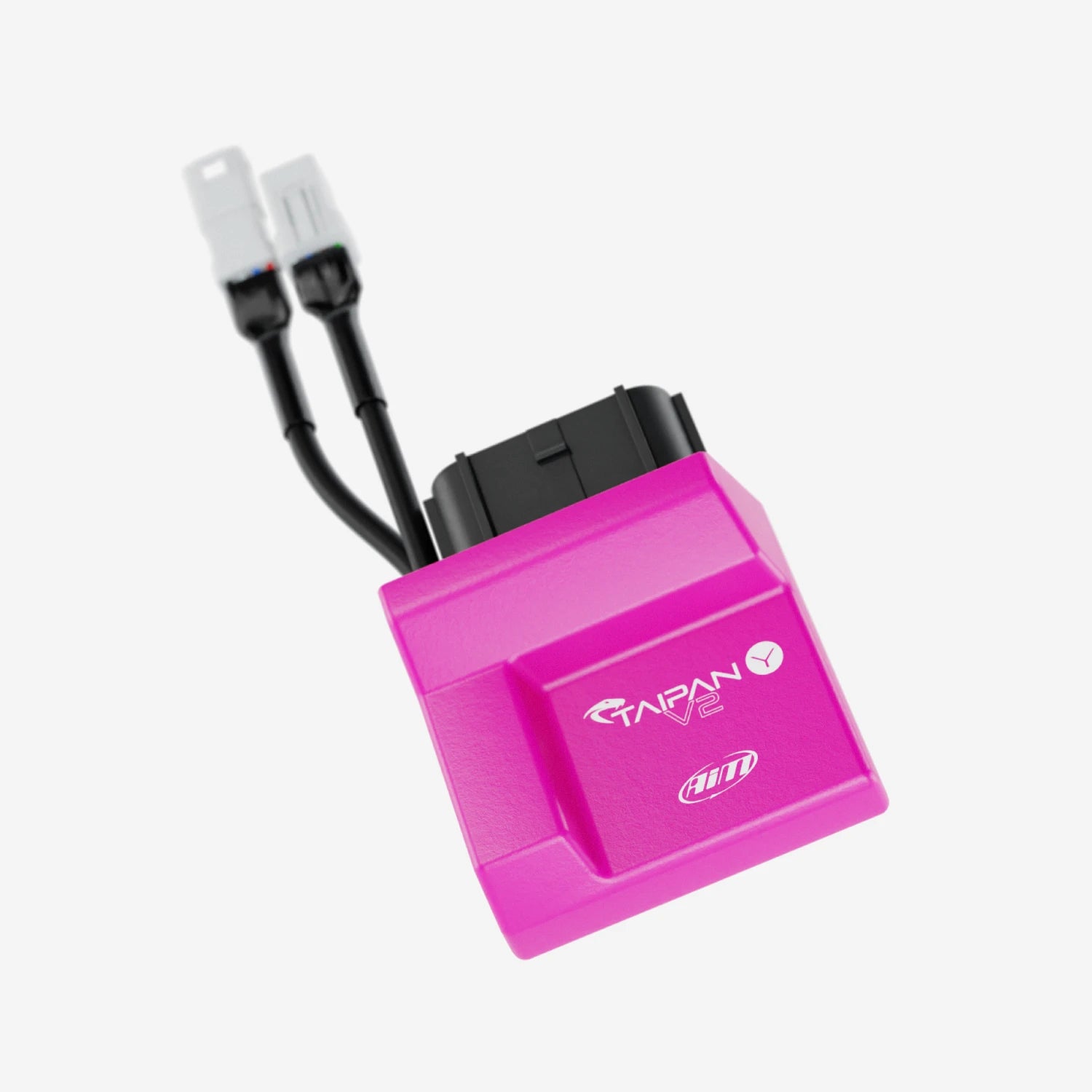

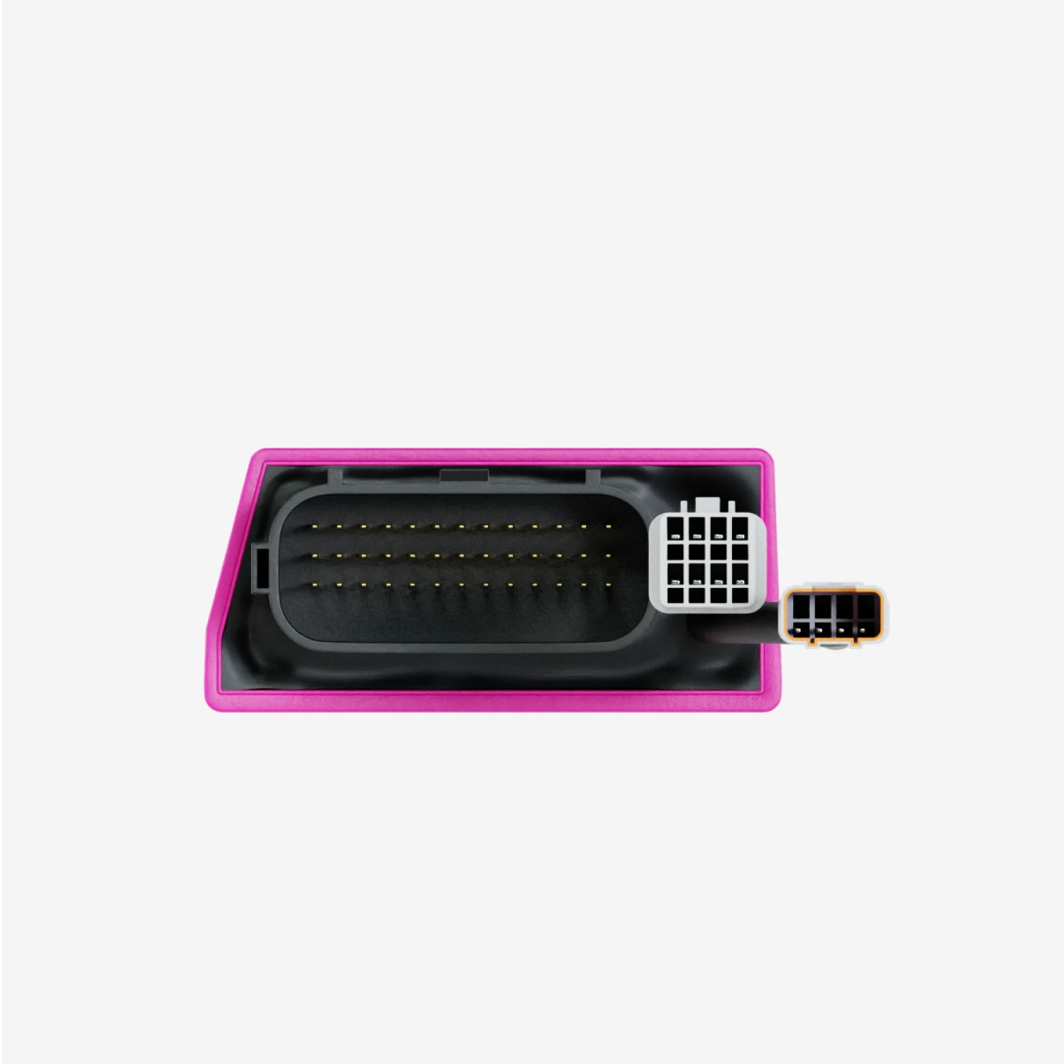

The Taipan Y V2 ECU is an aftermarket plug & play engine control unit created by Aim, exclusively designed for plug & play installation with Yamaha YZ250F and YZ450F motocross bikes (2024-2025).
Why Choose theTaipan Y V2 ECU
Thanks to its high-technology 32-bit core, the Taipan Y V2 ECU represents an important step forward to improve the performance of your motocross bike, without sacrificing reliability and smoothness.
Engine control requires precision. At 20,000 RPM, the Taipan Y V2 ECU guarantees precision of 1/10 of a degree: this means an accuracy within 0.8 microseconds (µs) for turning the spark ON.
This precision is the key to guarantee:
- A very consistent engine rotation.
- The possibility of repeating dozens of tests at the bench, always obtaining the same result.
- A perfect reactivity at every minimum change of any point of a map, resulting in more power at the wheel.

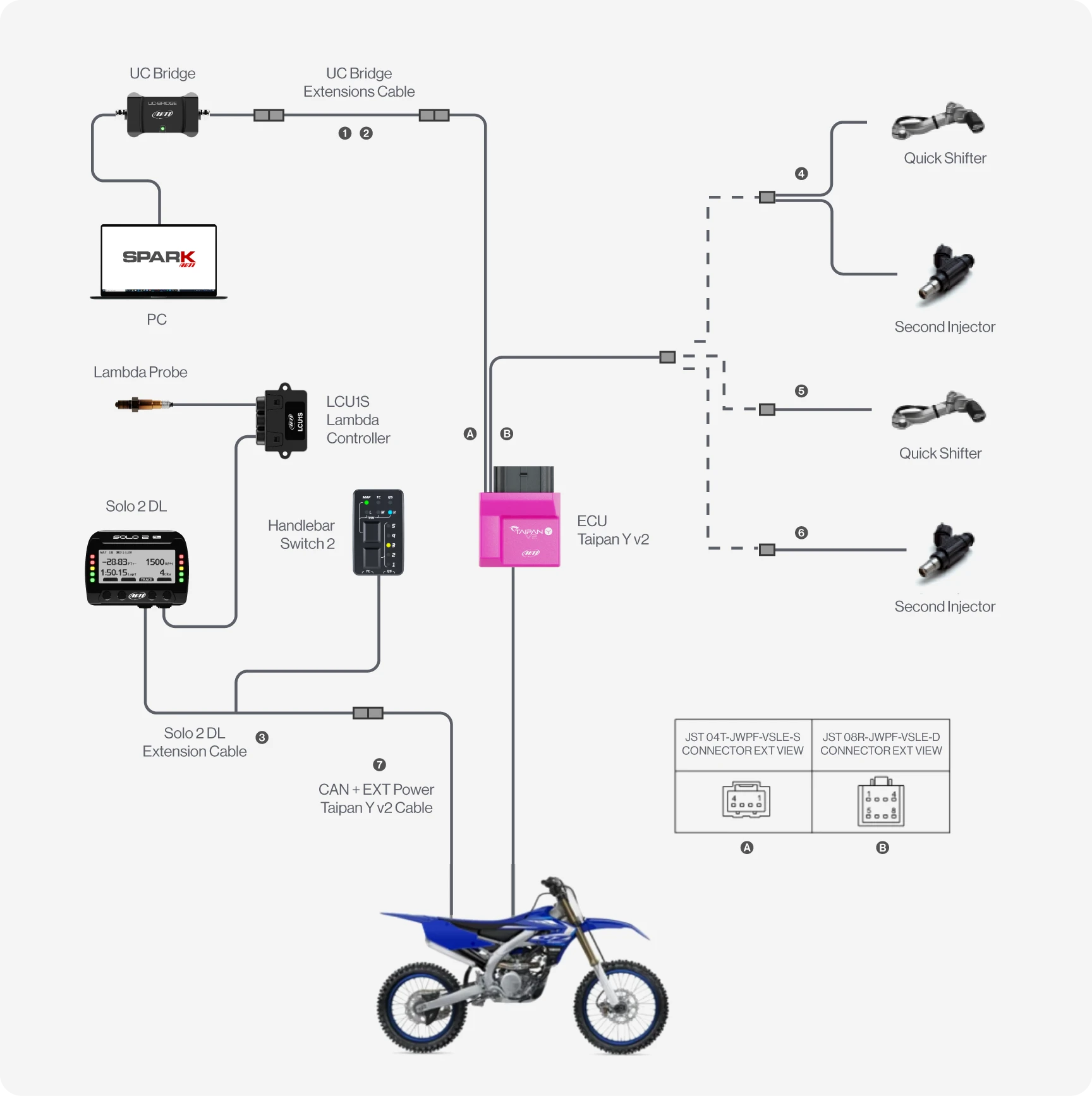

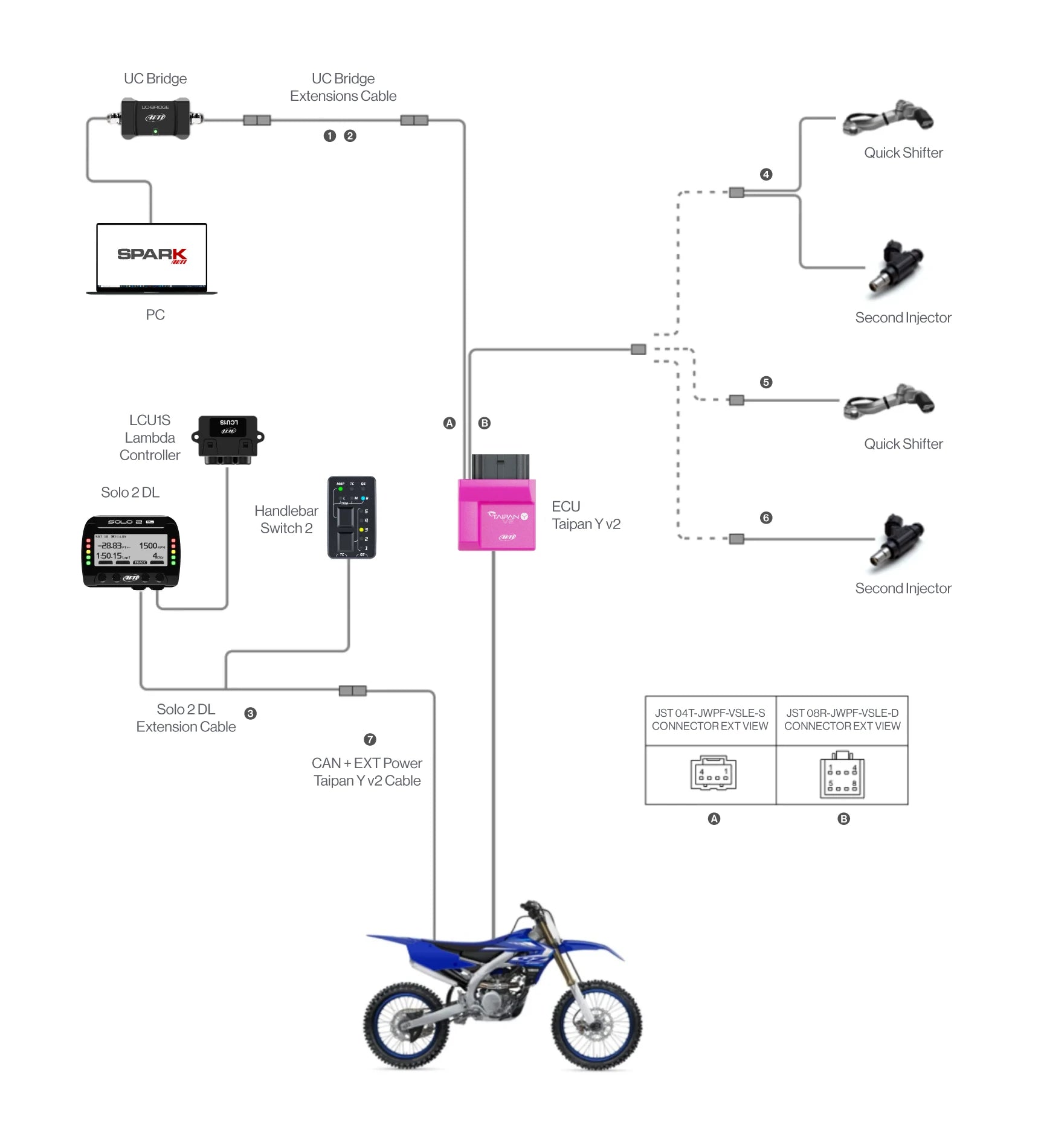

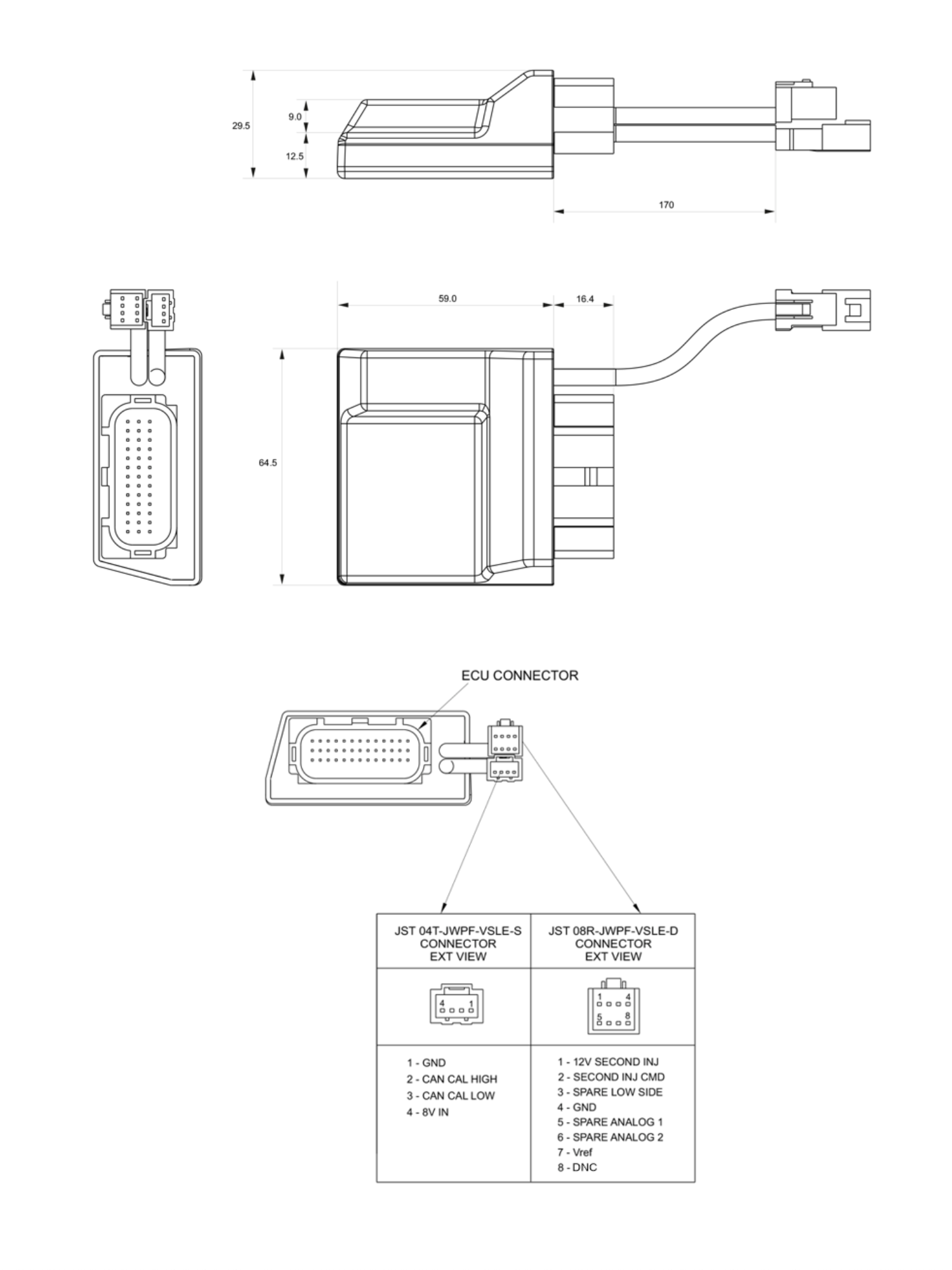

Taipan Y V2 ECU Connections

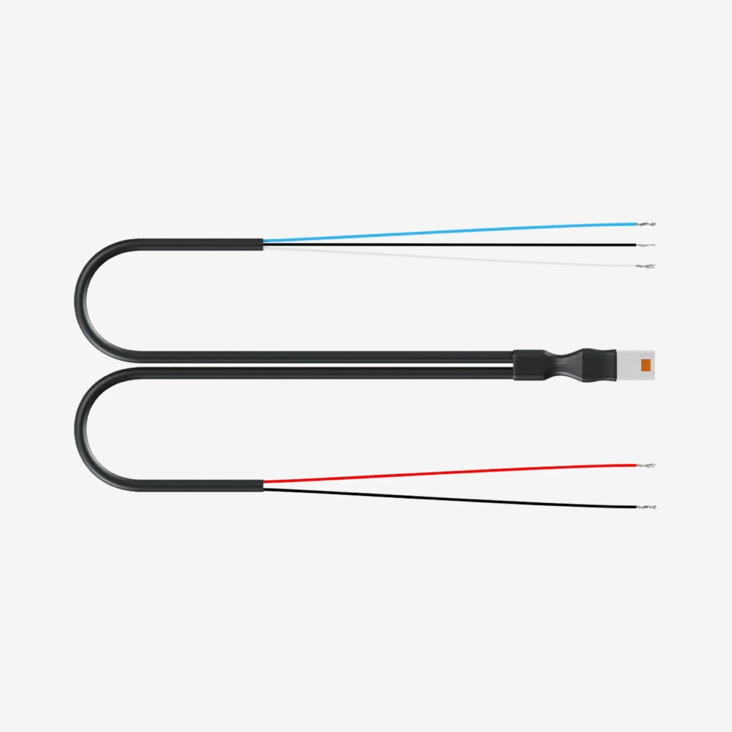

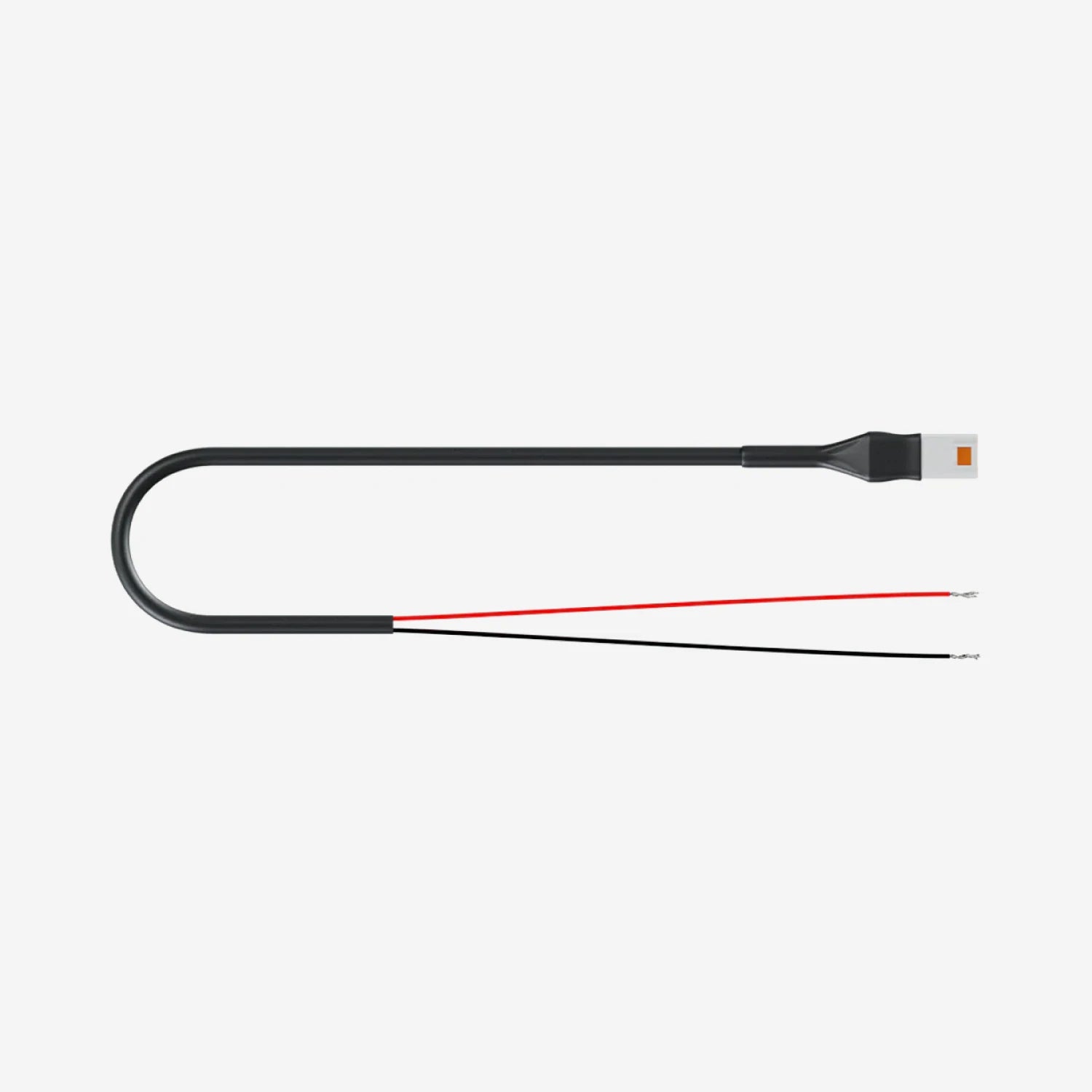

The Taipan Y V2 ECU has 4 connectors:
- Main Connector: Compatible with most off-road bikes.
- CAN Connector: Connects to the Handlebar Switch 2 and data logger.
- 2nd CAN Connector: Connects to the UC Bridge to communicate with the PC.
- 3rd Connector: Connects to spare analogue inputs and a possible second injector.
Handlebar Switch 2
The Aim Handlebar Switch 2 is the best way to change the behaviour of your motocross bike. It features 4 push buttons, 11 integrated LEDs, and manages the following settings:
- Up to 5 selectable maps
- Apply fuel corrections
- Activate traction control
- Activate launch control
The Handlebar Switch 2 can also be used as a shift light module.
