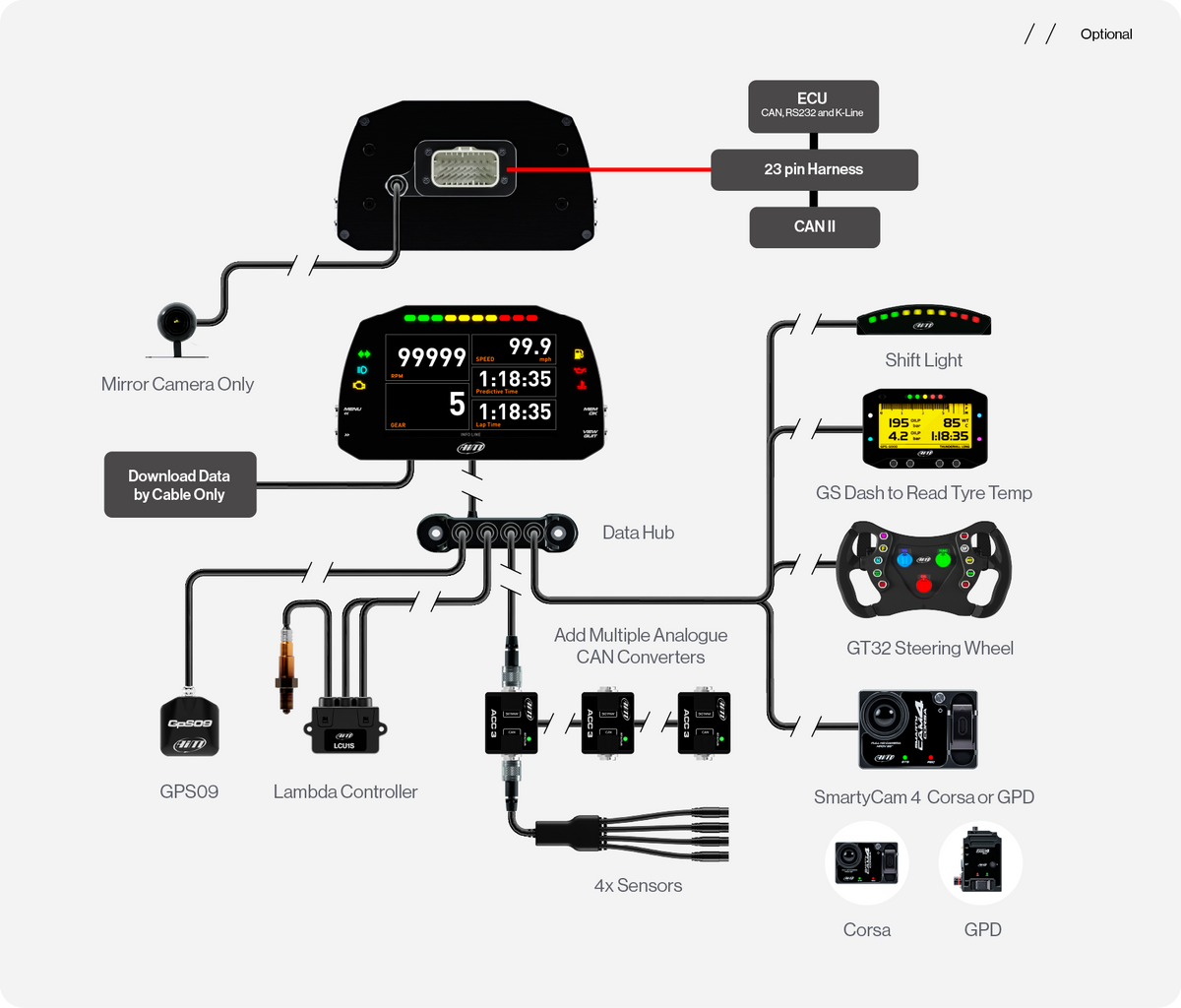

Choose either the OBDII or K-Line CAN, depending on whether you want to connect to the vehicle's ECU or OBDII port or directly to the ECU through the CAN channel.
Connecting the MXS 1.3 Strada Light dash to your ECU is simple. You can sample and display dozens of channels straight from the vehicle's ECU. This is usually the quickest and easiest setup, needing only 2 wire connections to the ECU instead of multiple connections to analogue sensors.
With the CAN output, you can send messages directly to an existing CAN network to improve the range of vehicle control possibilities. Two analogue camera inputs are also available to switch your display into a mirror camera, through a push button command or event management. The camera is sold separately.

MX Strada Light Series Expansions list; SmartyCam 3 Sport, ACC3, Data Hub, GPS and more.
Turn your MX Strada Light Dash into a complete data logging system with the MX Strada Logger, Data Hub & GPS09 Module. You can also integrate an ACC3 and convert your analogue to CAN, integrating a camera and various sensors into your setup.
