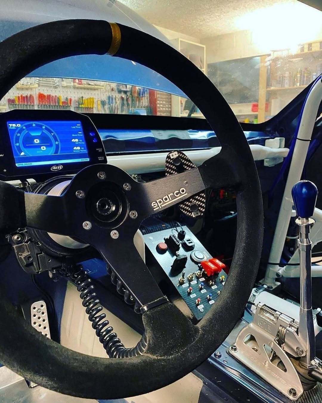

The MXS Strada Light 5" Display integrated into a car dashboard on a racetrack

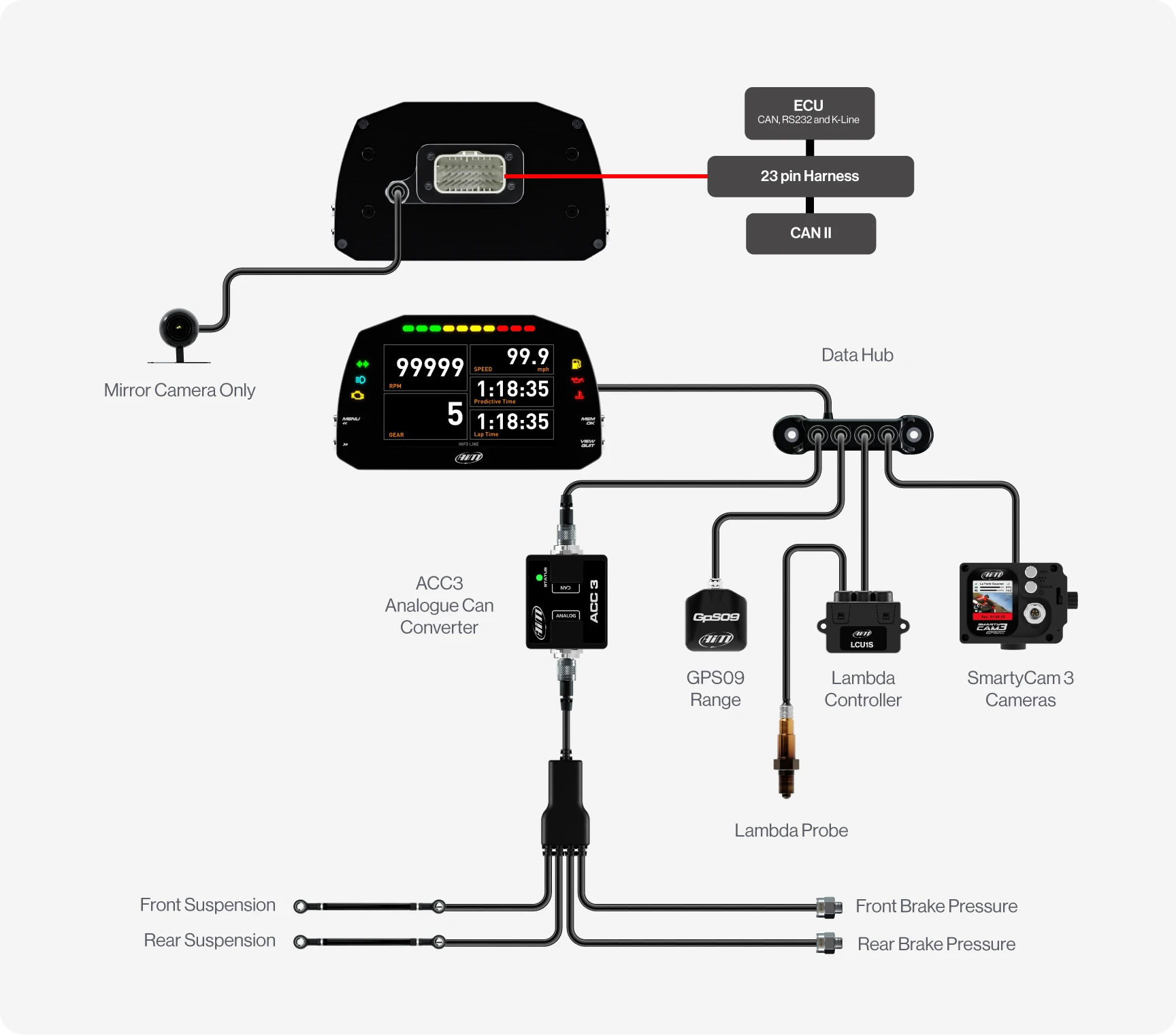

Connecting the MXS 1.3 Strada Light dash to your ECU is simple. You can sample and display dozens of channels straight from the vehicle's ECU. This is usually the quickest and easiest setup, needing only 2 wire connections to the ECU instead of multiple connections to analogue sensors.
With the CAN output, you can send messages directly to an existing CAN network to improve the range of vehicle control possibilities. Two analogue camera inputs are also available to switch your display into a mirror camera, through a push button command or event management. The camera is sold separately.

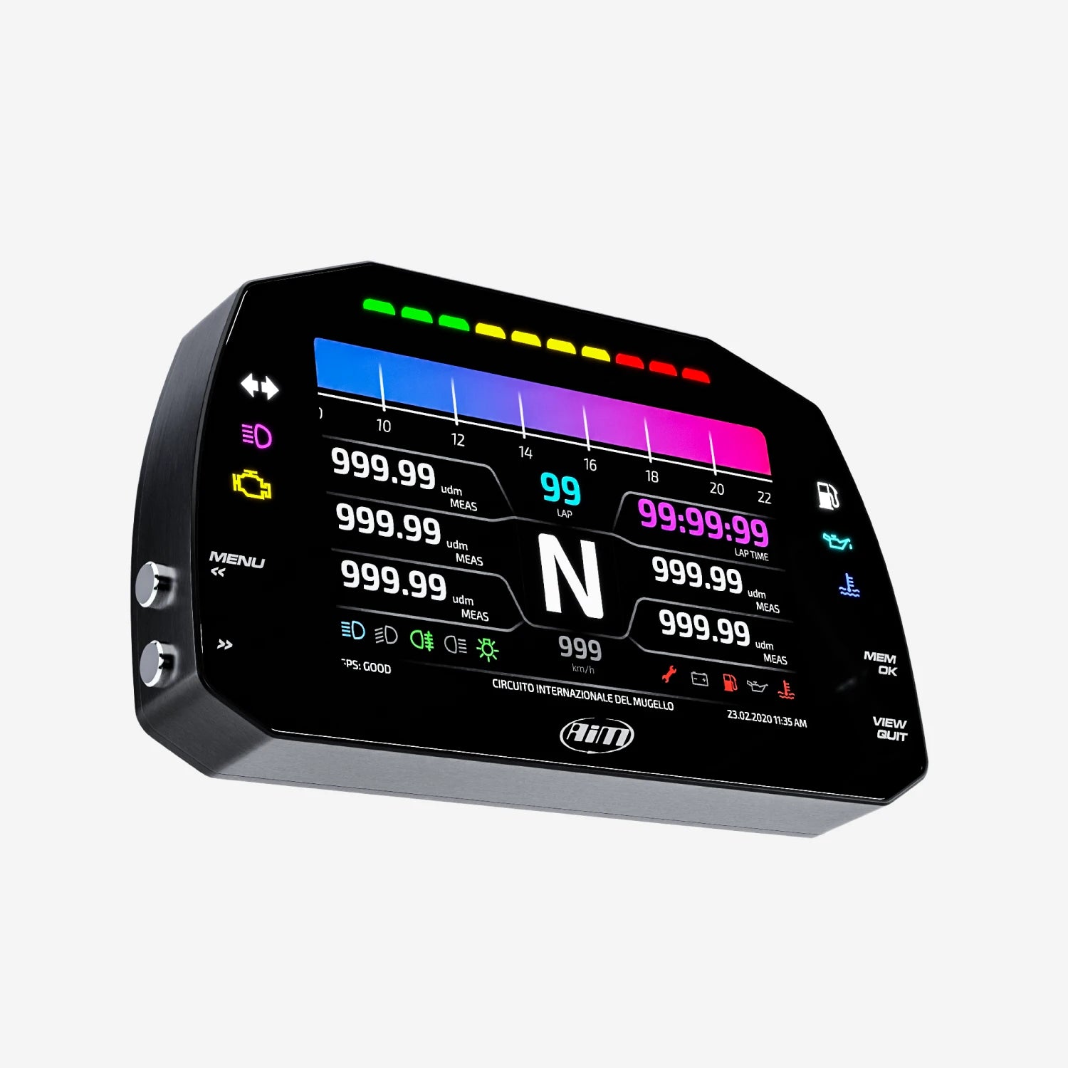

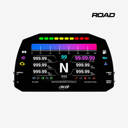

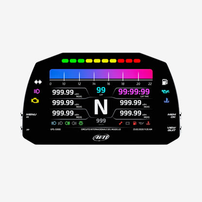

The MXS 1.3 Strada Light has a compact 5" TFT high contrast colour display. The visual quality is optimised by the ambient light sensor, which keeps the backlight at the best brightness levels.

The MXS 1.3 Strada Light shows the RPM scale and all the data you need, like speed, water temperature and oil pressure, lap times and much more. You can customise pages to suit your requirements, including up to four additional fields. Define what data is shown with the end of scale and measure units. Swapping between the pages is easy; just use the push buttons.

MX Strada Light Series Expansions list; SmartyCam 3 Sport, ACC3, Data Hub, GPS and more.
Turn your MX Strada Light Dash into a complete data logging system with the MX Strada Logger, Data Hub & GPS09 Module. You can also integrate an ACC3 and convert your analogue to CAN, integrating a camera and various sensors into your setup.
