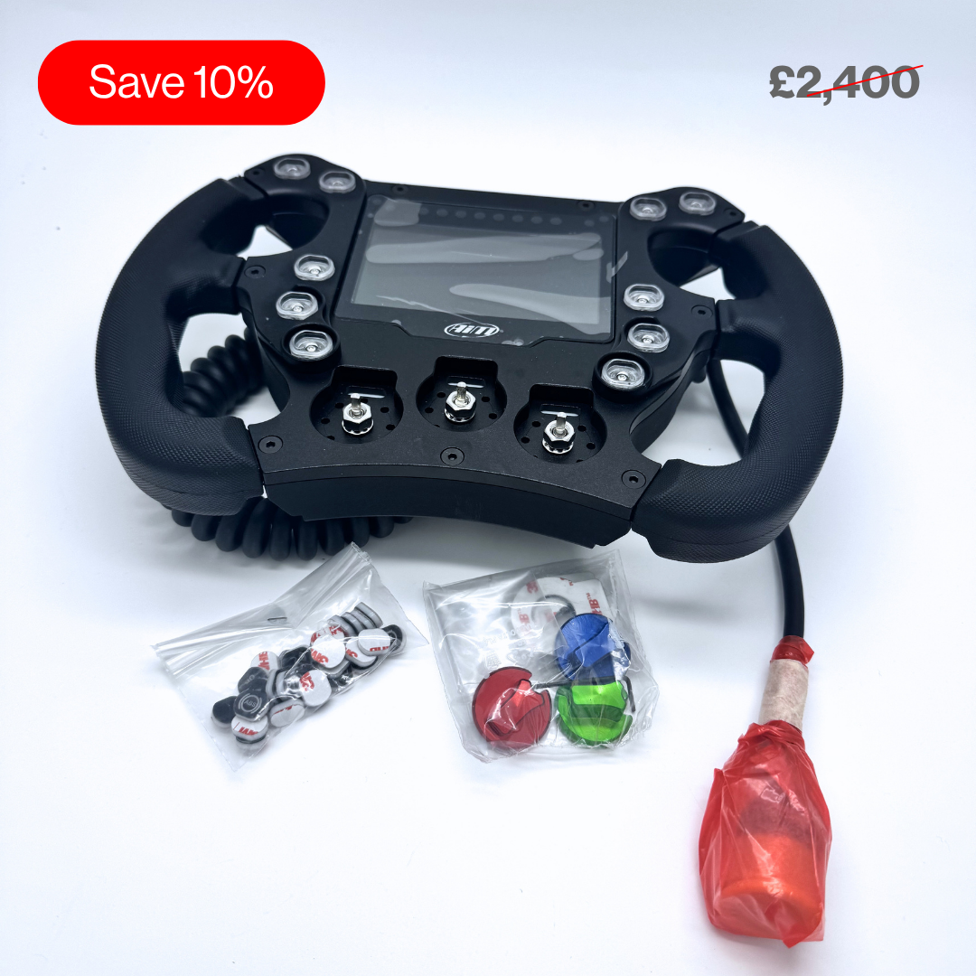

This SW4 270 Formula Steering Wheel is brand-new and unused, but available at a reduced price due to limited stock and no future production. The product is in full working order at a reduced price, and has been meticulously checked by our technicians.
Data Logging Steering Wheel
The Aim Formula Steering Wheel 4 270 is amongst our most advanced motorsport steering wheels to date. It has an internal data logger with complete configuration, removable grips, rotary switches and a long list of fully compatible ECU and CAN connectivity options.

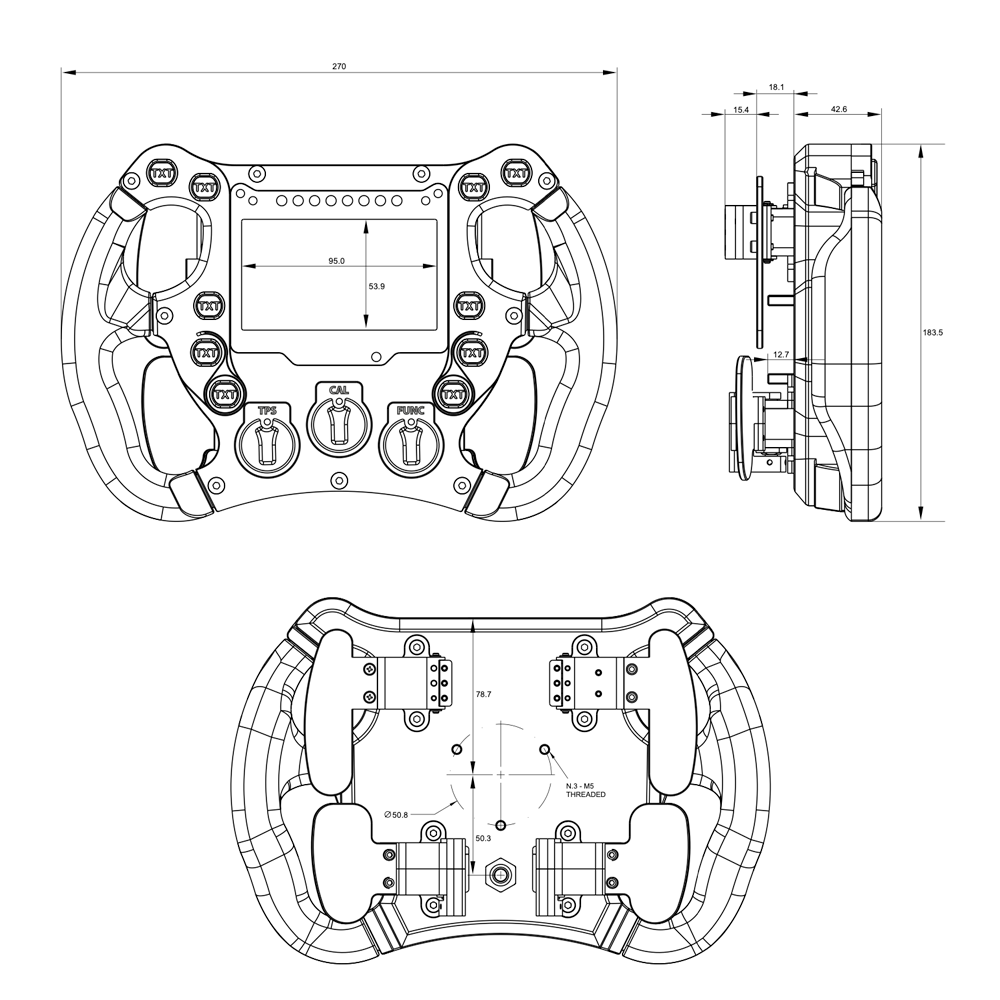

  • Dimensions: 270 x 183.5 x 42.6mm

  • Dimensions: 270 x 189.5 x 38.2mm
  • Weight: 1,500g
  • Weight: 2,400g
  • GT320 Dimensions: 320 x 183.5 x 42.5mm
  • GT350 Dimensions: 350 x 183.5 x 42.5mm
