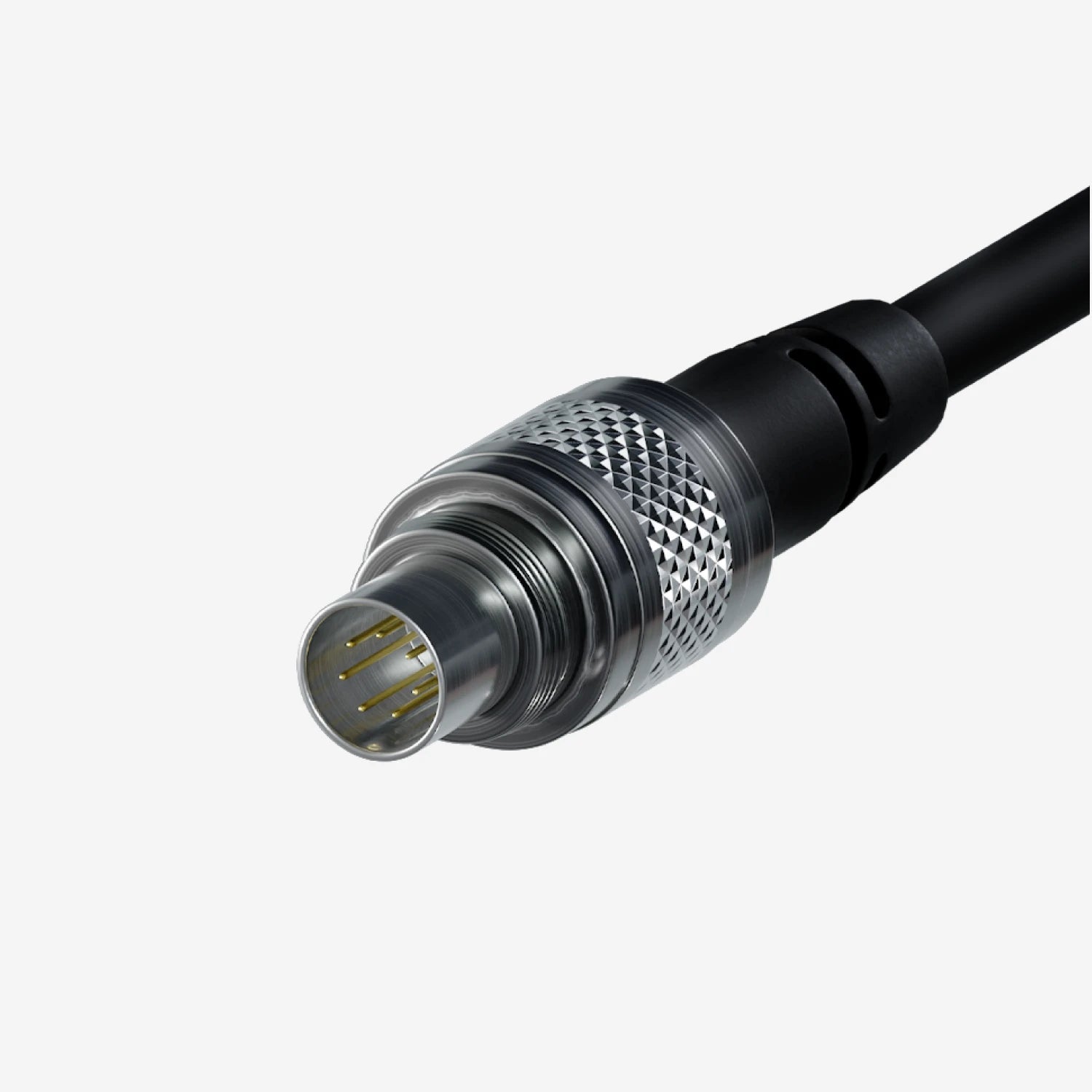

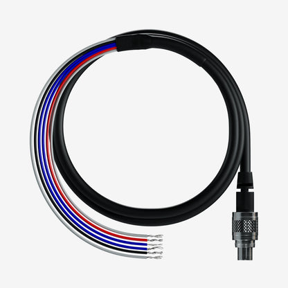

    The Aim CAN/RS232 2m external power cable connects your Solo 2 DL to your ECU wiring.
    Key Features:
    7 pin - 712 male binder connection 6 non-terminated wires
    Suitable for Solo 2 DL
    RS232/CAN External Power Cable
    The Aim RS232/CAN 2m external power cable connects your Solo 2 DL to your ECU.
    This is one of the connection cables available for the Solo 2 DL. Others are the OBDII and the RPM cable.
    Aim Solo 2 DL CAN / RS232 2m External Power Cable
    • 7 pin - 712 male binder connection
    • 2m length cable

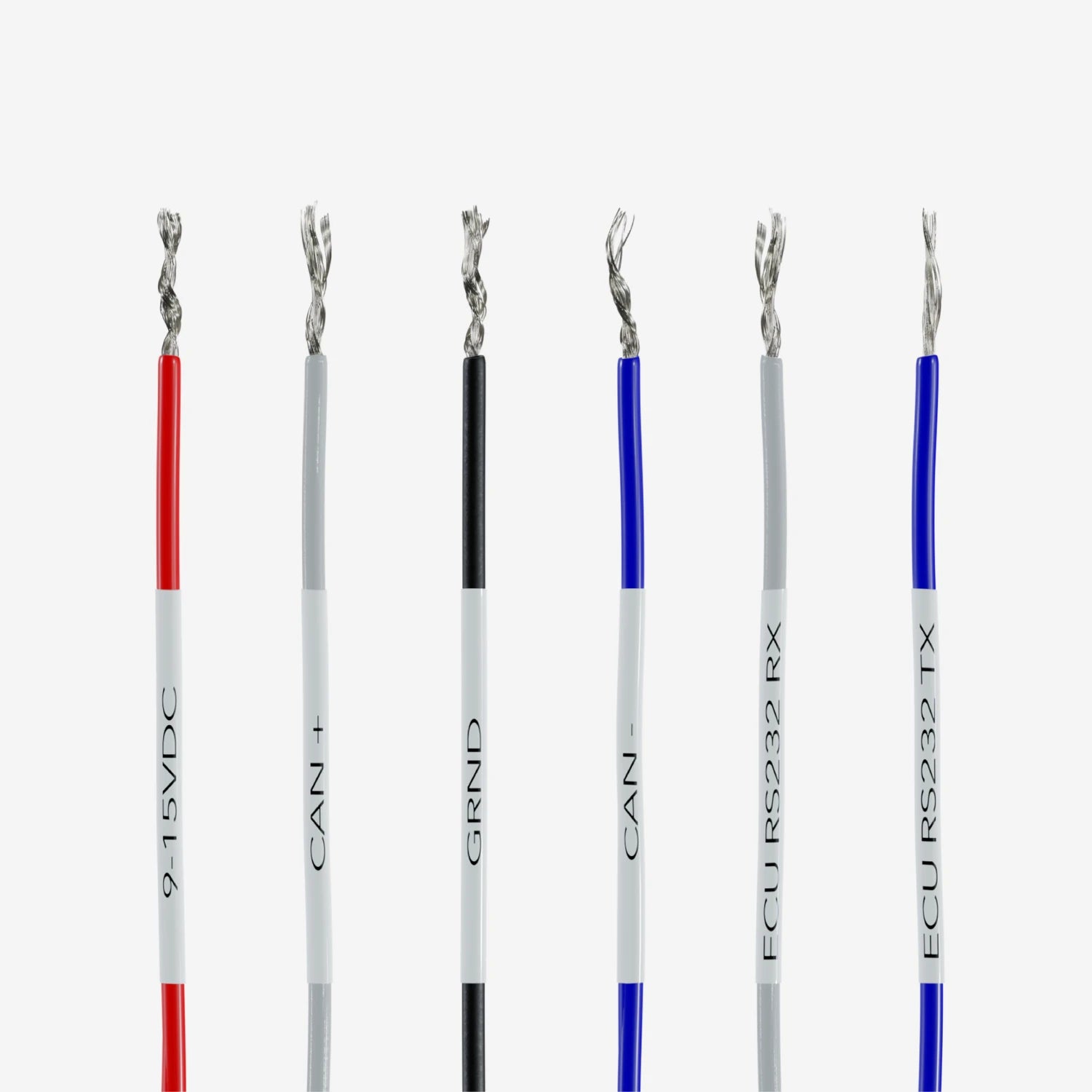

    • Free cables:
    • White - CAN+
    • Blue - CAN-
    • Red - 9-15DC
    • Blue - ECU RS232 TX
    • White - ECU RS232 RX
    • Black - GND
    • Both blue wires have a tag identifier, stating the connection type.
