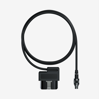

The Aim OBDII 2m external power cable connects your Solo 2 DL to your ECU wiring.
This is one of the connection cables available for the Solo 2 DL. Others are the RS232/CAN and the RPM cable.

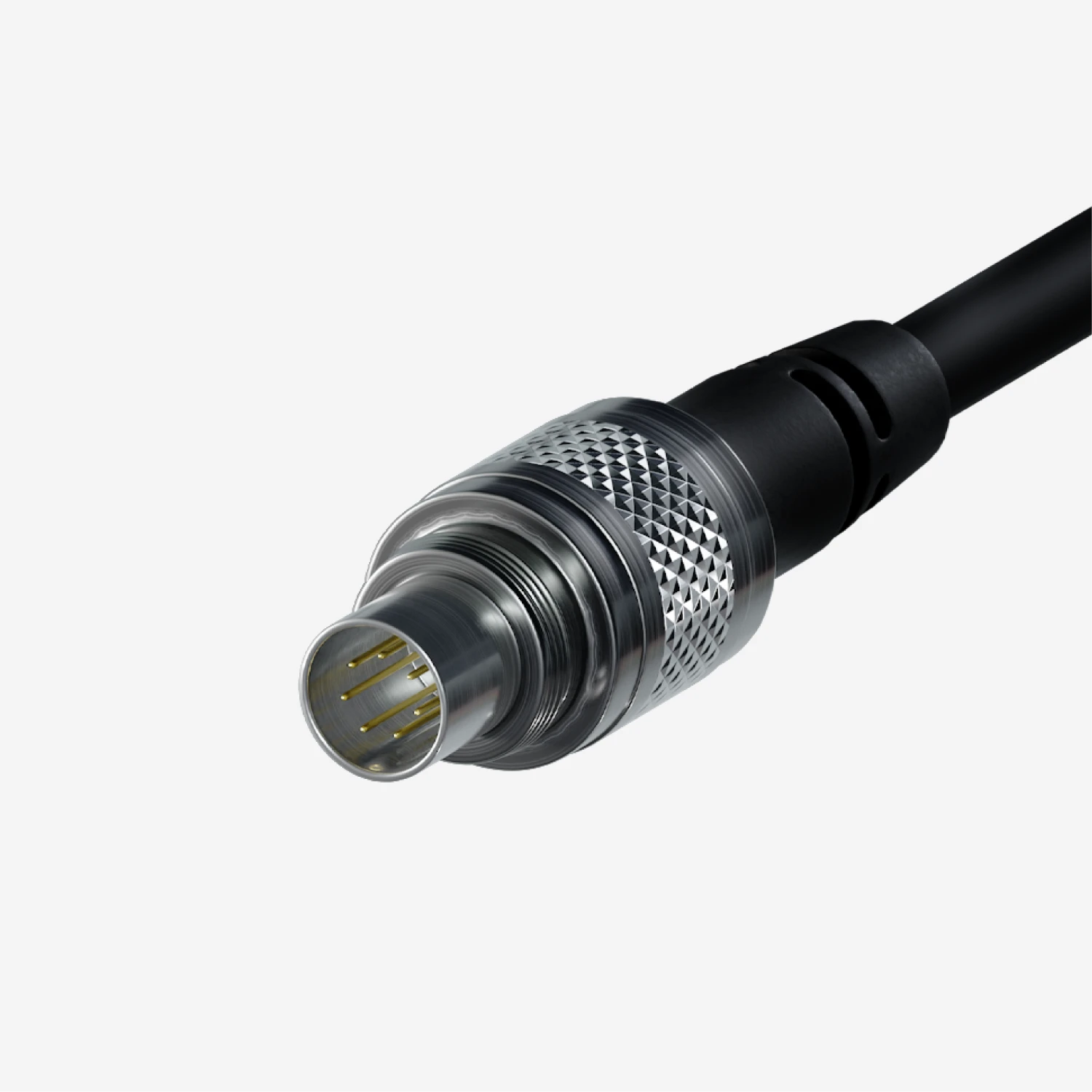

  • 7-pin 712 male binder connection
  • 2m cable

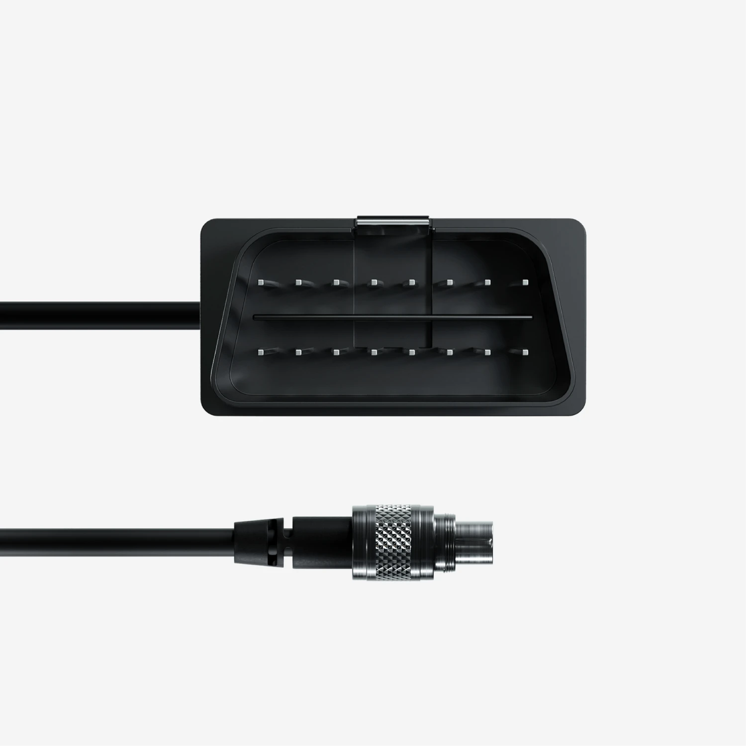

OBDII Connector Pin
  • 2 - Positive bus line - SAE J1850 protocol: not supported by Aim devices
  • 4 - Chassis GND
  • 5 - GND signal
  • 6 - CAN high - ISO 15765-4 and SAE J2234 protocols
  • 7 -  K-Line - ISO 9141-2 and ISO 14230-4 protocols
  • 10 - Negative bus line - SAE J18050 protocol: not supported by Aim devices
  • 14 - CAN low - ISO 15765 and SAE J2234 protocols
  • 15 - L line - ISO 9141-2 and ISO 14230-4 protocols
  • 16 - Battery supply
