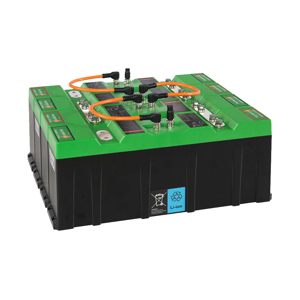

    The Nomada 12V105Ah is a modular Lithium Iron Phosphate (LiFePO4) rechargeable battery with a rated capacity of 105 Ah. This new addition to our portfolio of lithium batteries has a compact and lightweight modular design which means you can easily scale up your energy system. The Nomada is mainly designed for use as a system battery and not as a stand-alone battery.
    The Nomada 12V105Ah-LT variant, with an internal heater, allows charging in ambient temperatures below 0°C. This model efficiently heats the Li-ion battery using its own energy. Through a well-designed system setup, the battery can be heated without depleting its charge. This eliminates the need for additional cables or heaters
    • Product Features
    • Modular traction battery
    • Lithium Iron Phosphate (LiFePO4): Safe Li-ion technology
    • Integrated BMS (Battery Management System),
    • BIB or BCI with disconnect device (relay) is required
    • PC+ABS (UL94 V-0) flame-retardant battery casing
    • Terminals for 2 x M8 bolts
    • External fuse needed
    • Wired communication interface: CANopen
    • Easy CAN bus interconnection
    • Battery monitoring and history storage
    • Adaptive cell balancing
    • Configurable in serial or parallel connection
    • Independent temperature sensor for DNV type approved battery
    • The optional LT model includes internal heating
    Intended Use
    The Nomada 12V105Ah Li-ion battery serves as an energy source of 12V in power systems for recreational vehicles, commercial vehicles, leisure boats, commercial vessels and stationary applications. Potential applications for this Li-ion battery include: off grid power supply, marine power supply, medium for (renewable) energy storage and (traction) battery for vehicles. Using it as a starter battery is not possible. Up to 4 batteries can be connected in series or in parallel to increase the total capacity up to 420Ah. When using more than 4 batteries in series or parallel always consult Super B.

    ELECTRICAL SPECIFICATIONS
    Nominal capacity
    105Ah
    Open circuit voltage
    13.2v
    self-discharge
    <3% per month
    Cycle Life
    >3500 cycles (at 100% DoD)
    Voltage
    12v
    MECHANICAL SPECIFICATIONS
    Dimensions (LxWxH)
    437 x 90 x 175 mm / 17.2” x 3.5” x 6.9”
    Weight
    10 kg / 22 lbs
    Case material
    PC-ABS | UL94-V0
    Ingress protection
    IP66
    Cell type / Chemistry
    Prismatic - LiFePO4
    Charge method
    CCCV
    Charge voltage
    14.3V - 14.6V
    Max. charge current
    105A
    End of discharge voltag
    10V
    Discharge current continuous
    105A
    Discharge pulse current
    315A (30 sec)
    TEMPERATURE SPECIFICATIONS
    Charge temperature
    0°C to 55°C / 32°F to 131°F
    Discharge temperature
    -20°C to 55°C / -4°F to 131°F
    Storage temperature
    -20°C to 45°C / -4°F to 113°F
    COMPLIANCE SPECIFICATIONS
    Certifications
    CE, UKCA, FCC, UN 38.3, DNV, UL 1642 (Cells), UN ECE R10.06, EN/IEC 62619-62620 (ESTRIN)
    Shipping classification
    UN 3480
    GENERAL SPECIFICATIONS
    EAN-13
    8718531361799
    Battery designation
    IFpP/36/130/195/ [1P4S]M/-20+55/90
