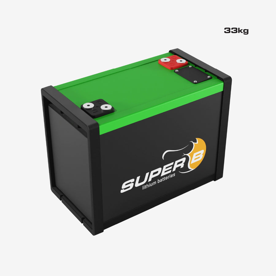

    What Is The Super B Nomia 12V340AH Lithium Traction Battery?
    The Super B Nomia 12V340AH Lithium Traction Battery is a state-of-the-art Lithium Iron Phosphate battery (LiFePO4) with a rated capacity of 340Ah for high-performance energy storage. Its advanced technology and smart software makes this lithium battery a robust, low-maintenance, safe and user-friendly energy storage solution, offering significant weight and space savings compared to conventional lead-acid batteries.
    Product Features
    Traction battery
    Lithium Iron Phosphate (LiFePO4): Safe Li-Ion technology
    Integrated BMS (Battery Management System), external disconnect device needed
    Glass fibre reinforced plastic (GRFP) Casing, Aluminium / PE sandwich side panels
    Terminals for 2 x M8 bolts
    Integrated fuse, 32V / 500A
    Wired communication interface: CAN open
    Battery monitoring / History storage
    Adaptive cell balancing
    Configurable in serial or parallel connection
    Output for bistable relay/latching relay
    Weight & space-saving battery

    Intended Use
    The Nomia 12V340Ah Li-Ion battery is ideal for recreational vehicles, commercial vehicles, leisure boats, commercial vessels and stationary applications.
    Potential applications of this Li-Ion battery include: off grid power supply, marine power supply, medium for (renewable) energy storage and (traction) battery for vehicles.
    Note: This battery is not suitable for use as a starter battery. Up to 4 batteries can be connected in series or in parallel to increase the total capacity up to 1360Ah. For more batteries, consult with Super B for guidance.

    The Super B Nomia 12V340Ah Lithium battery stands out for its high energy capacity (340Ah) and advanced LiFePO4 technology, offering superior safety, longevity and performance. It ensures reliable protection against overcharging, deep discharging and overheating, contributing to its long cycle life of over 4,000 cycles at 100% depth of discharge.
    Despite its robust output, the battery remains compact and lightweight at just 33 kg, making it ideal for space-sensitive applications. The Nomia also supports fast charging, delivers high discharge currents and has a low self-discharge rate under 3% per month. Overall, it offers a reliable, low-maintenance power solution for a variety of setups

    Specifications
    ELECTRICAL SPECIFICATIONS
    Nominal capacity
    340Ah
    Open circuit voltage
    13.2v
    Self-discharge
    <3% per month
    Cycle Life
    <4000 cycles (100% DoD)
    Voltage
    12v
    MECHANICAL SPECIFICATIONS
    Dimensions (LxWxH)
    417 x 227 x 314 mm / 16.4” x 8.9” x 12.4”
    Weight
    33 kg / 72.7 lbs
    Case material
    GFRP
    Ingress protection
    IP50
    Cell type / Chemistry
    Prismatic - LiFePO4
    Charge method
    CCCV
    Charge voltage
    14.2V
    Max. charge current
    300A
    End of discharge voltage
    10V
    Discharge current continuous
    300A
    Discharge pulse current
    900 A (30 sec)
    TEMPERATURE SPECIFICATIONS
    Charge temperature
    0°C to 60°C / 32°F to 140°F
    Discharge temperature
    -10°C to 60°C / 14°F to 140°F
    Storage temperature
    -20°C to 45°C / -4°F to 113°F
    COMPLIANCE SPECIFICATIONS
    Certifications
    CE, UKCA, FCC, UN 38.3, EN/IEC 62619-62620 (ESTRIN), UN ECE R10.06, UL 1642 (Cells)
    Shipping classification
    UN 3480
    GENERAL SPECIFICATIONS
    EAN-13
    8718531362314
    Battery designation
    IFpP/41/173/205/ [2P4S]M/-10+60/95
