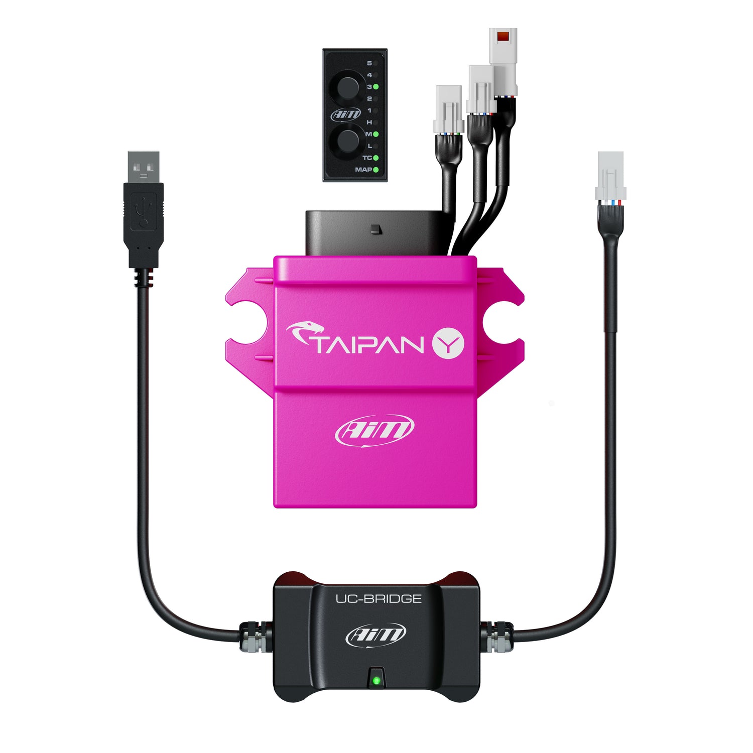

The Aim Taipan Y ECU is the latest plug & play engine control unit, designed exclusively for plug & play installation for Yamaha YZ250F 2019-2023 and YZ450F 2019-2022 motocross bikes. Engineered with cutting-edge 32-bit technology, it offers unmatched precision, delivering improved performance without compromising reliability. With advanced fuel mapping and ignition strategies, the Taipan Y ECU provides superior control over your engine's behaviour for optimised power delivery and throttle response.
Why Choose the Taipan Y ECU
The Aim Taipan Y ECU is designed to give riders complete control over their motocross bike’s performance. With highly accurate ignition timing and fuel injection control, the Taipan Y ECU ensures the smoothest power delivery, maximising acceleration and traction in all conditions.
Whether you're on the track or the trails, the Taipan Y ECU provides a fully customisable racing experience tailored to your riding style.
Taipan Y ECU Connections
The Taipan Y ECU has 4 connectors:
  • Main Connector: Compatible with most off-road bikes.
  • CAN Connector: Connects to the Handlebar Switch 2 and data logger.
  • 2nd CAN Connector: Connects to the UC Bridge to communicate with the PC.
  • 3rd Connector: Connects to spare analogue inputs and a possible second injector.

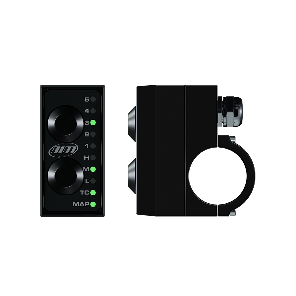

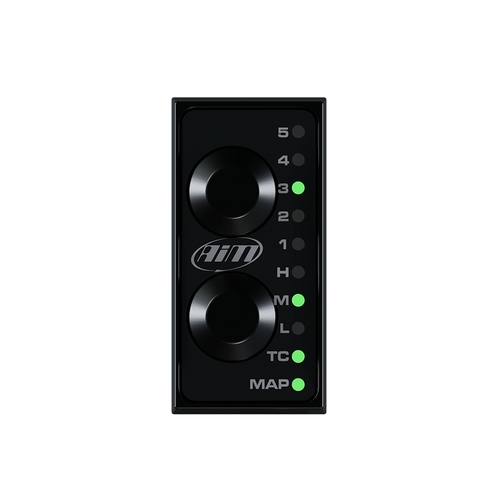

You can choose from up to five selectable maps with the Handlebar Switch 2.
The Taipan can manage up to five maps that can be selected both by OEM switches (Yamaha) or even more easily by the Aim Handlebar Switch 2, which is included in the motocross ECU kit.
HBS2 is the compact, high-performance, and built tough Handlebar Switch. If you're looking for a highly flexible and ergonomic switch, the Aim HBS2 offers a great solution with 4 push buttons and 11 integrated LEDs.
  • Map Management
  • Fuel Trim
  • Traction Control Management
  • Launch Control Management
  • Buttons Setting Memorisation
HBS2 also allows the management of quick shifting on factory-equipped bikes.
