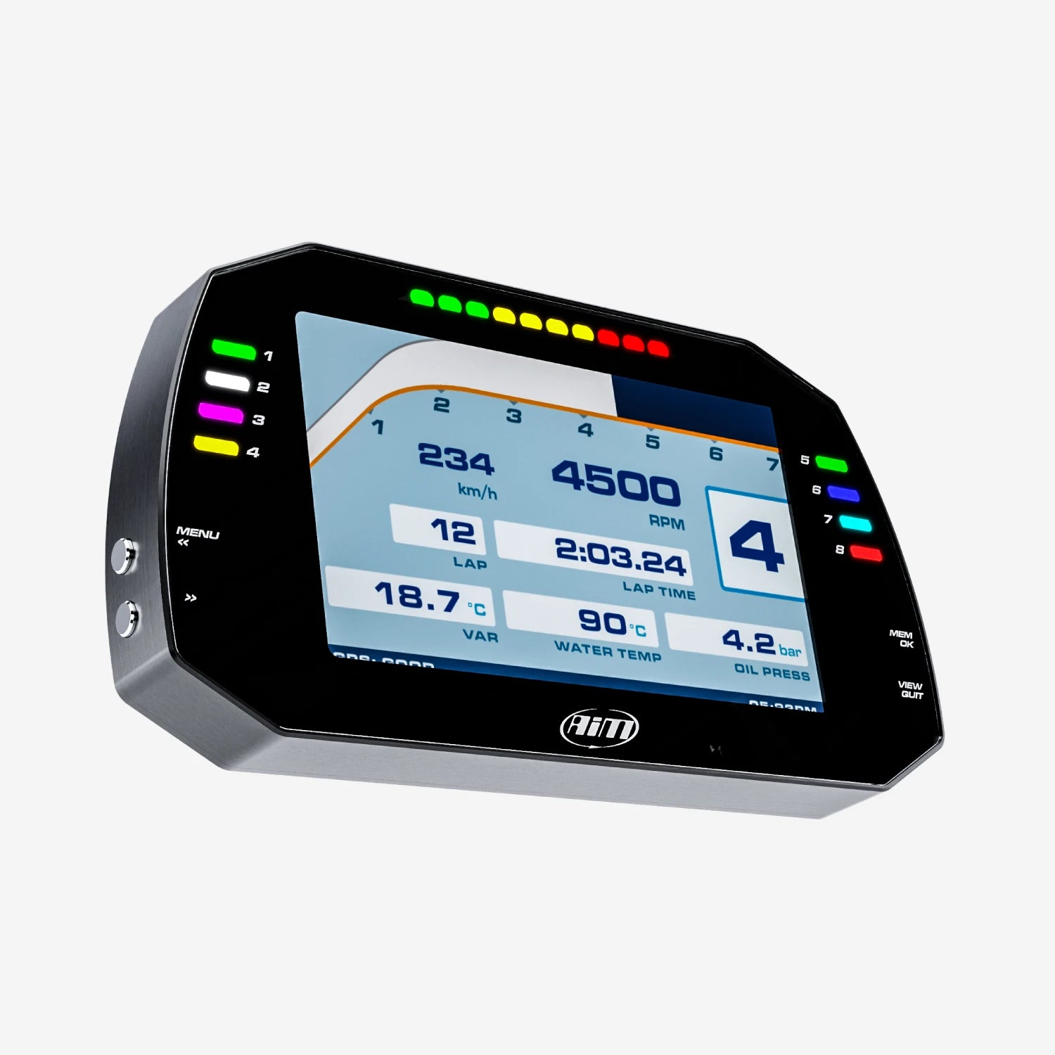

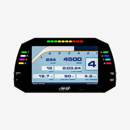

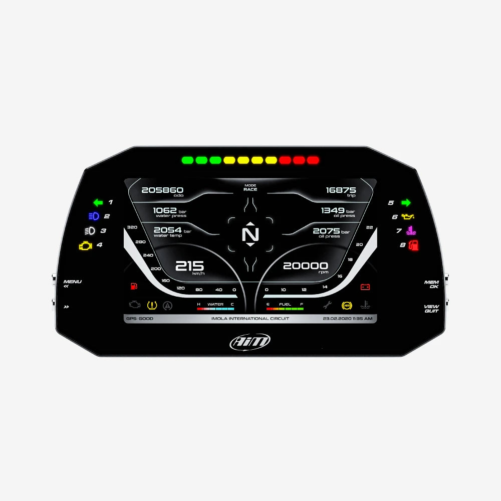

The MXG 1.3 Strada Light has a 7" high contrast TFT colour display. The visual quality is optimised by the ambient light sensor, which keeps the backlight at the best brightness levels. Race icons allow you to apply conditions to the LED icons.
Load video: Delta times LED display feedback on the MXG 7 inch Strada Light Display
Load video: Integrated shift light array interface and customisable alarms for the MX Strada Light Series
Load video: Pre-configured dash display screens for the MX Strada Light Series.
Pre-Configured Pages
The MXG 1.3 Strada Light shows the RPM scale and all the data you need, like speed, water temperature and oil pressure, lap times and much more. You can customise pages to suit your requirements, including up to four additional fields. Define what data is shown with the end of scale and measure units. Swapping between the pages is easy; just use the push buttons.

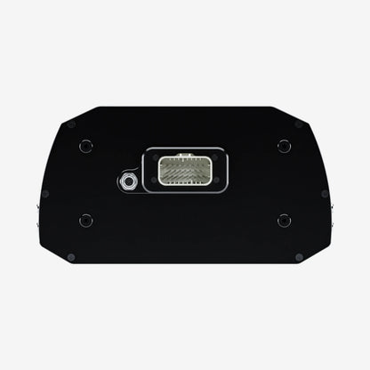

  • Connectors: 1 AMP connector & 1 binder connector

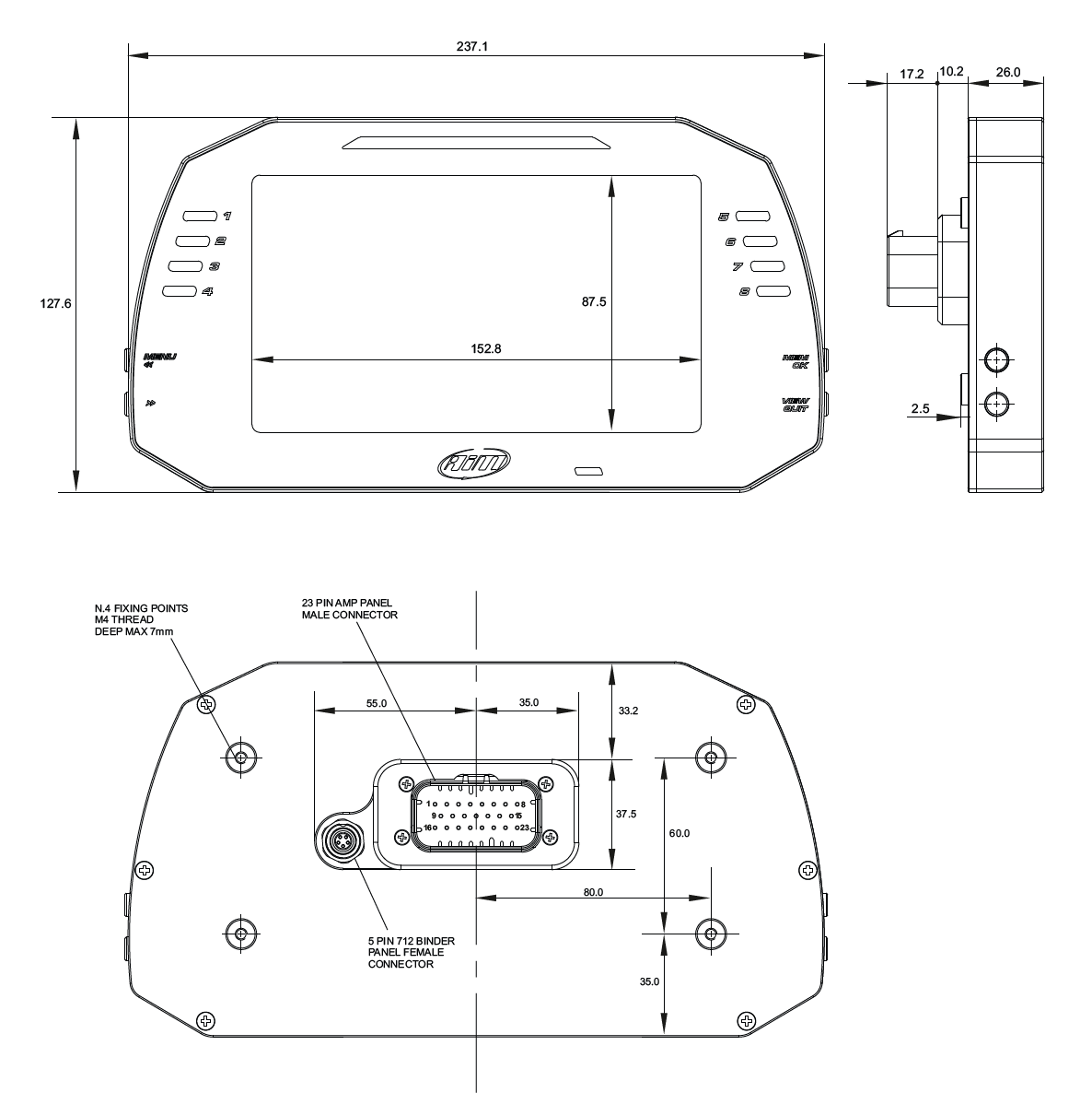

  • Dimensions: 237.1 x 127.6 x 26.0mm
  • Weight: 850g

  • Dimensions: 237.1 x 127.6 x 26mm
  • Weight: 850g

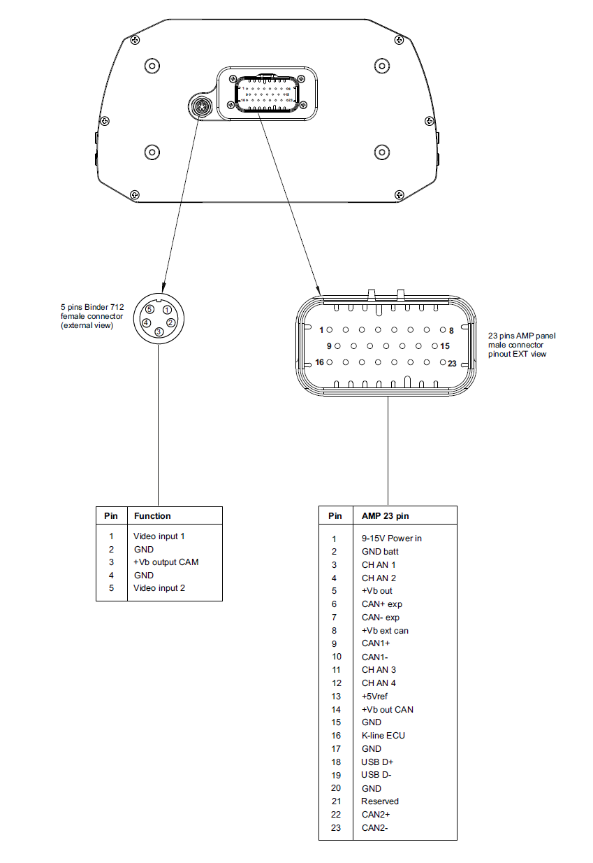

  • 23-Pin Standard Wiring

  • 14-Pin Standard Wiring

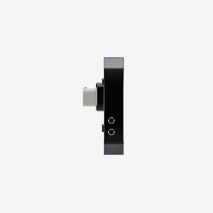

To switch pages on the Aim MXG Strada Light, first open our free Race Studio 3 software and then select the Page Configuration to customise each page. After choosing your selections, save your configurations and press the ">>" push button on the side of the device to switch between your pages.
