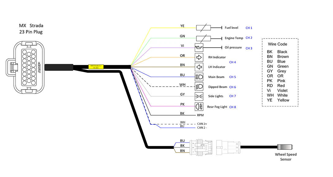

Harness Options
MXP 1.3 Strada
USB Cable
14-Pin Standard Wiring
23-Pin IVA Loom
What are the differences between the MXP Strada IVA-Compliant Displays and the MXP Strada Display?
The main difference between the MXP Strada IVA-Compliant Display and the MXP Strada Display is that the IVA version has an IVA-specific second harness that comes with the display kit, providing essential road lighting indicators (turn signals, fog lights, etc.) to meet UK Individual Vehicle Approval (IVA) standards. While both have a 6" display and ECU compatibility, the IVA dash provides a plug & play solution for road-legal kit cars. For a full comparison of the MX Strada Series, take a look at the comparison tab.
