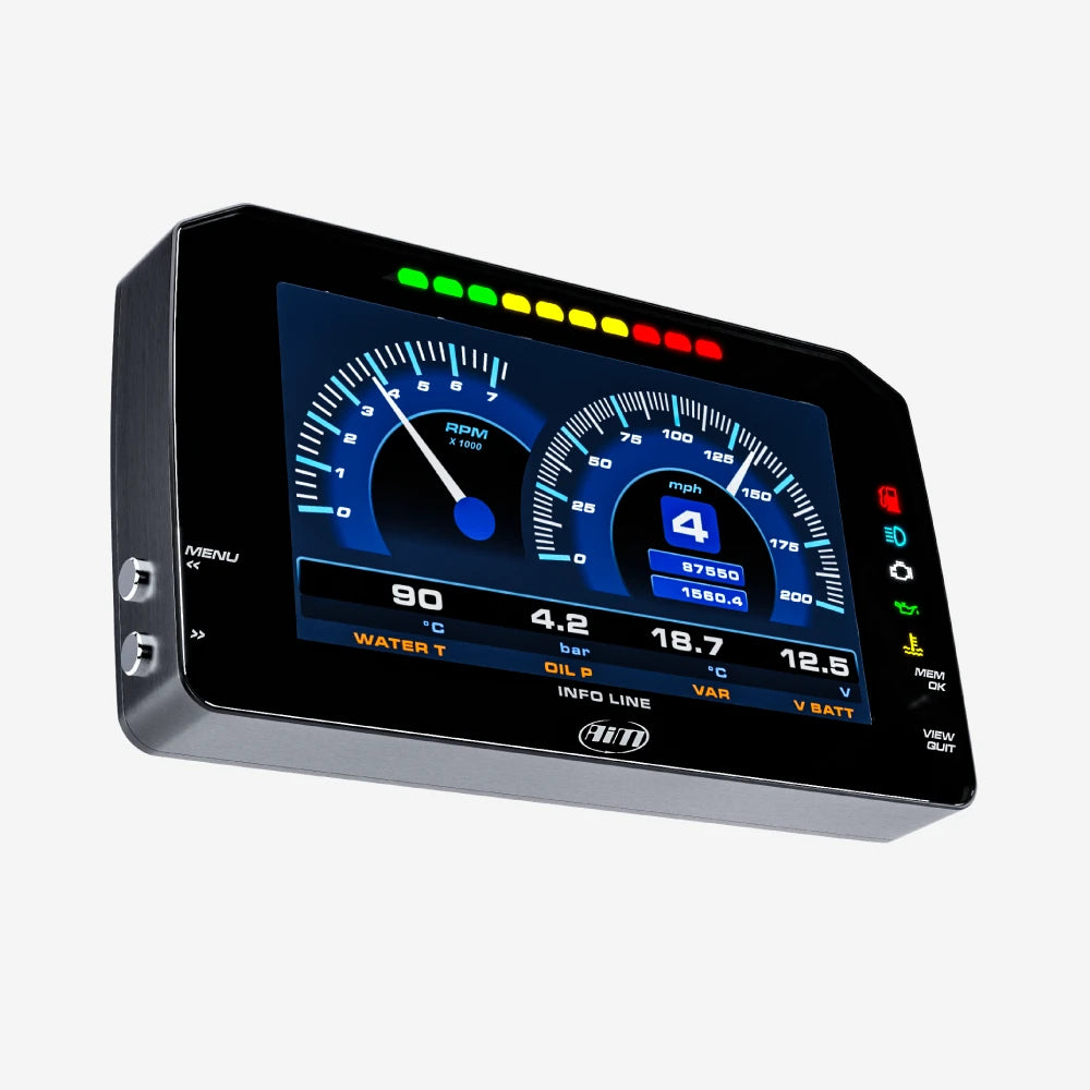

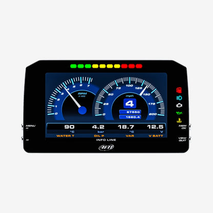

The MXP 1.3 Strada IVA-compliant dash has a 6" TFT high contrast colour display. The visual quality is optimised by the ambient light sensor, which keeps the backlight at the best brightness levels.
Pre-Configured Pages
The MXP 1.3 Strada IVA dash shows the RPM scale and all the data you need, like speed, water temperature and oil pressure, lap times and much more. You can customise pages to suit your requirements, including up to four additional fields. Define what data is shown with the end of scale and measure units. Swapping between the pages is easy; just use the push buttons.

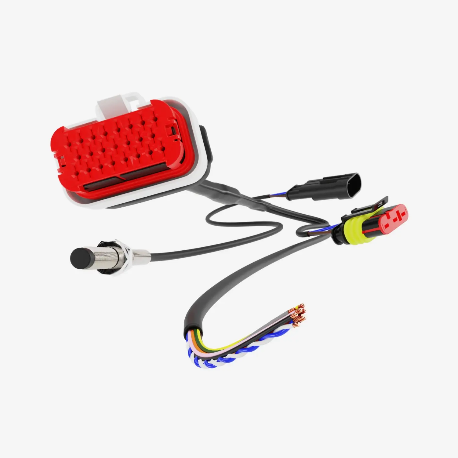

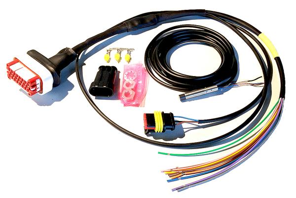

Harness Options
MXP 1.3 Strada
USB Cable
14-Pin Standard Wiring
23-Pin IVA Loom
What are the differences between the MXP Strada IVA-Compliant Displays and the MXP Strada Display?
The main difference between the MXP Strada IVA-Compliant Display and the MXP Strada Display is that the IVA version has an IVA-specific second harness that comes with the display kit, providing essential road lighting indicators (turn signals, fog lights, etc.) to meet UK Individual Vehicle Approval (IVA) standards. While both have a 6" display and ECU compatibility, the IVA dash provides a plug & play solution for road-legal kit cars. For a full comparison of the MX Strada Series, take a look at the comparison tab.
