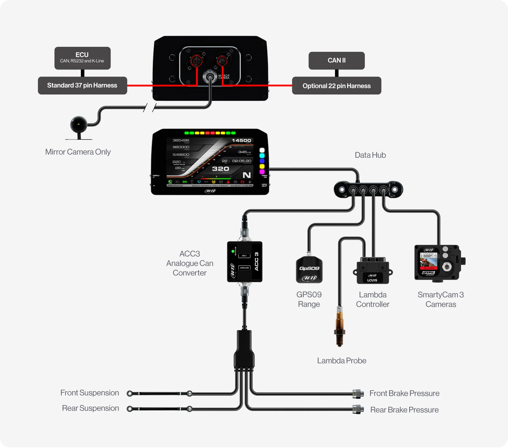

Connecting the MXP 1.3 dash to your car's ECU is simple. You can sample dozens of channels straight from the ECU. This is usually the quickest and easiest setup, needing only a cable connection to the ECU instead of multiple connections and analogue sensors.
The sampled data will depend on your actual ECU, but typically includes RPM, engine load, throttle position (TPS), oil, air, water temperature, oil pressure, battery voltage, speed, gear and lambda value (air/fuel ratio). The list of available ECU drivers is constantly updated and upgraded, and includes over 1,000 different ECUs.

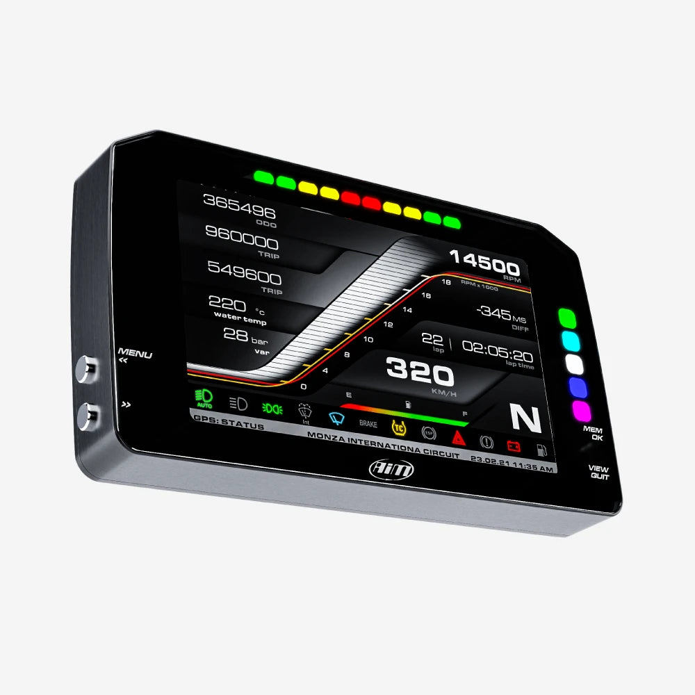

Configurable Display
With a high contrast 6" TFT display, which is fully configurable, you can create and customise pages/displays to suit your requirements. Swapping pages can be managed by pushing one or two push buttons. An ambient light sensor adjusts the backlight for optimal brightness, ensuring clear visibility in all lighting conditions.

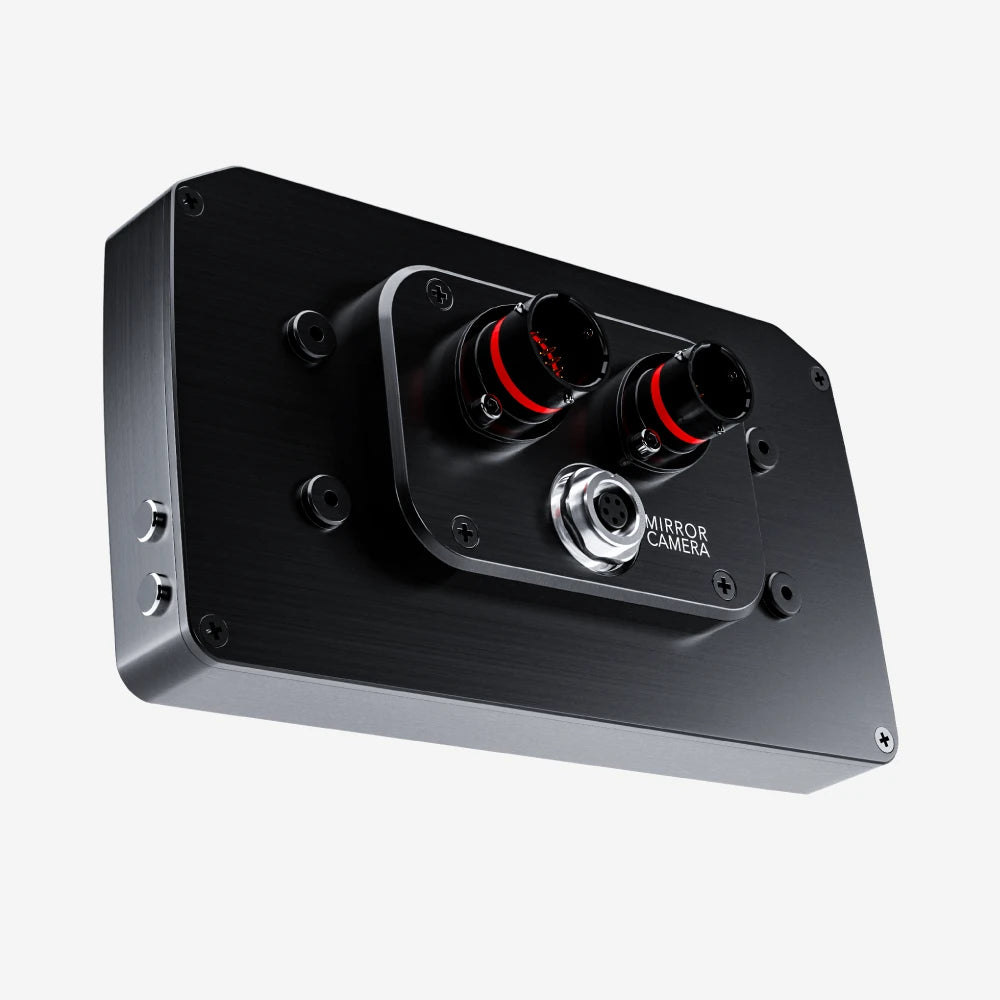

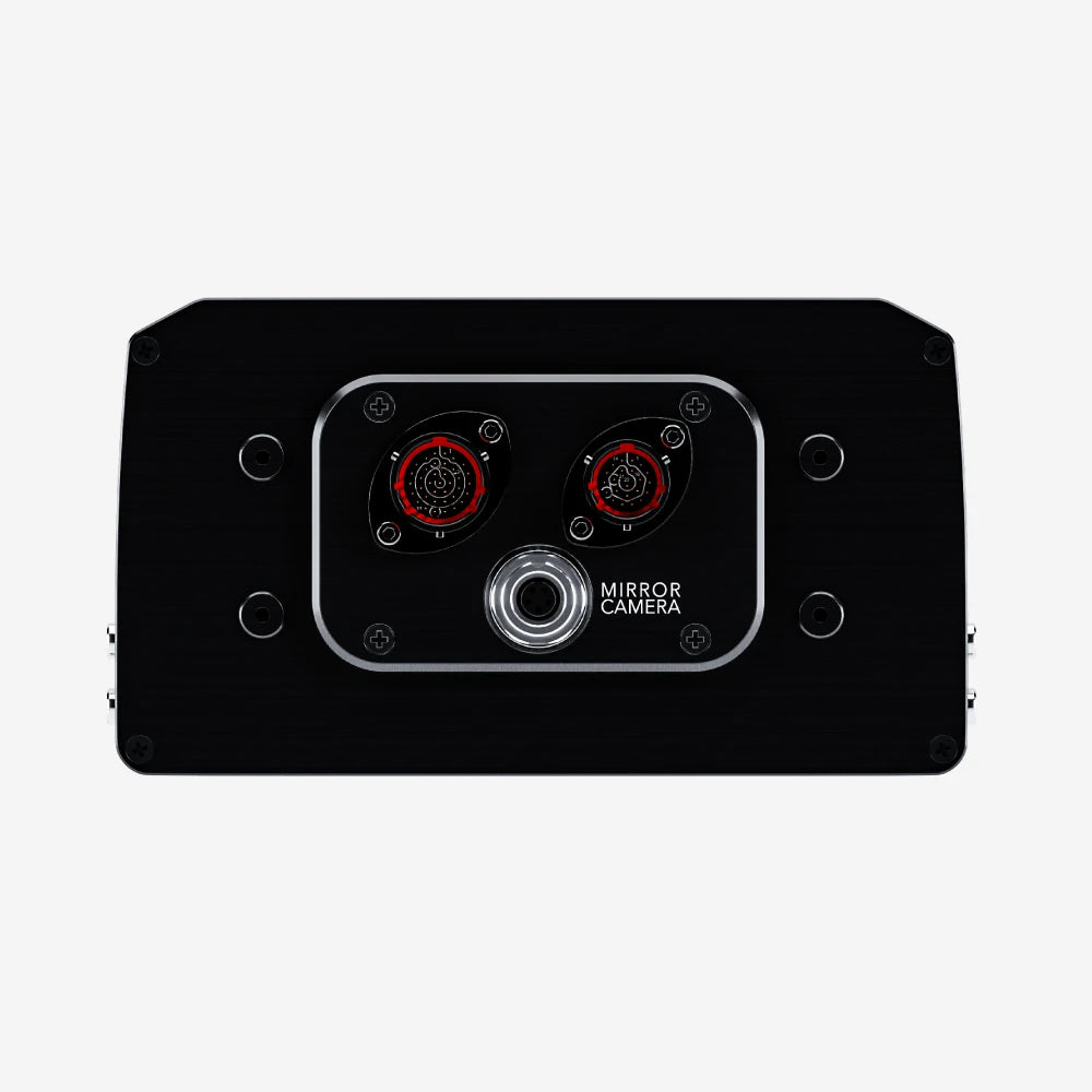

Two analogue camera inputs are available to switch your display into a mirror camera, through a push button command or event management. The camera is sold separately.
Flexible Alarms
The MXP car dash display logger has 6 configurable RGB LEDs. You can choose the conditions and colours. Select a solid alarm or flashing one, and the flashing frequency. You can choose to have an accompanying text message and set the alarm priorities.

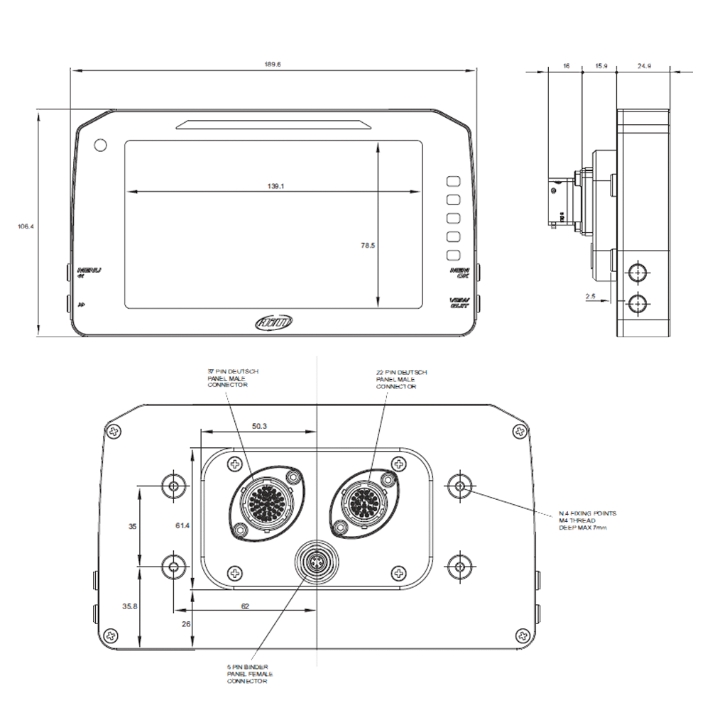

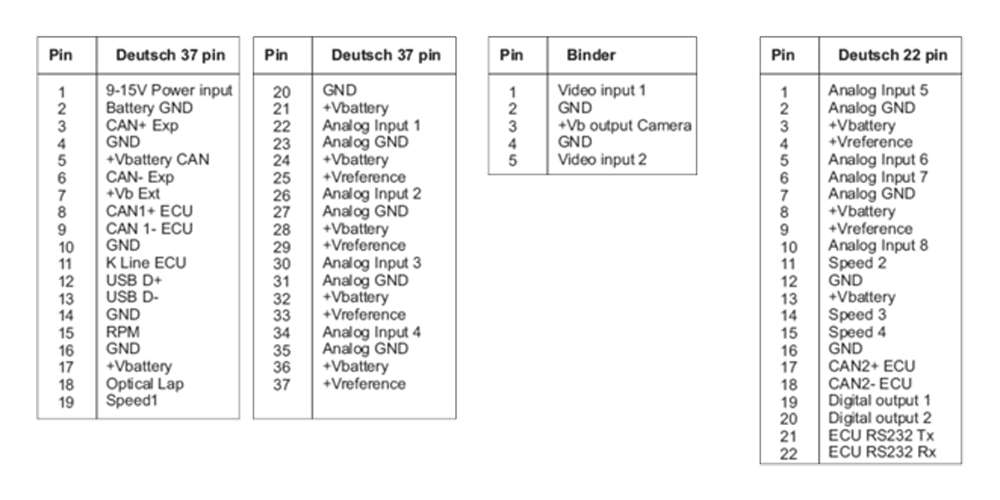

Please Note: A 37 pin harness comes standard in the kit. Should you need more data, you can add our 22 pin harness as an optional extra.

  • Expansion CAN Connection: GPS, Channel Expansion, Thermocouple Expansions, Lambda Controller, SmartyCam
