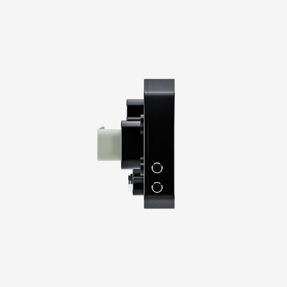

Why Choose the Aim MXS IVA-Compliant Dash Display Kit
MXS IVA-compliant dashes are digital displays, specially designed for kit car drivers who need essential data visibility while on the road. They display real time data such as speed, RPM and temperatures, but they don't include data logging functionalities natively. To extend their capabilities to log data similar to the full display loggers, a Strada Logger Kit is required.

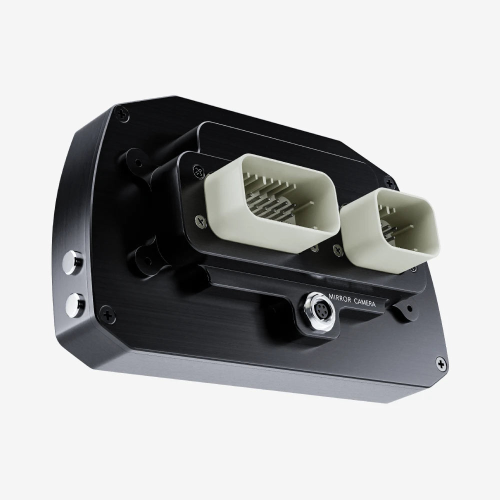

The MXS 1.3 Strada IVA displays are available with a choice of connections. Choose either the OBDII or K-Line CAN, depending on whether you want to connect to the kit car's ECU or OBDII port or directly to the ECU through the CAN channel.
You can sample and display dozens of channels straight from the ECU with only 2 cable connections to the ECU instead of multiple connections to analogue sensors. The sampled data depends on the actual ECU, but will typically include RPM, throttle position, oil, air, water temperature, oil pressure, battery voltage, speed, gear, and lambda value (air/fuel ratio). The list of available ECU drivers is 1,000+ and is constantly being updated.
Digital Outputs
The MXS 1.3 Strada IVA display features a 1 AMP digital output configurable to be activated/deactivated depending on the value of the analogue/digital inputs or on the impulses coming from the ECU. This allows you to automatically run external systems, such as switching on/off additional lights, to activate/deactivate a cooling fan or circulation pumps when a certain event happens.
With CAN output, you can send messages directly to an existing CAN network to improve the range of the kit car's control possibilities.

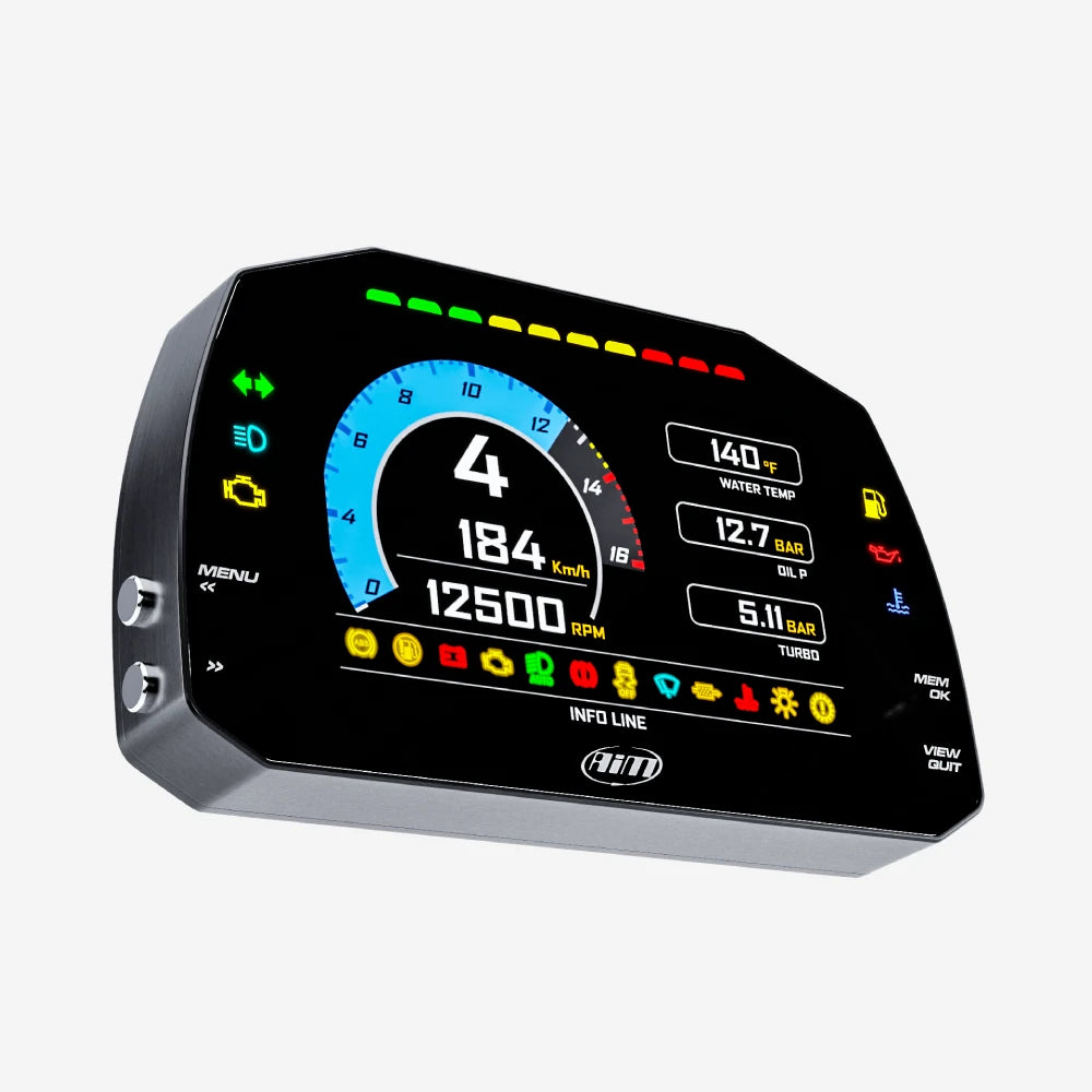

The MXS 1.3 Strada IVA-compliant dash has a 5" TFT high contrast colour display. The visual quality is optimised by the ambient light sensor, which keeps the backlight at the best brightness levels.
Pre-Configured Pages
The MXS 1.3 Strada IVA dash shows the RPM scale and all the data you need, like speed, water temperature and oil pressure, lap times and much more. You can customise pages to suit your requirements, including up to four additional fields. Define what data is shown with the end of scale and measure units. Swapping between the pages is easy; just use the push buttons.

Turn your MX Strada IVA Dash into a complete data logging system with the MX Strada Logger, Data Hub & GPS09 Module. You can also integrate an ACC3 and convert your analogue to CAN, integrating a camera and various sensors into your setup.
  • Ambient Light Sensor: Yes
  • Alarm LEDs: 6 RGB, freely configurable
  • CAN Connections: 2
  • External Modules: GPS Module, Channel Expansions, TC Hub, Lambda Controllers, SmartyCam
  • Analogue Inputs: 8 fully configurable, max 1,000Hz each
  • Digital Inputs: 1-speed input, coil RPM input
  • Digital Outputs: 1 (1A max)
  • Second CAN: Yes
  • Body: Anodised aluminium
  • Power Consumption: 400mA
  • Display: 5" TFT
  • Contrast: 600:1
  • Weight: 480g
SKU: MXS-IVA-CAN

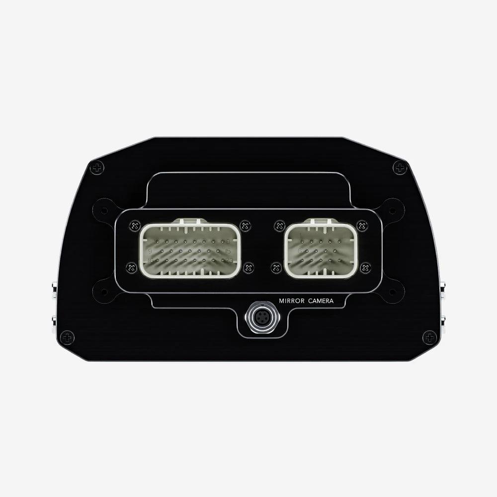

The main difference between the MXS Strada IVA-Compliant Display and the MXS Strada Display is that the IVA version has an IVA-specific second harness that comes with the display kit, providing essential road lighting indicators (turn signals, fog lights, etc.) to meet UK Individual Vehicle Approval (IVA) standards. While both have a 5" display and ECU compatibility, the IVA dash provides a plug & play solution for road-legal kit cars. For a full comparison of the MX Strada Series, take a look at the comparison tab.
